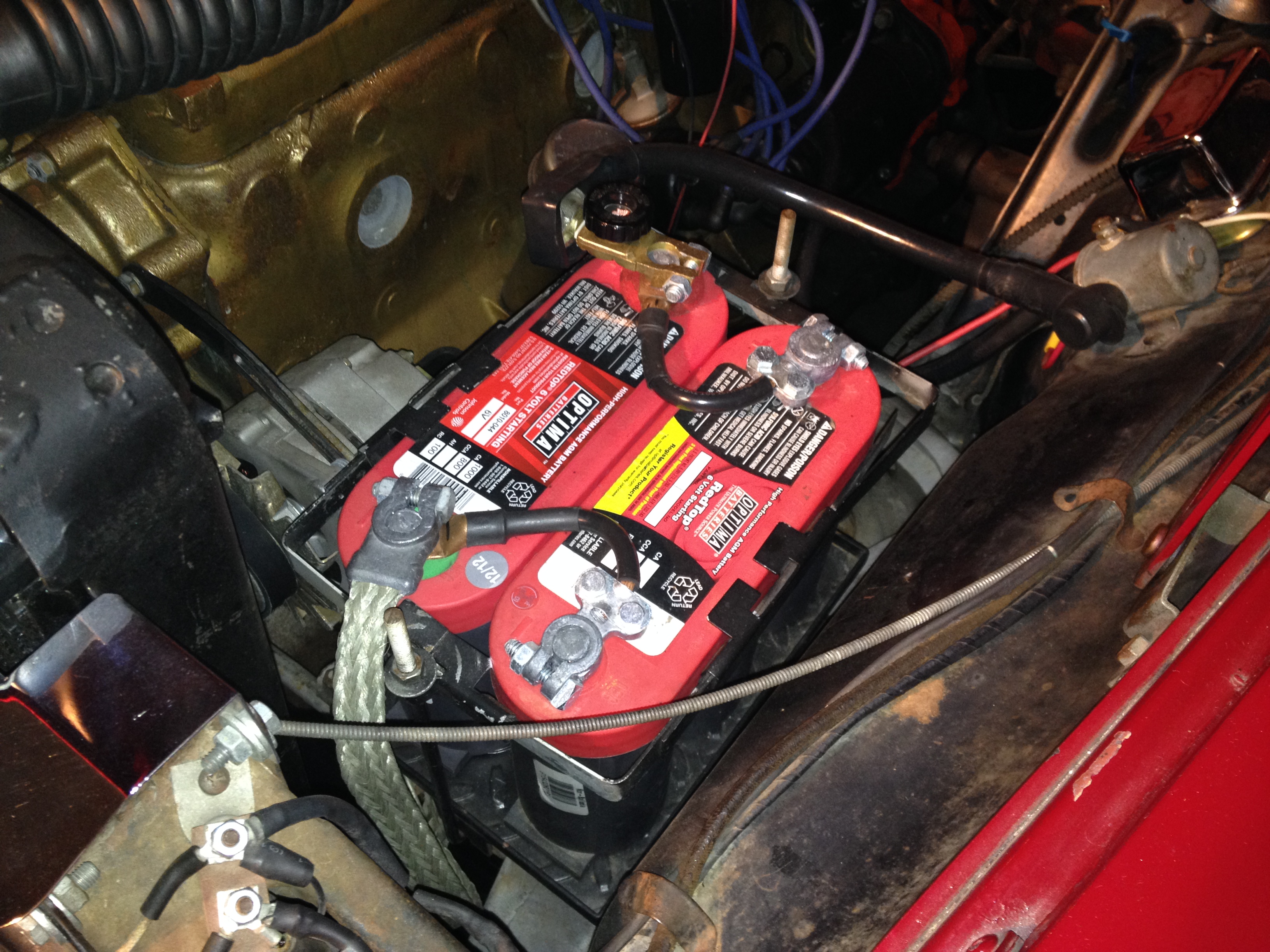

I have a 1951 hornet with a 308 engine and it does have the steel frame on the left side but I am not sure if a tray sits on top of that or not. I have been waiting forever to see another one to take pictures of and go to a lot of car shows but can't find another hudson0

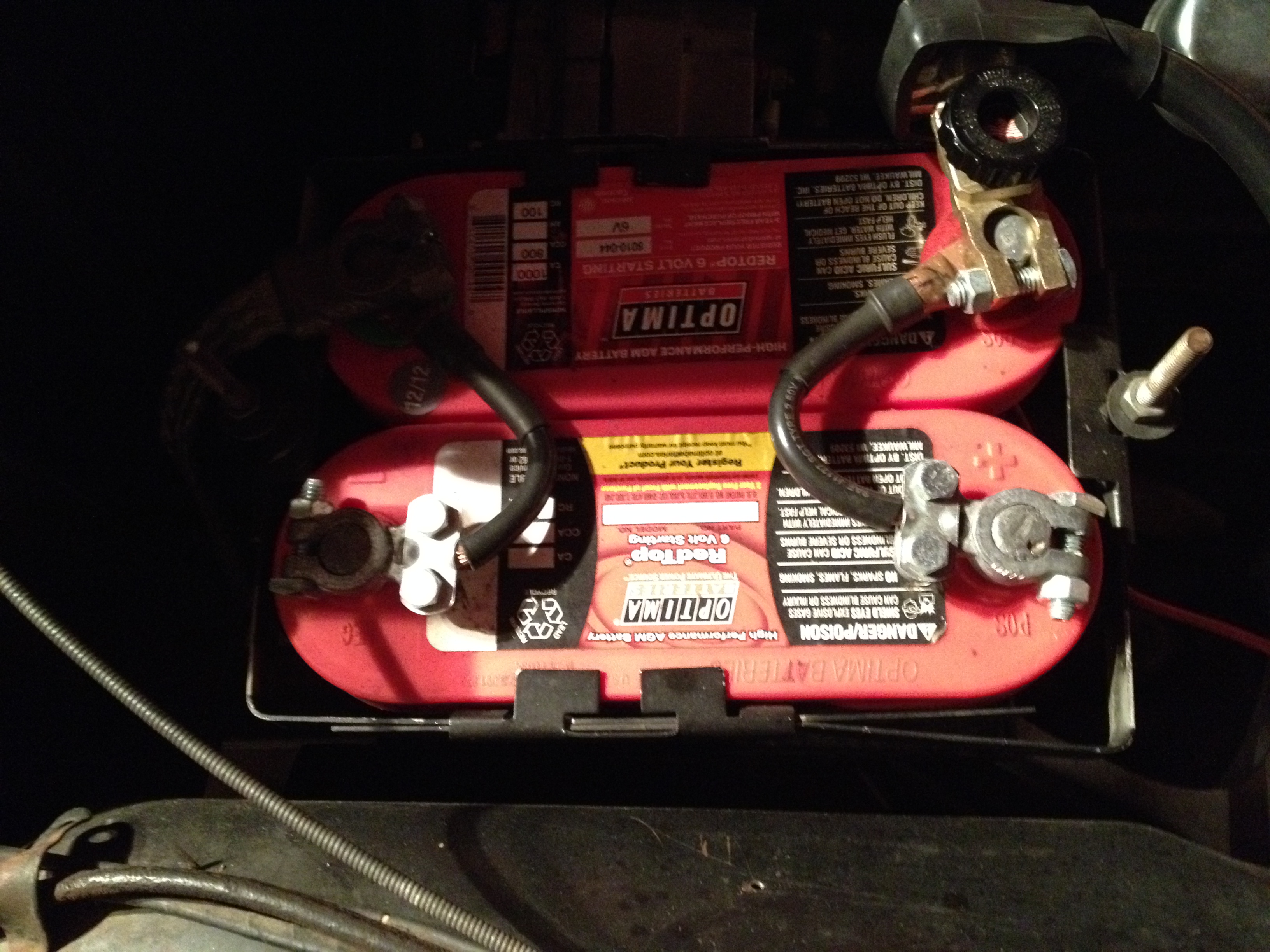

Yes the steel frame does fit on top. If you don't have one go to a machine shop, make sure you measure the outside of the battery you want and have them make a tray for you. Thats what I had to do. Enclosed pics should be self explanatory..

Grandpa is of course showing you two Optima batteries side by side, but the hold-down he shows is similar to those for the standard old-style lead-acid batteries. You are going to be looking for something like this:

The holder that you see is a holder that compacts or extends to fit the size of the battery you are using.
Been so long ago either got it from NAPA or O'Reilly's. Guess it would be called universal.. But the plate came from a machine shop to the tune of $120.00.0
