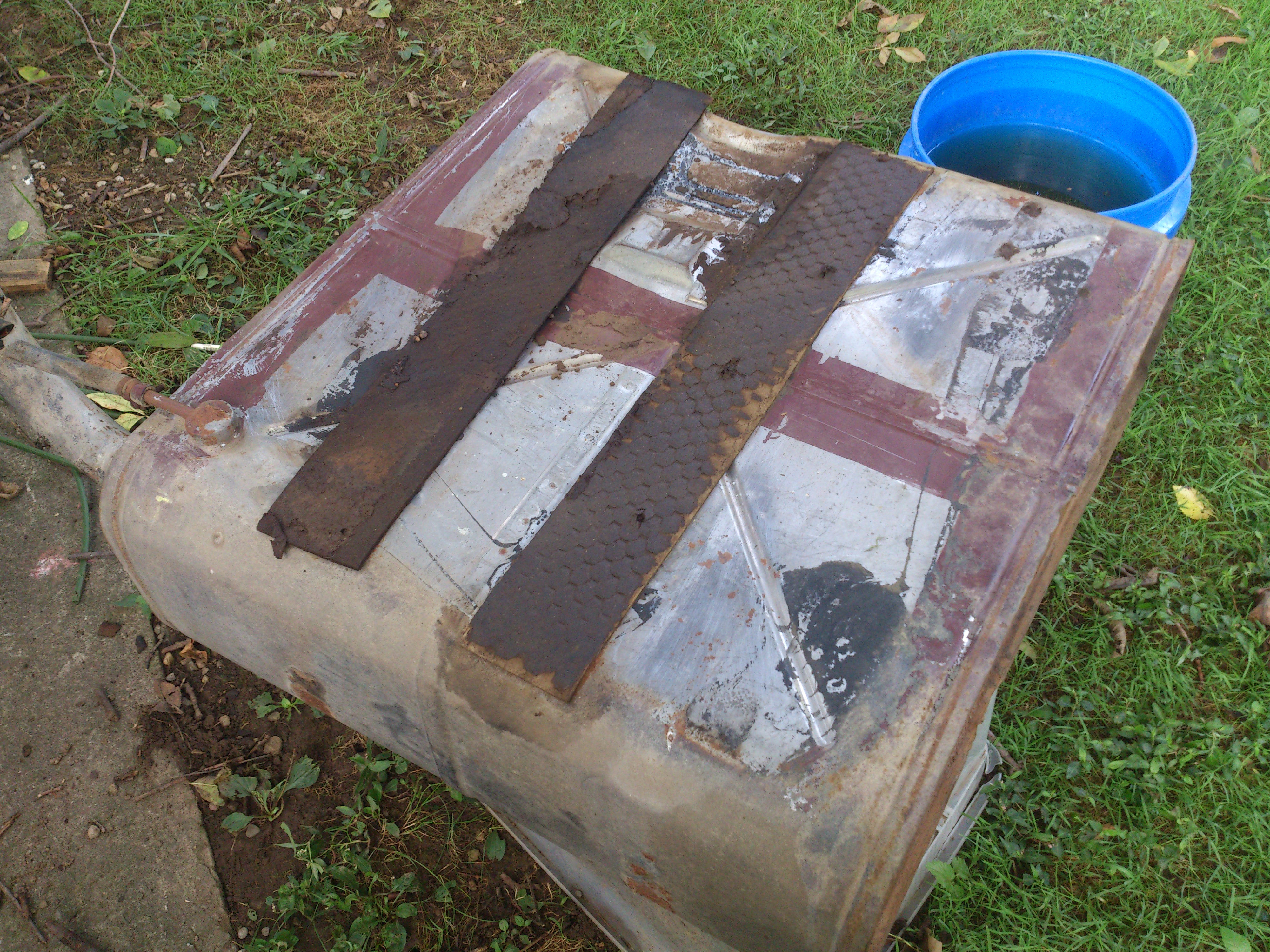

Hello all I dropped the tank out of my '51 Hornet sedan after draining the 3 gallons of varnish that were its contents. After getting it freed of the straps the tank had quite a few rocks in it. I wish I were kidding.... rocks! And large ones at that. I removed the fuel sending unit and was able to get almost all of the rocks out, but there was one thing in the tank that baffled me. In the tank wedged under the center baffle seemed to be what looked like a small funnel? Is this part of fuel pick up system? Is it just more trash in the tank along with a bunch of sand and all? I can't find a schematic of the gas tank interior systems..... so I go the experts. Thanks!

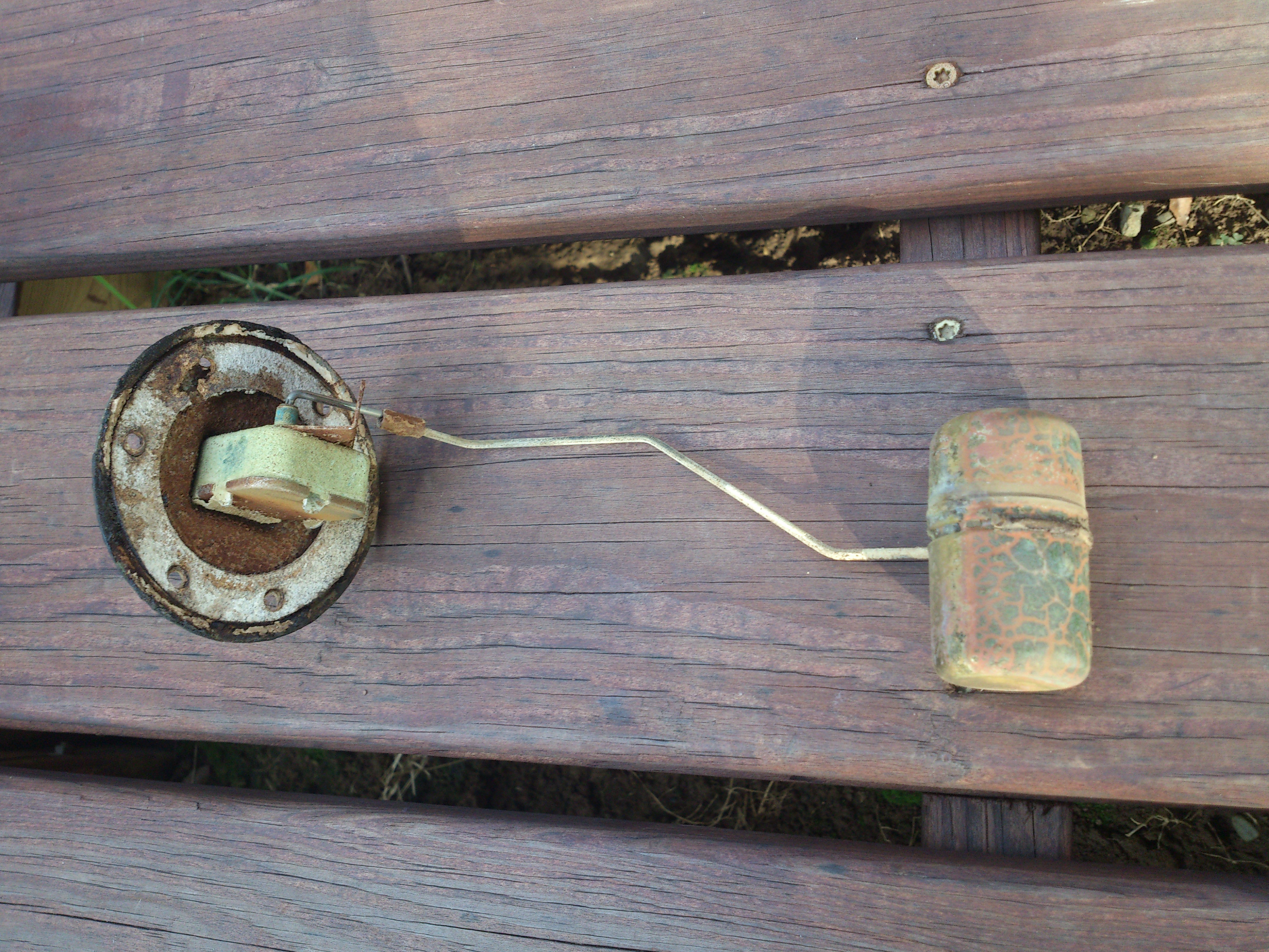

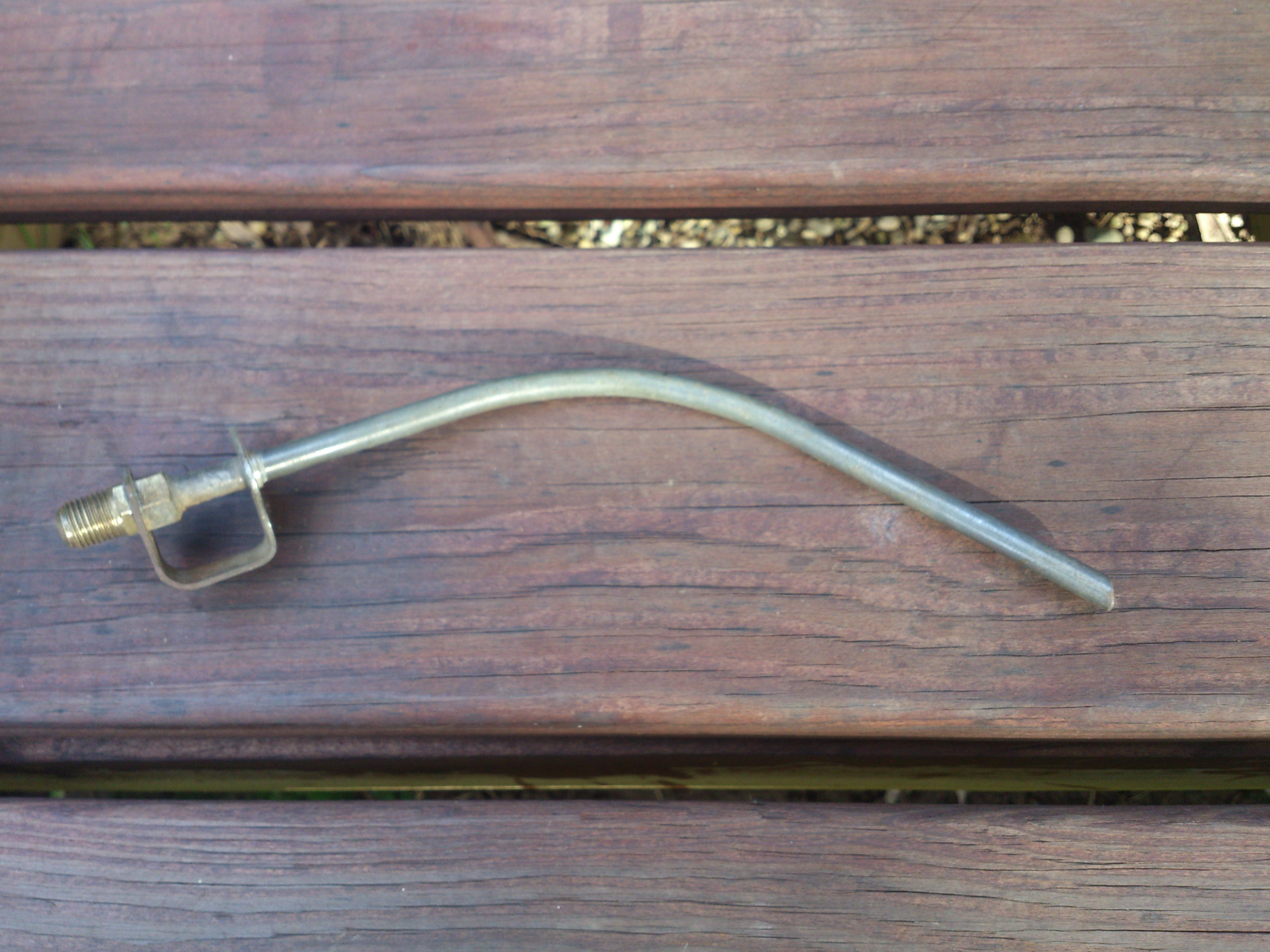

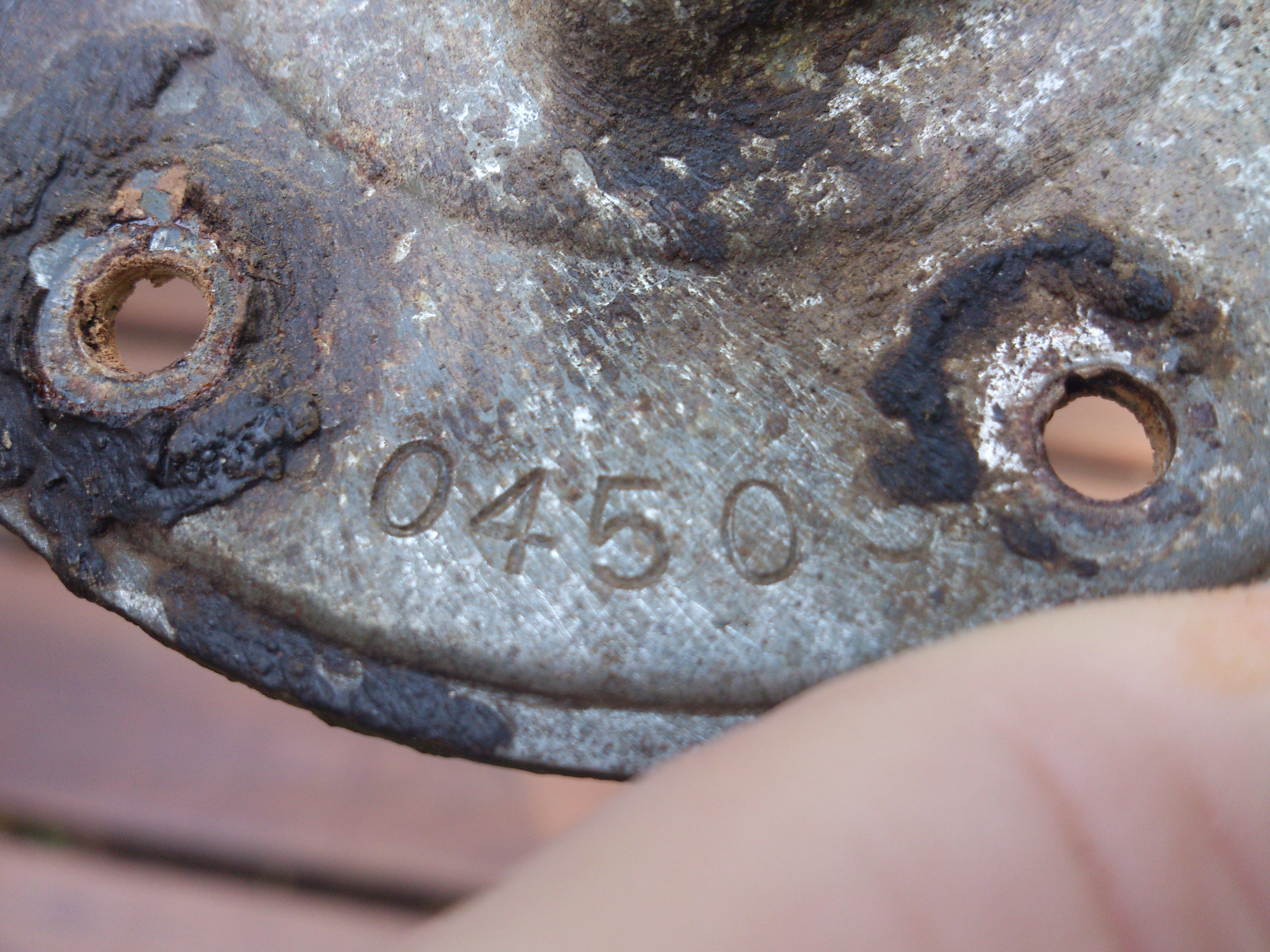

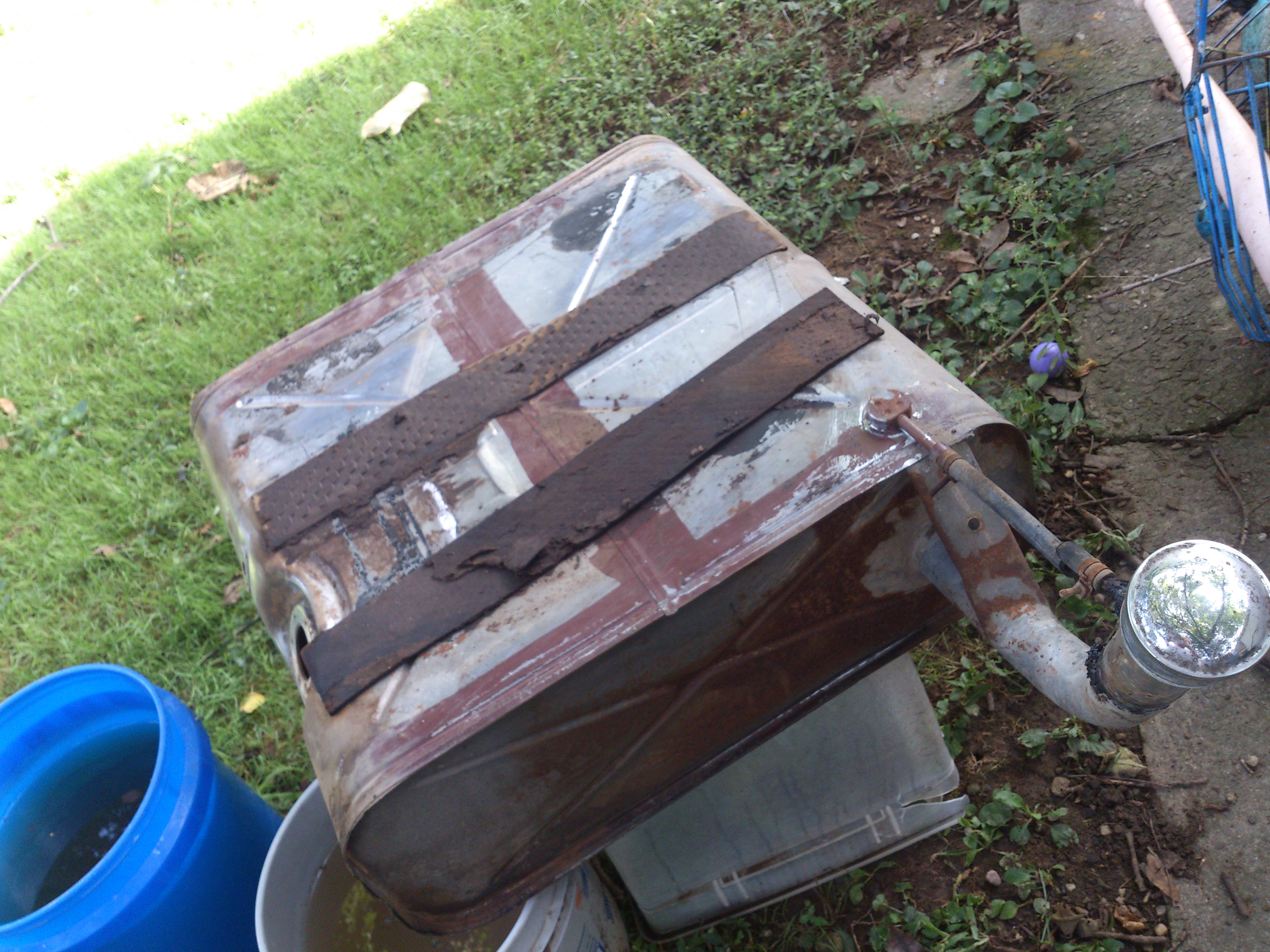

Thanks again for all your insights.Doc, I might be able to shed some light on your question. My tank is not painted on its top but was on the sides and bottom.Ol Racer, thank you for your offer but I will pass for right now.Here are some picture of the tank, the fuel sending unit (which needs a good cleaning but works), and the fuel pick up tube. Is the funnel fuel filter thingy a necessary part or will it all work without it?Do the Eastwood and other products like por-15 do a good job of etching off, or converting the rust scale in the tank?Thanks again everyone.-Ray

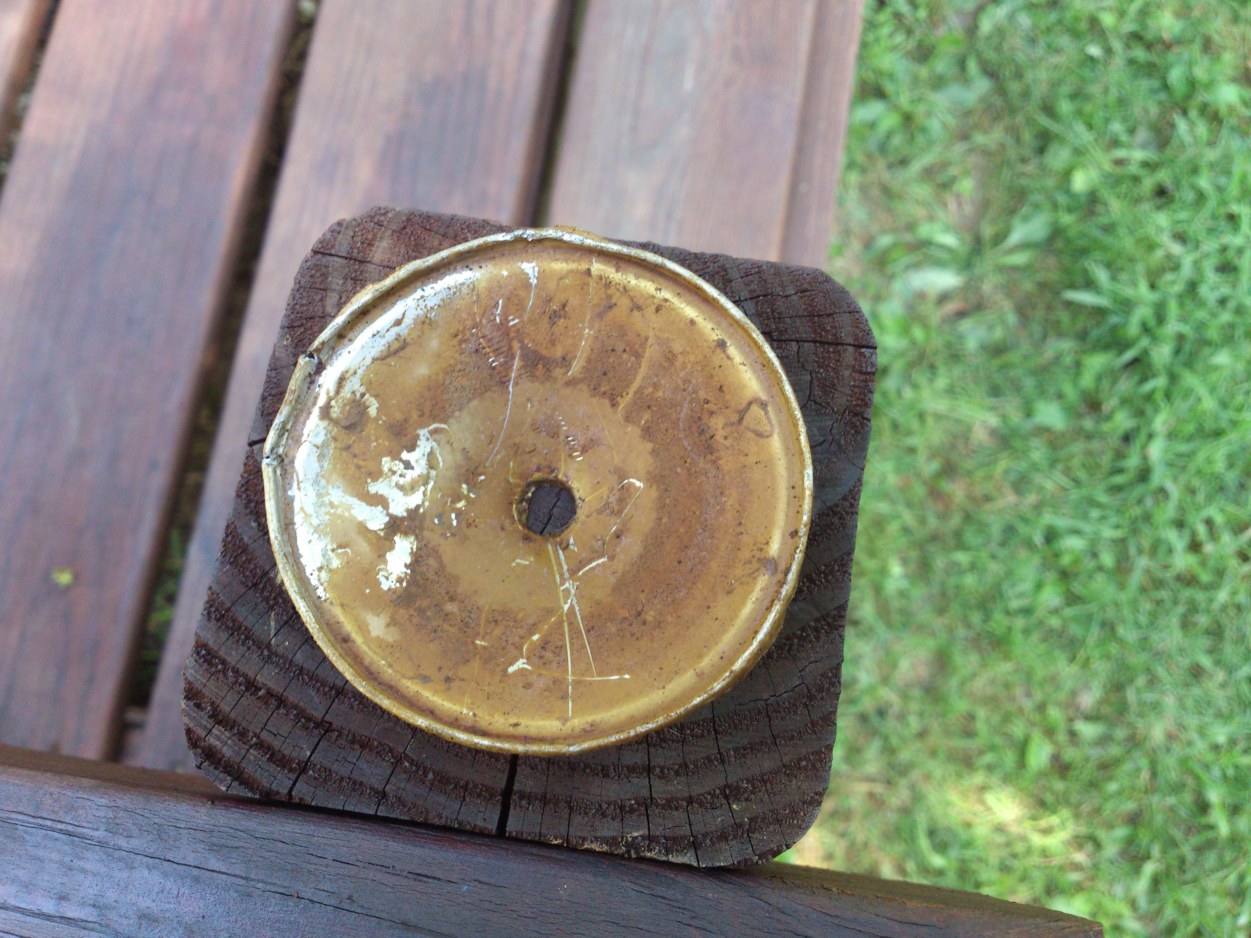

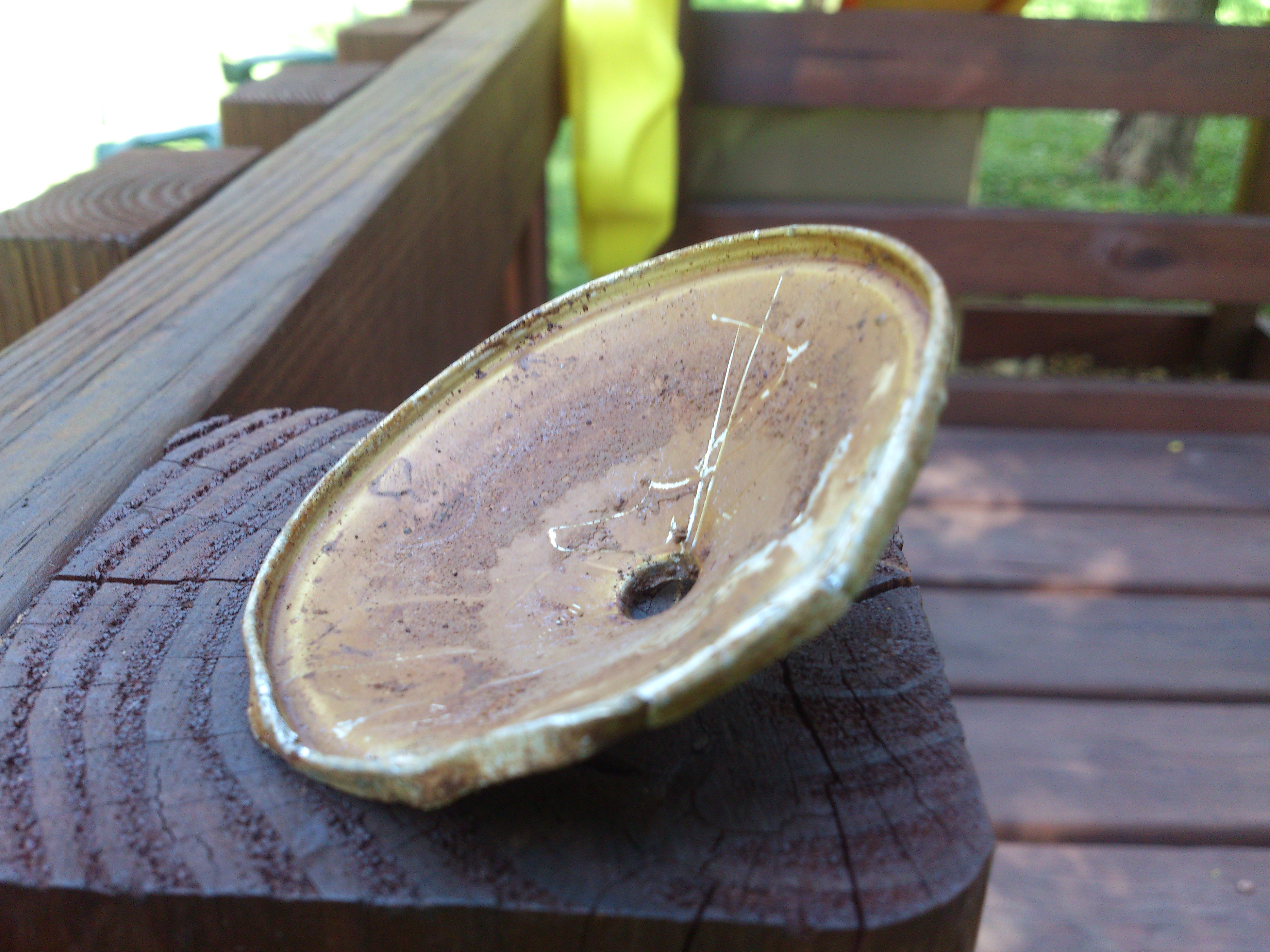

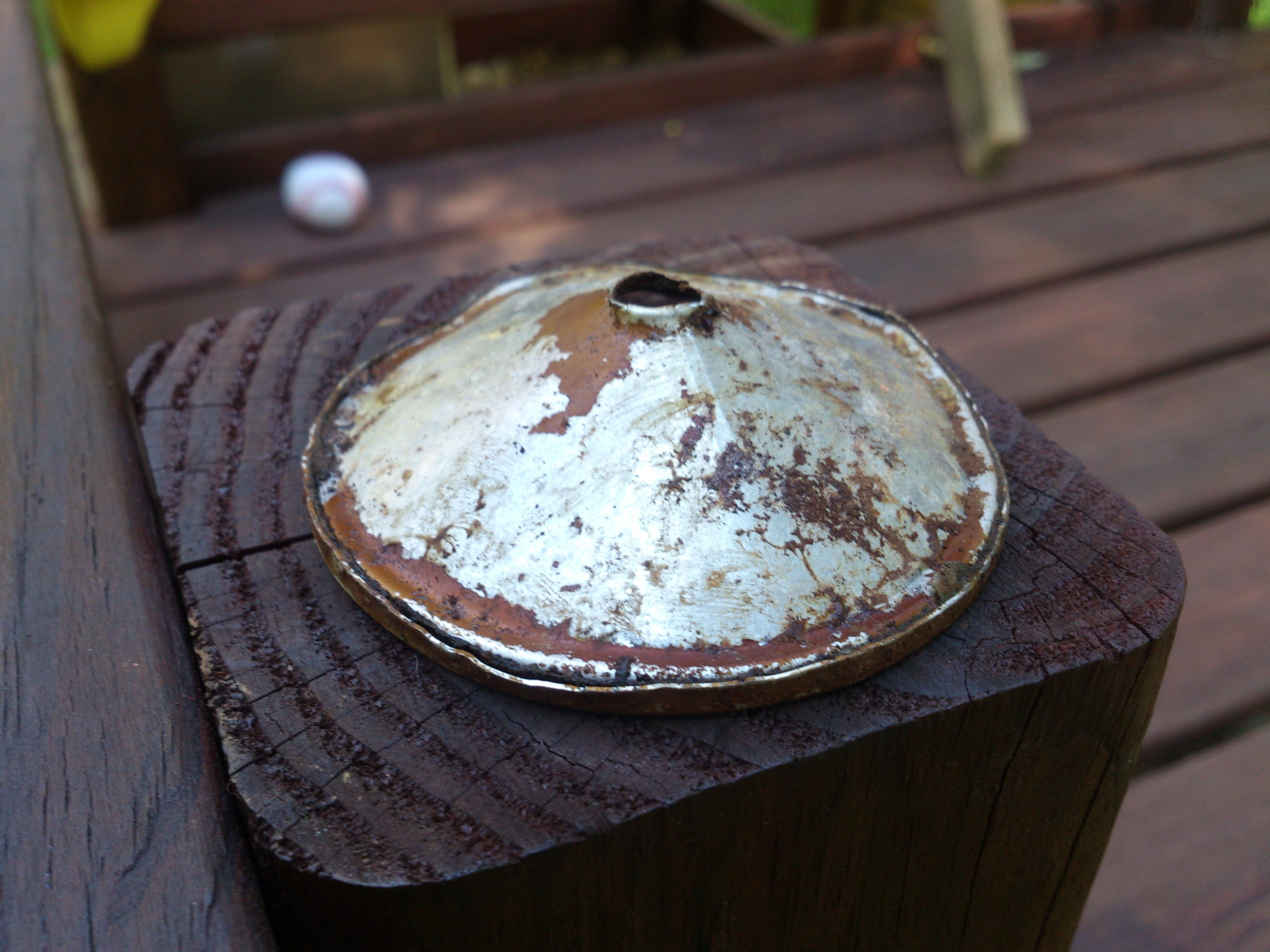

Here is the piece that there was speculation about being a some sort of filter. I was just able to get it out. It is made of aluminum and is put on a 4x4 for reference of size. Along with this piece... I also just pulled a 5 inch piece of cow rib out of the tank so there's no telling what it is. Again it was in the tank of a 51 Hornet.-Ray
" . . . a 5" piece of cowrib out of the tank." OMG!! It never ceases to amaze me what one will find in the darnedest places!As far as the sending unit goes, PAULLARGETYPE here on the forum sells replacement units. Well worth just installing a new one.If you need better contact info, send me an email.0

1. Will the pick up tube still work fine without whatever that funnel/filter thing was?

The filter thing is a "sock" and probably, if not deteriorated by now, was pushed out by some former owner. The pickup will work fine as lone as there is no pinhole leak, Test it like a straw, place a finger over the end, and suck on it, obviously after cleaning. Yes on the fuel filter. Preferably a clear one so that you can spot trouble before it affects performance. I added a Airtex E-8011(6v) fuel pump with a clear filter back by the gas tank. If you do not know when the Mechanical pump was rebuilt, I would have it rebuilt. Had good luck from Then & Now(Auto Parts Cellar). The fuels today have plenty of "solvents" in 'em already. I advise using Stabil to preserve fuel, since shelf life is but a few months. Marvel won't hurt either. Ron0
Mine came to me with nothing on the pickup and have never had an issue. I too have an electric booster pump near the rear axle and a plastic inline filter between the tank and pump.

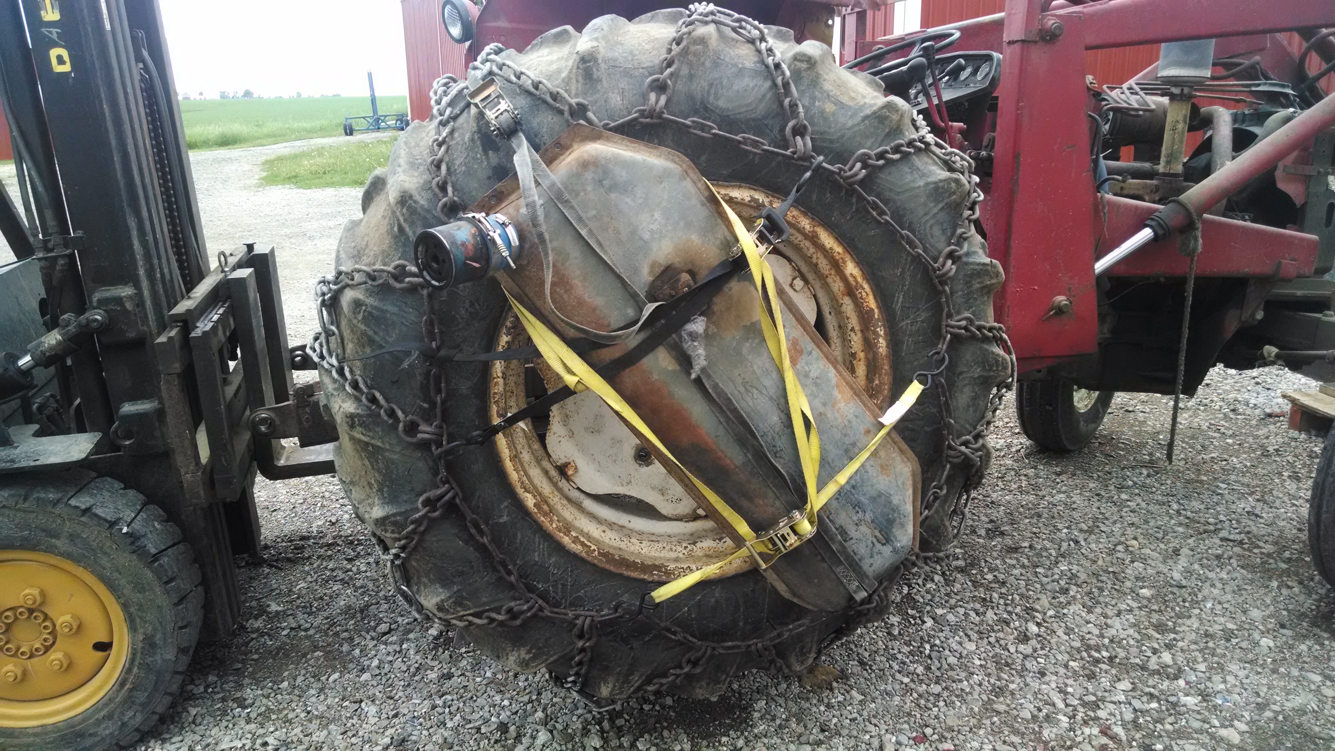

We just finished our fuel tank cleaning.
6 gallons white vinegar (it eats rust)
3 lb coffee can of broken car door glass (the small 1/4" size pieces)
Put contents in the tank and seal it. Let sit on each side fro about 12 hrs.
Strap tank to the side of a tractor tire, have the tractor supported on jack stands to be able to spin the tires in a lower gear. It takes at least 3 straps.
Rotate it for about 1 hr each direction. The glass will scrub it clean.
Rinse with water, let it dry and coat the inside with a epoxy tank sealer. Cost for sealer on ebay about 50 delivered.0 -

Tom...Wow...Now I am sourcing a tractor (have two friends who have them) and am thinking an autoglass place would be a good place to source broken glass (I'm brilliant... I know. lol) but this sounds like a great method to get everything clean without someone cutting it open and doing goodness knows what. Also auto glass is a seems like a good medium choice because it is hard, but small enough to fit under the baffle. This will definitely be a fall/winter project... but will keep you all updated what we do!- Ray0
