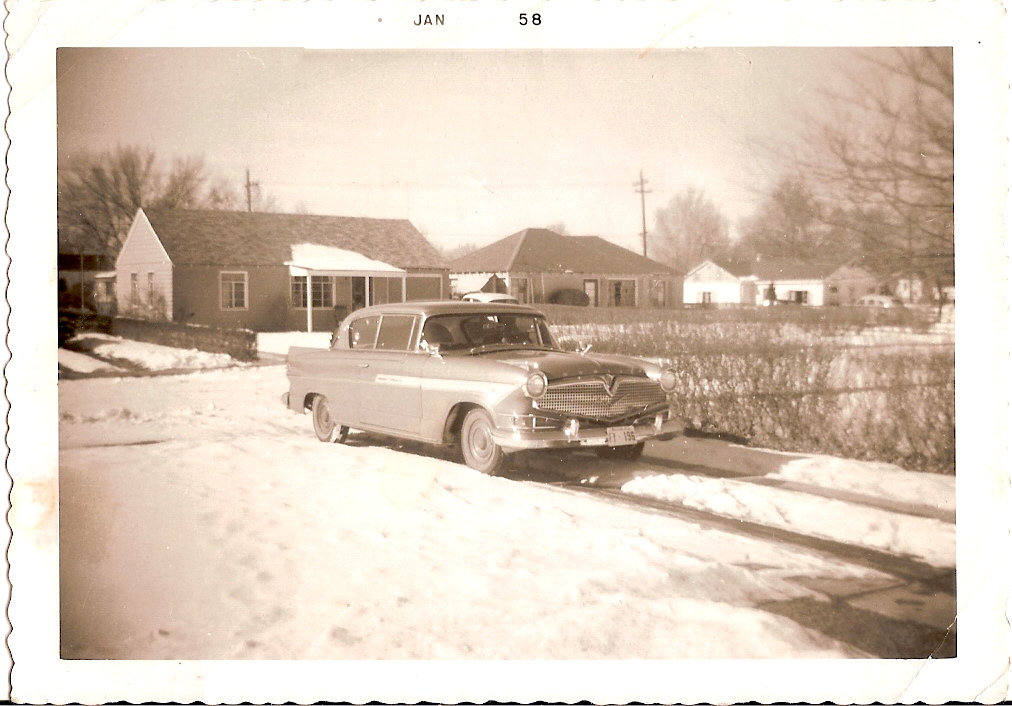

Hmmm: I am sure that the 57 Hornet did not come with mirrors. I think my dealer installed them when I purchased the car and received it. No belts for sure, but great reclining seats, and not for just sleeping!!!0
