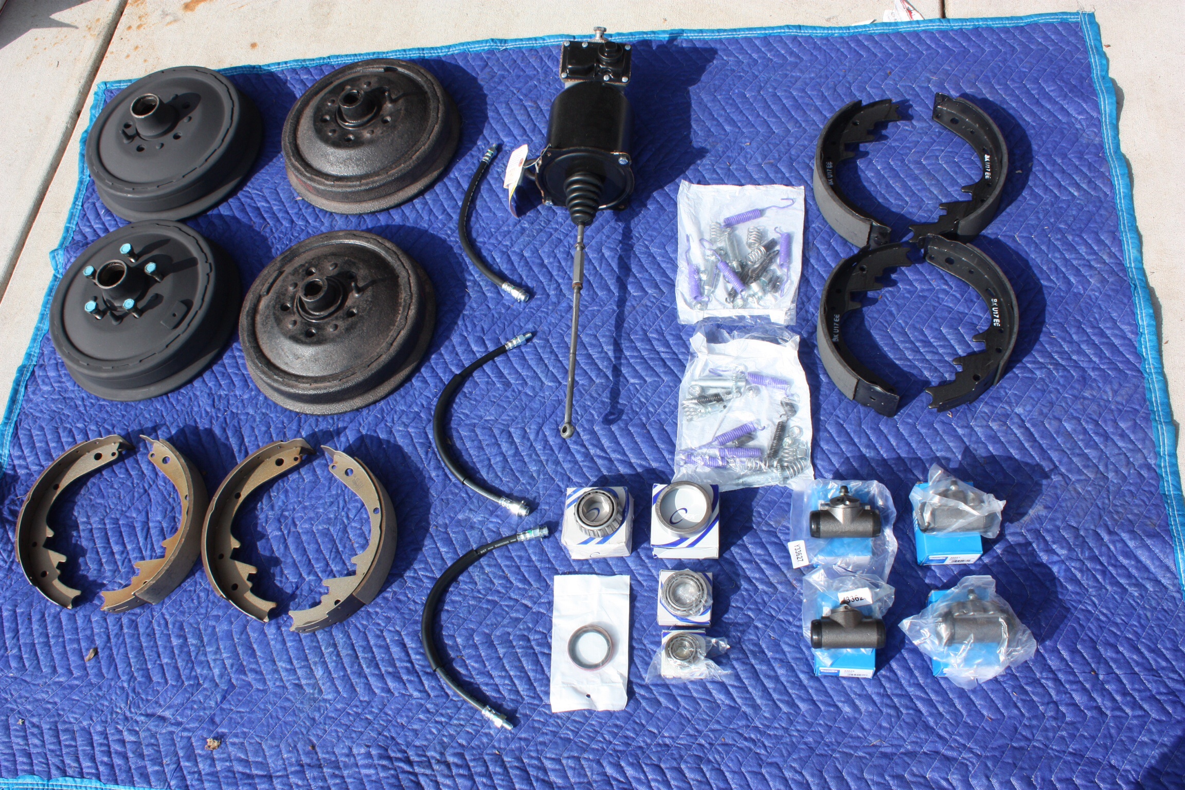

Besides a bleeder tool, anyone wanna guess what I am missing to finally get brakes on my 57' Hornet? (I keep seeing a brake bleeder tool online. Is this necessary or can I bleed the brakes another way?)

I NEVER USE A BLEEDER TOOL JUST SOME ONE TO PUMP THE BRAKE PEDALYOUR MISSING REAR WHEEL SEALS THEY GO BETWEEN THE AXEL BEARINGS AND THE BRAKE SHOES AND A NEW BRAKE LIGHT SENDING UNIT0
Thanks, Paul. You are absolutely correct. I ordered all missing parts last evening after I realized my oversight. I will email you directly about the brake light sending unit. Thanks again.0

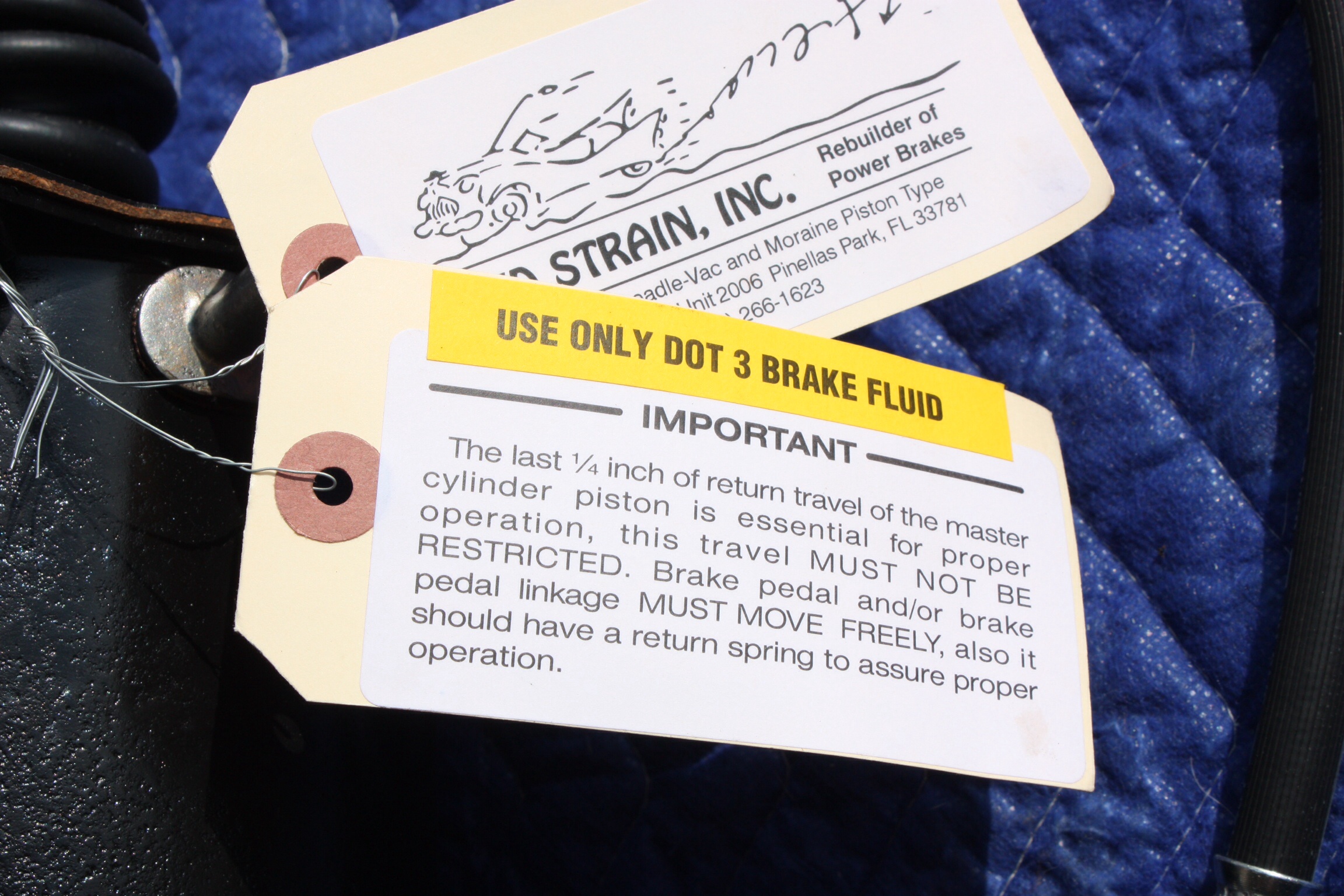

I have not had good luck with the silicone fluid. It killed the brake light switch on my 53, twice. I find Dot 3 fluid works just fine. No rubber issues.
Jay
You guys never cease to amaze me. Paul Schuster gave me a call earlier today and your message is nearly word for word what he said. I was writing notes as fast as I could. Paul highly recommended the DOT 5 synthetic but also warned that the old brake switches would eventually fail due to the silicone. There are newer brake light switches apparently designed by Harley Davidson that seem to hold up to the newer synthetic fluids. I would have used the DOT 3 as recommended by the card attached to the rebuilt master/booster when it was returned (see pic). Can't thank you enough for all the tips! I really enjoy the learning process and sincerely appreciate all of the teachers on this discussion board more than willing to help. Hats off!0
Been using the HD switches for nearly a decade in my Hudsons with no problems whatsoever.0
