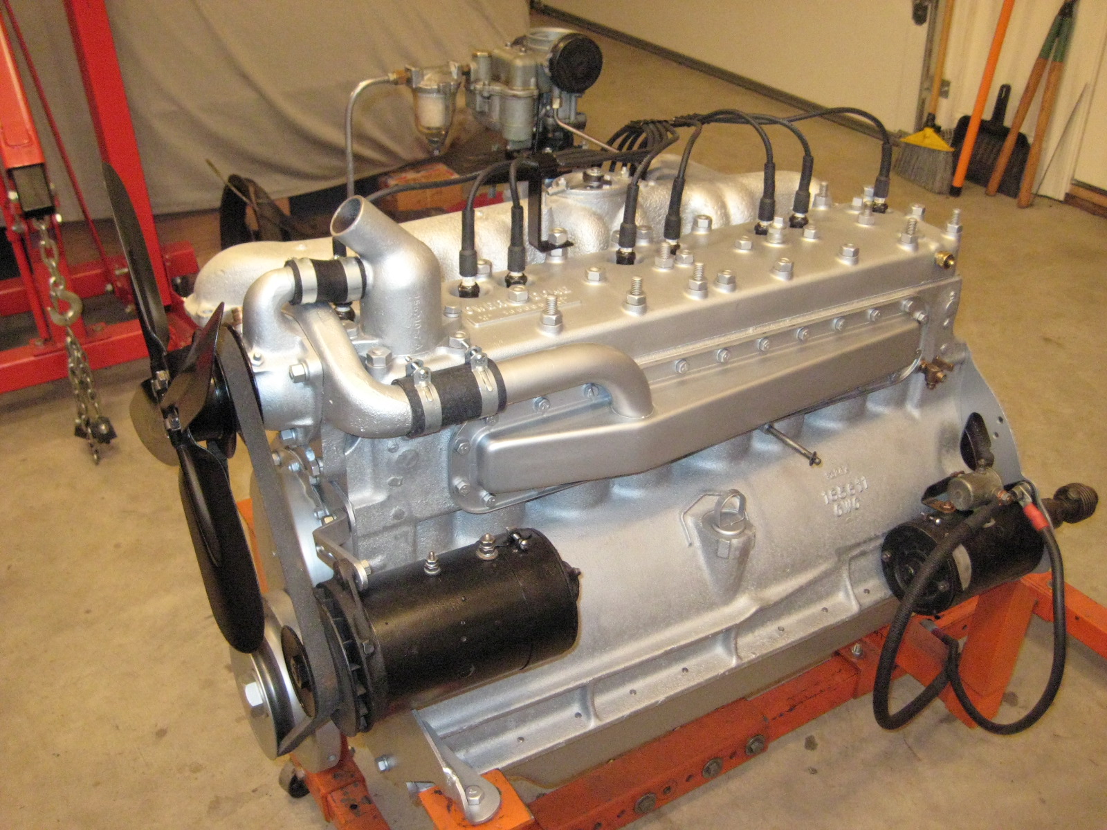

I have an aluminum head on my 8 and it has been there since did the reassembly in 2005. I had the head check for flatness and as Ol racer notes, shaved a few thou to get it there. I had all of the spark plug holes redone with stainless steel inserts. Not had any problems and it weighs about 1/3rd that of a cast iron head.0
And if you're going to have the engine look as original, the head is painted aluminum like the rest of the engine anyway!0

Like I said never had an 8 but notice from Park's Picture that they already have 'Studs' which is even better securement for an aluminum Head. I would still coat the Stud shanks with Permatex or never-seeze. Its rare these days to find an 8 cyl Head.
