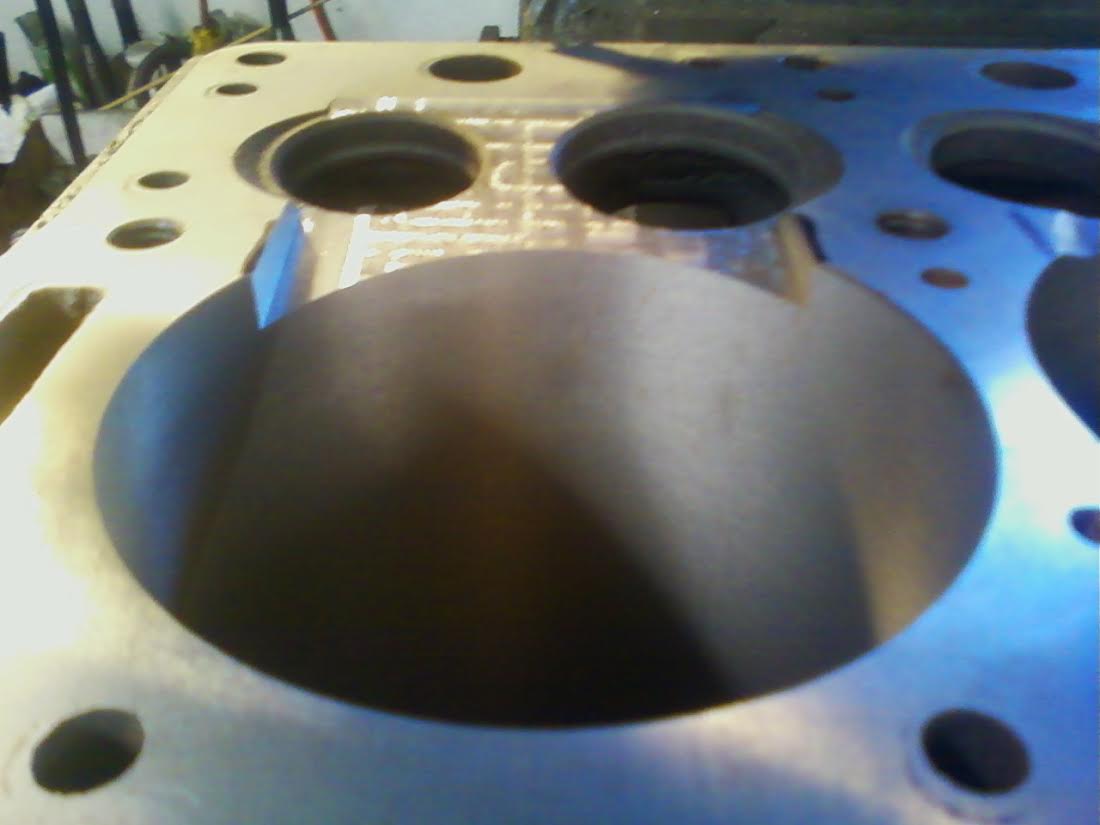

1. Does anybody have a photo showing the 7X relief between the valves? Not sure if I want to do it but I would like to see what it is all about.

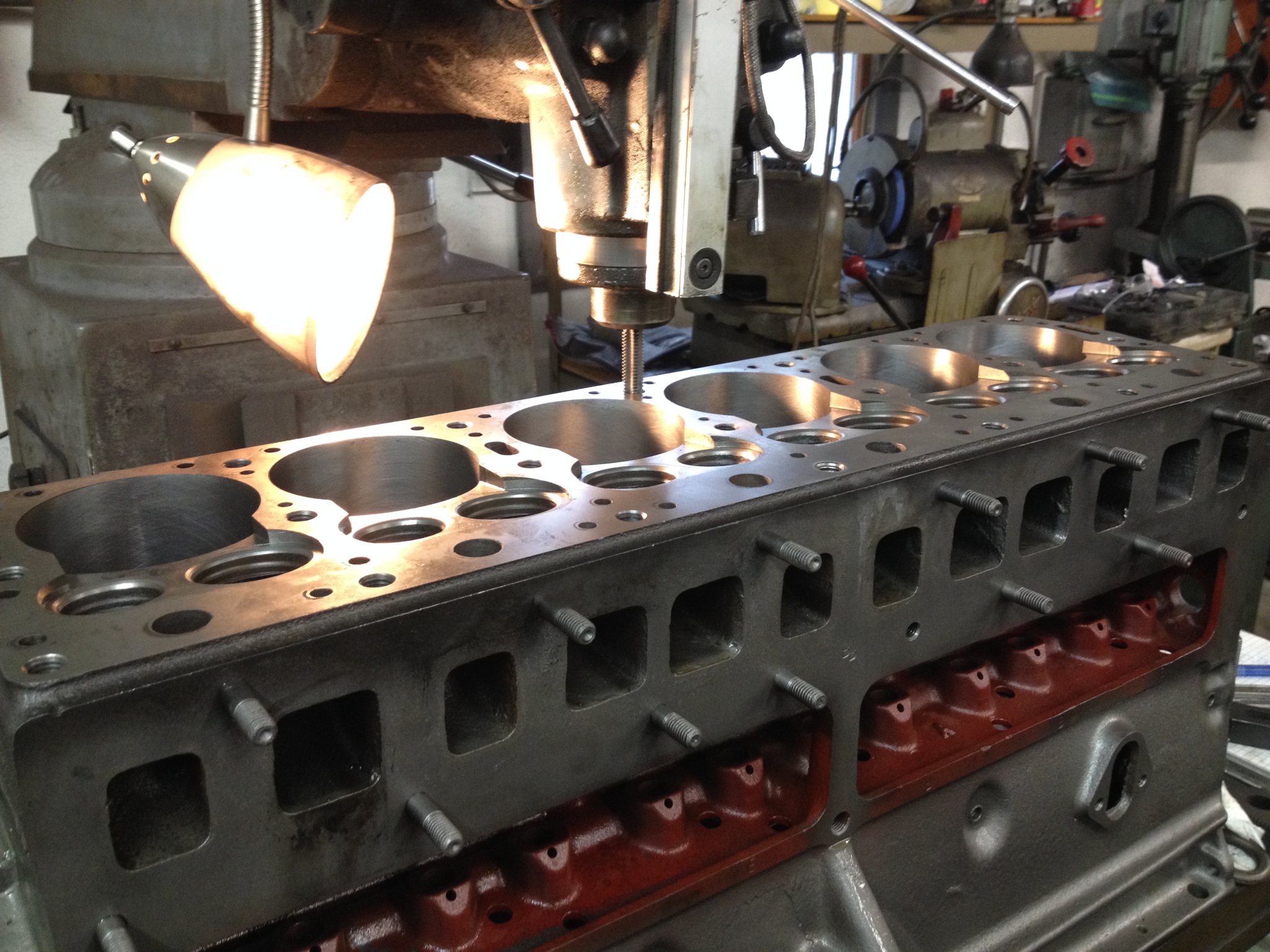

This is a photo of an ongoing relief on a block we are doing and hope to complete the assembly in next 10 days. Steve did the relief. I finished tapping for 1/2 inch bolts today.
Randy

Randy, above, demonstrates the right way to move up to 1/2 inch bolts
Dave0 -
