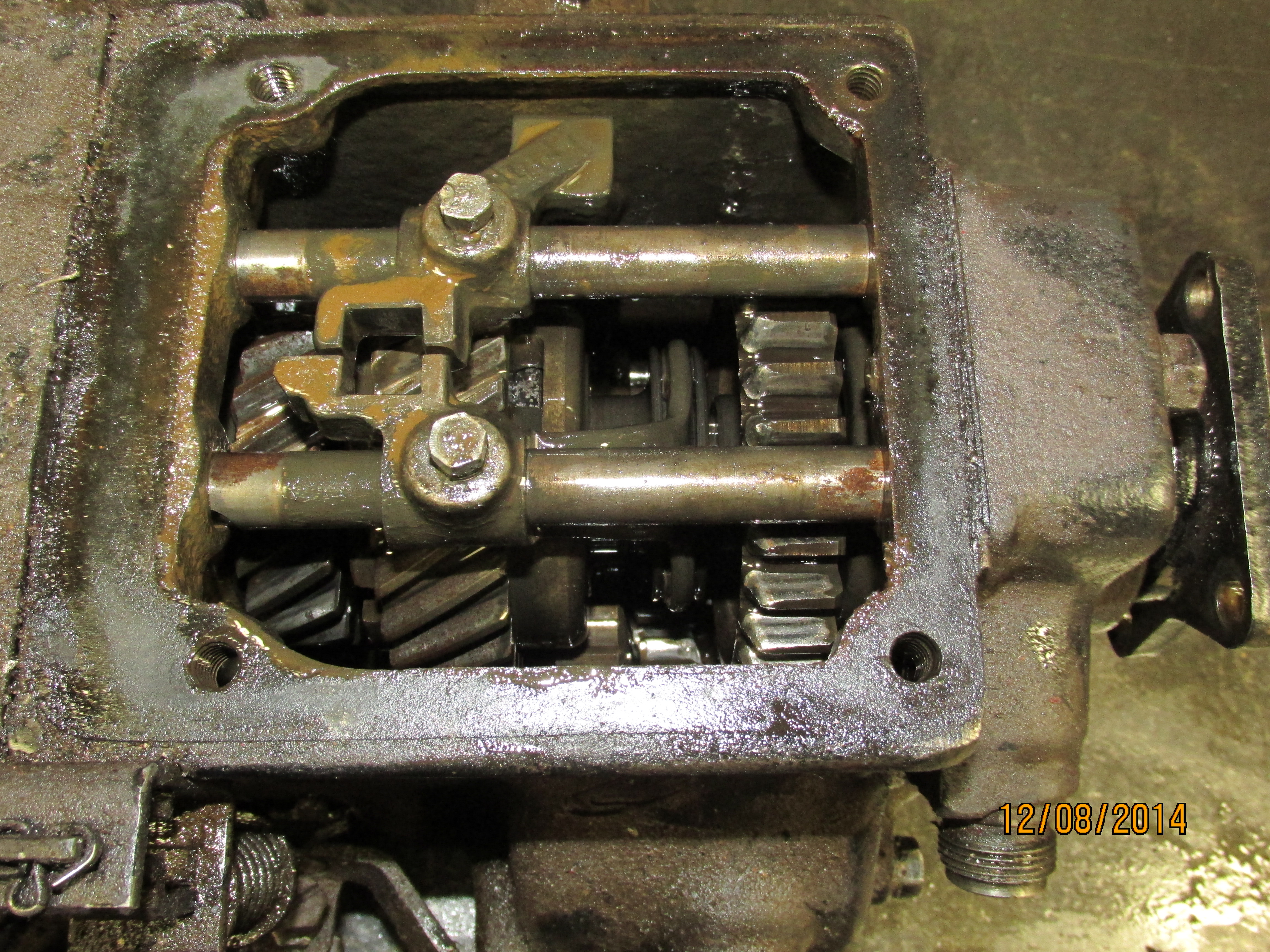

My 35 Terraplane has had transmission noise since I bought it last spring. I switched oil to Royal Purple which helped for awhile but I noticed that I was getting some brass colored metal flakes in the oil. This fall it started to jump out of second gear under load. I decided to pull the transmission this winter to see what was going on. I am glad I did, the input shaft has a bunch of play in it and the 1st gear has wear (see photo 918)

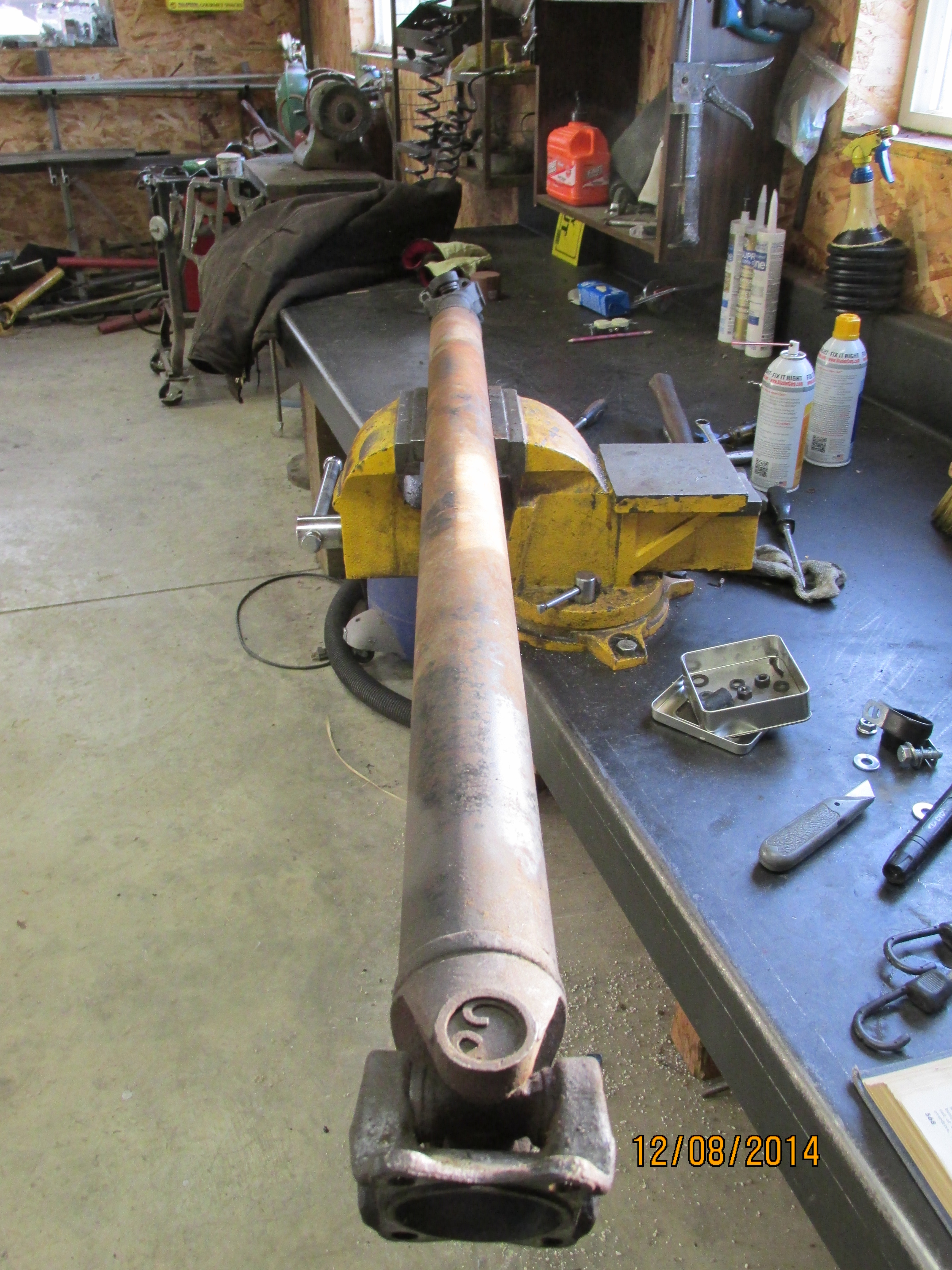

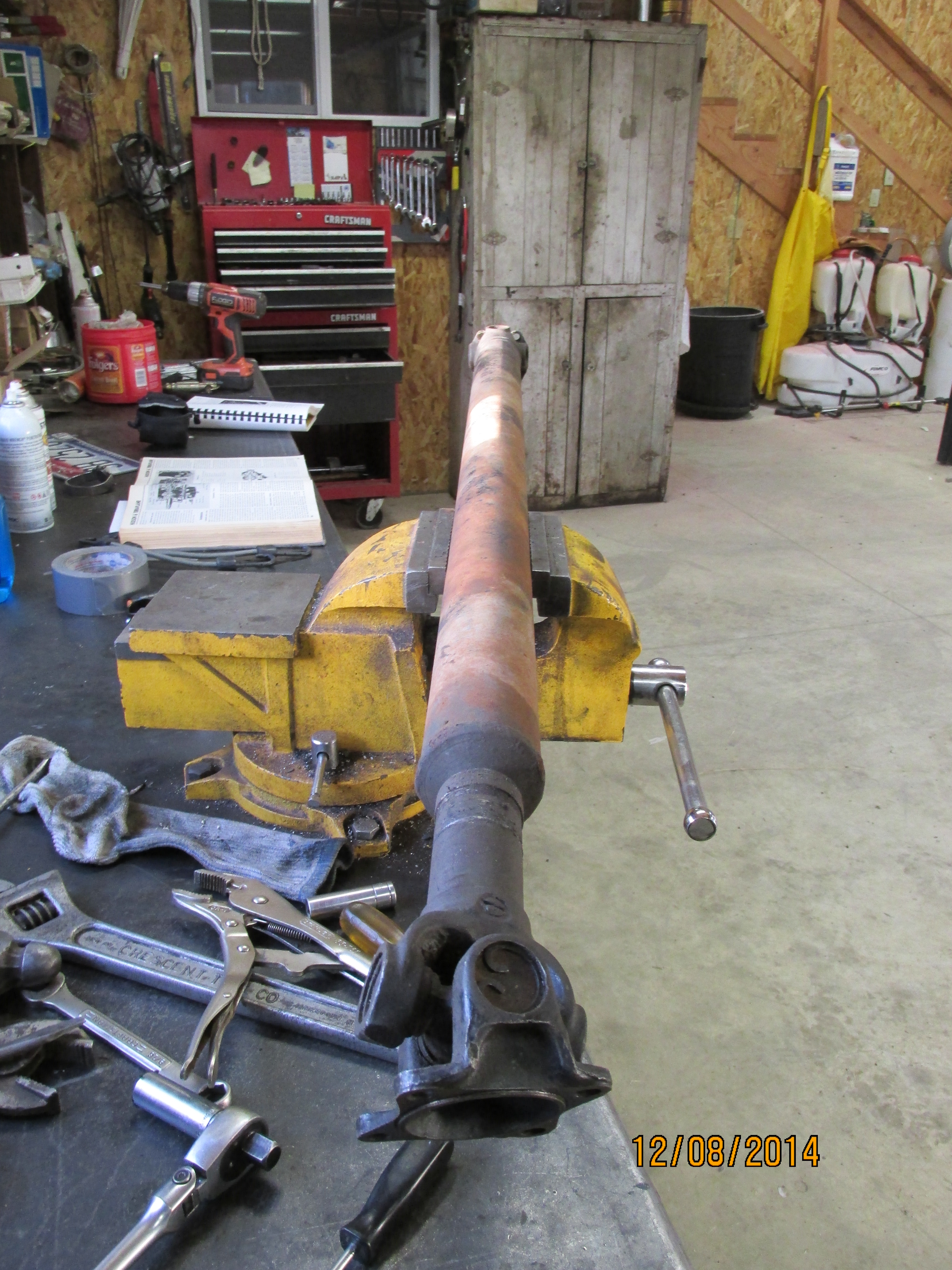

While under the car I removed the driveline (propeller shaft) and found what might be a cause of some of the issues. The U joints were not timed or indexed correctly. See photos 916 and 917. Whoever worked on the car missed a couple splines when they put it back together. According to my manuals there is an arrow on the yoke and a line punched on the splines to show were it should be assembled but I could only find the arrow. As long as I index the joints like a current driveline will that work? I cannot imagine Hudson doing it any other way but I thought I should ask you folks to make sure.
