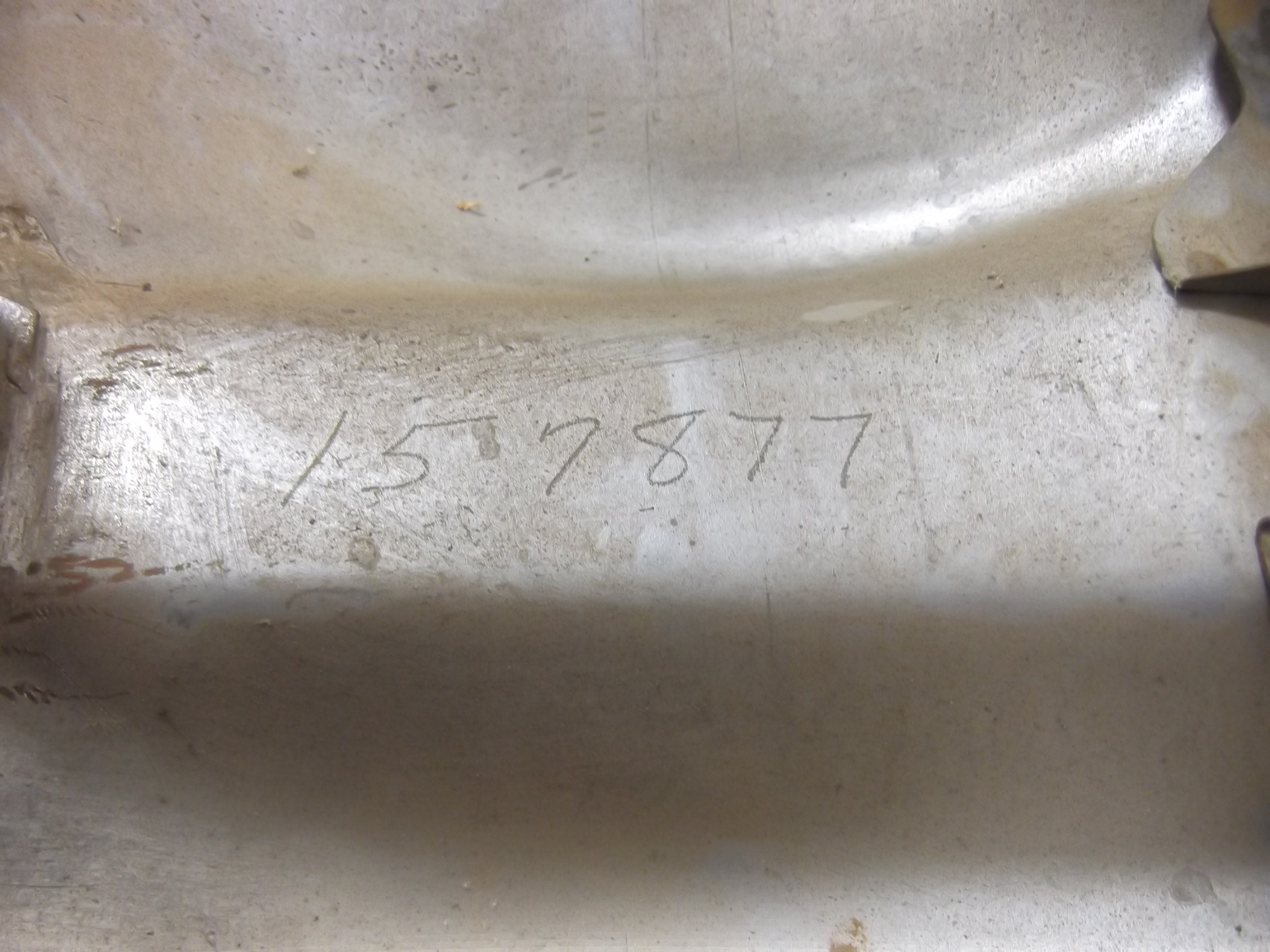

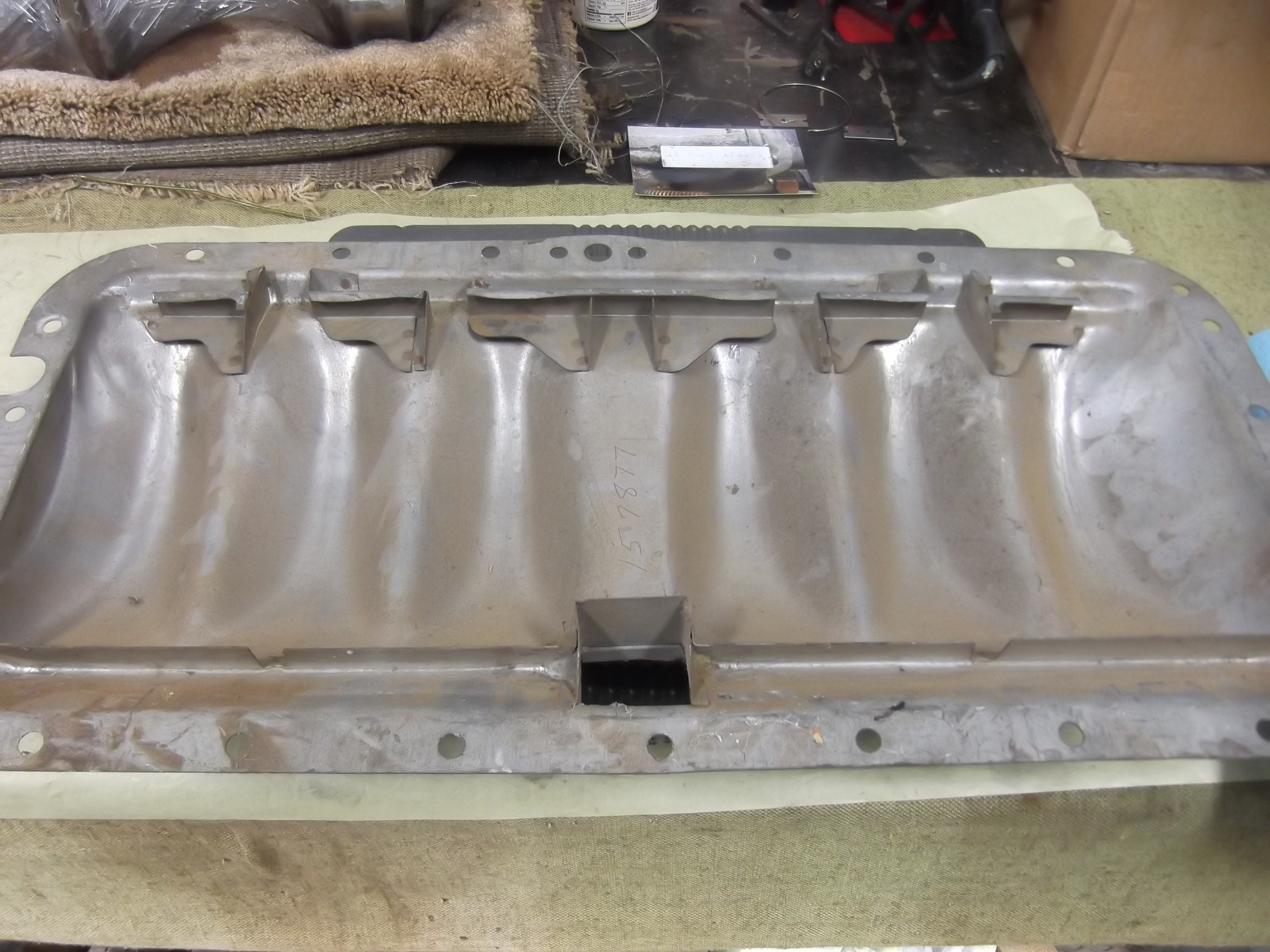

I have two of these and can't seem to pull up a number for their application.
They are for 6 cylinder, anyone know the application ?
Thanks!
Thanks!
Kerry, That number is for the 175 cu. engine, 38-42. This info from 1950 interchance parts book.
"Ric"
Thanks Rick, I just looked at the number on the on-line manuals Alex posted. Wonder what the difference is between the 175 and 212 oil pans? Depth of the oil troughs for the rods to "dip" the oil?
Looks like the oil pan itself (156641) fits models 40,41,43,48 so the pan is the same but the oil dipper pan is different.
The trays are higher up relative to the crankcase base, as the 175 motor has 7/8" shorter stroke than the 212.0
