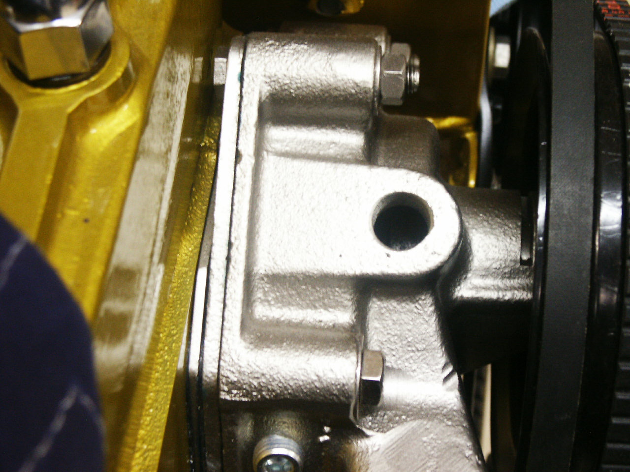

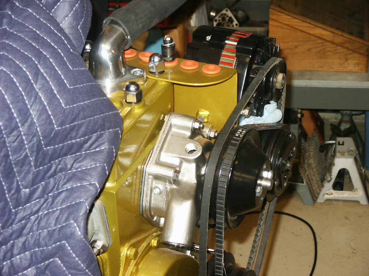

dang dang dang! I got the pump and when I got it it had a shorter shaft so no need to press it down. the shaft is shorter so it can't be pulled out with a puller. I thought no problem I had a spair 308 with a shallower pulley and it lines up with everything. I even got the old pump off everything cleaned up and the new pump installed. then I go to put the fan on and notice it will bump the harmonic balancer!!!!!!!!!
I don't know about trimming the fan blades. I think I may make a 1/2" spacer out of aluminum to go between the pulley and the fan.
Dale Cooper did the pump for my 55 308. Never could figure out if my water pump pulley was Hudson because it had no markings. Mine has 2 plates behind the pump were I'd guess everybody else has one? Anyway, the top bolt on the pump would be stuck in the Clifford head without that extra .090". Of the two fans I had that steeper pitched one will require a fan spacer too. Store bought/swap meet fan spacers are easy enough to come by. It's always something...
