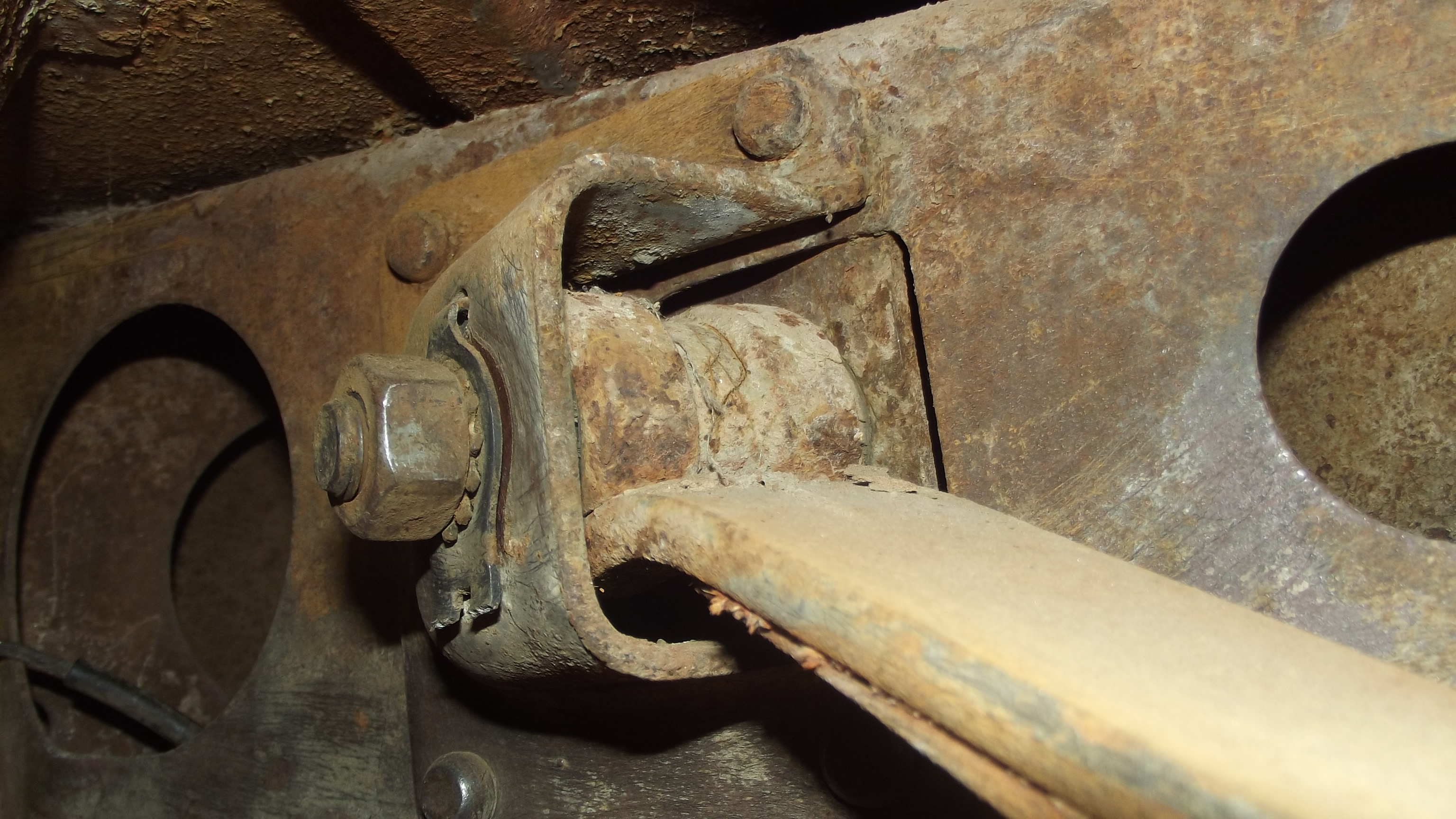

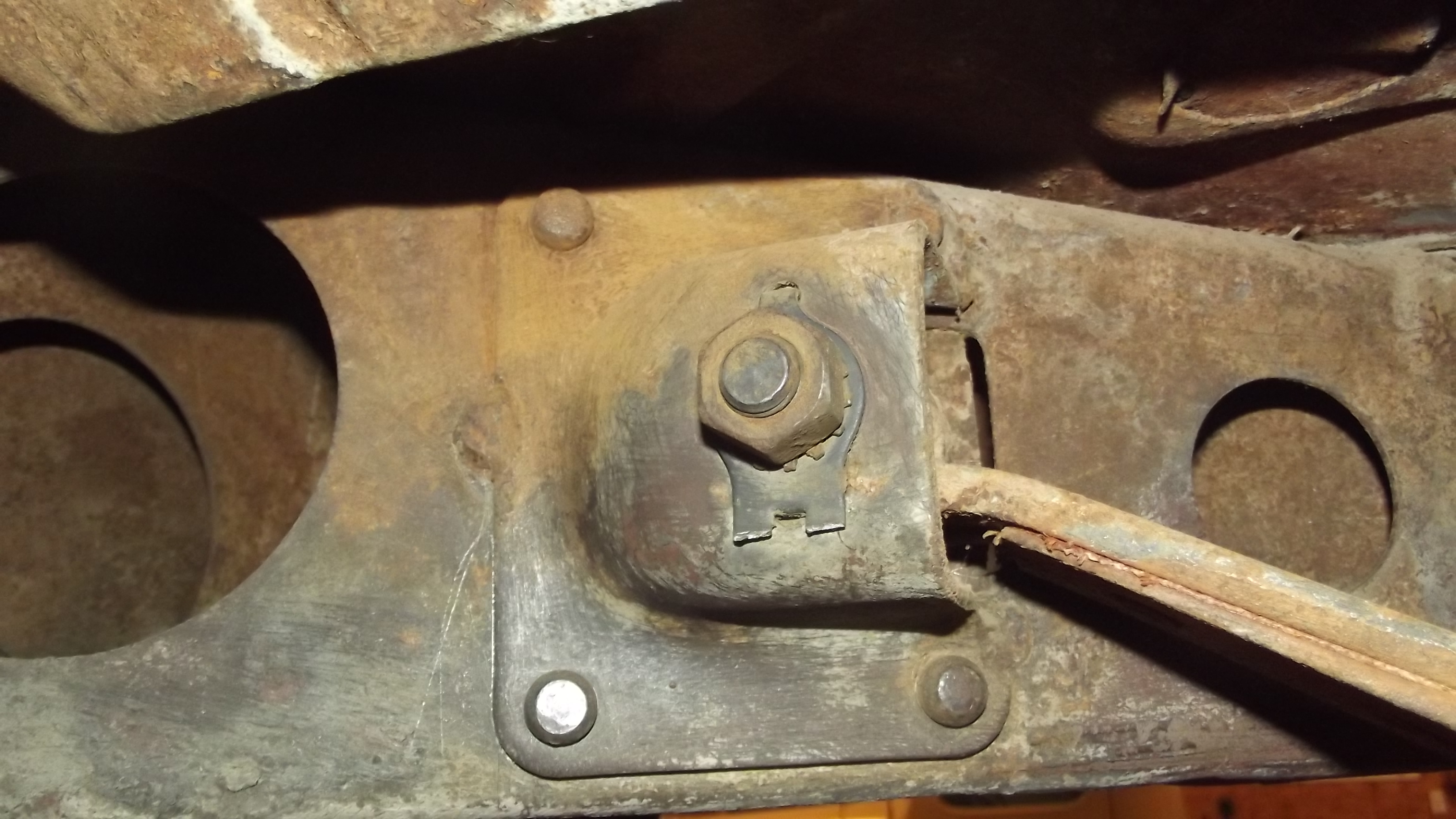

Lance, I am still confused about removing the leaf springs from the chassis attachment point. How do you slide the bolt thru there is not a hole in the backside of the frame pocket?

It looks like both the front and back side of the frame pocket are attached to the frame with rivets and tack welded on all sides to the frame. I guess i could cut the welds and drill out all rivets and replace with bolts or drill an access hole on the back side big enough to push the bolt thru. Someone out there must have faced this issue before. Any suggestions

If your 53 Hornet is like mine, removal of the front attachment point of the spring does not require cutting rivets. The 'bolt' looks like an inset disc on the outboard side of the mount, The nut is there for a reason. You should be able to remove nut and washer, then tap bolt out toward side of car. The bolt has no hex head. Instead, it is press-fit into the spring bracket, and kept from spinning by grooves on the coin-like bolt head which engage on the outer hole in the bracket. I cannot imagine your car is designed differently, unless someone modified it. Look at the outboard surface of the spring mount bracket, the side opposite the nut. You should find a flat circle which represents the head of the bolt.0
My car is a typical hardtop 4 door sedan, 53 Hornet. Convertibles or other models may be different. Convertibles likely require more subframe reinforcement, and therefore Hudson was obligated to add to the existing structure. But it is hard for me to imagine Hudson installing springs in such a way they could not be removed without drilling rivets and cutting welds. Seems out of character.0

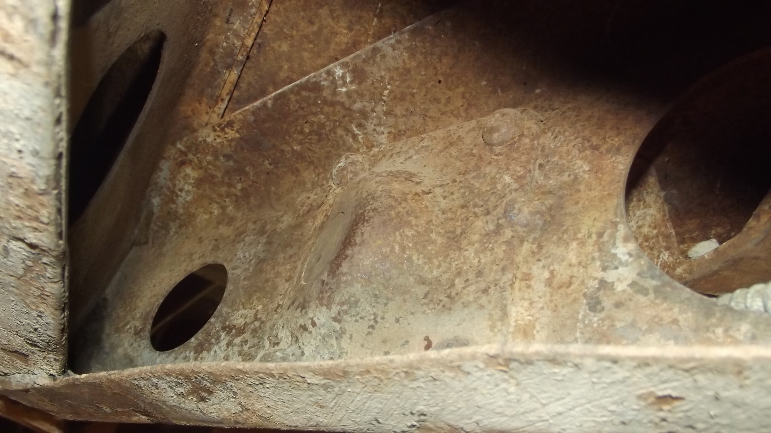

All, I have a few pictures attached, It seems to me that there maybe a knock out plug on the backside see the flat spot and circular ridge. David is your frame open in this location?
John
Another possibility is that it is packed with 50 years of dirt! I have already removed a significant amount of dirt from the chassis. Dirt that was so packed i needed an air chisel to remove it. We will give it another try later today.

I can see the round head of the bolt in the 1st picture,just knock it out but mark it first so it goes back in the same spot.0

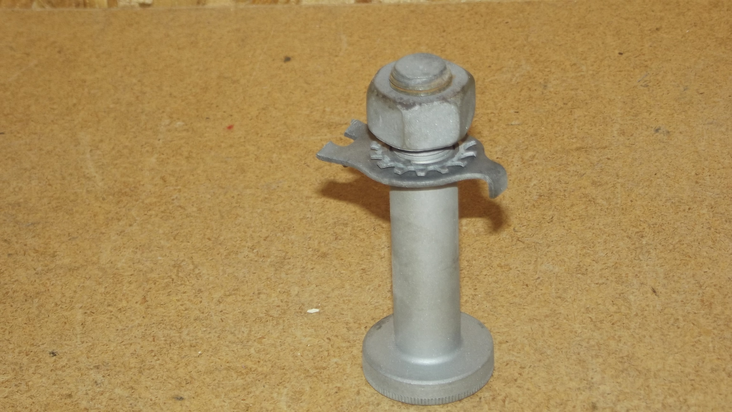

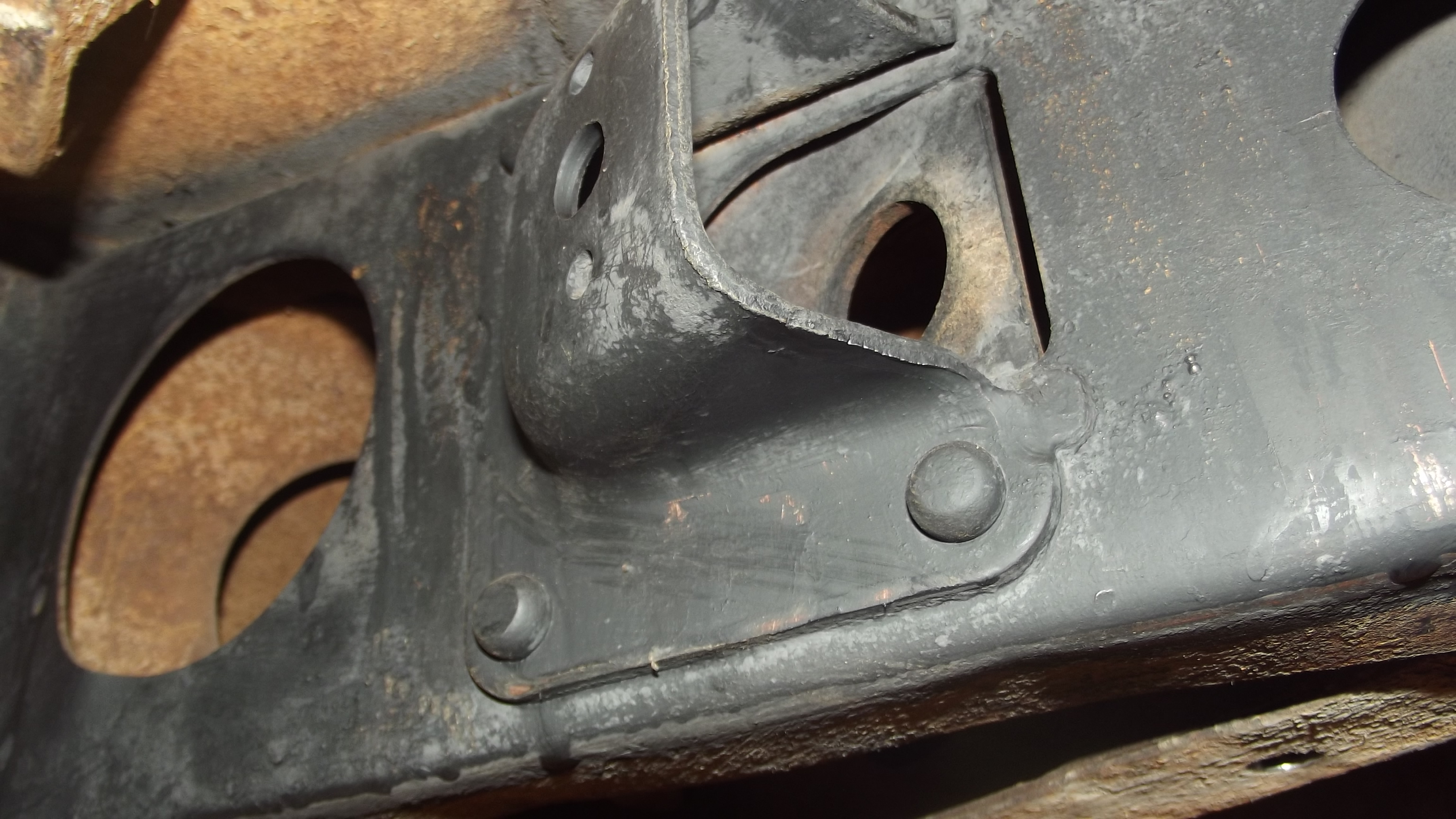

I got it out! Lance & 48Sed were right on.
Thanks to all for the help. After I chisled the old dirt off the backside I was able to drive the bolt out. In the atttached pictures you can see that the bolt removed has a very large head.
