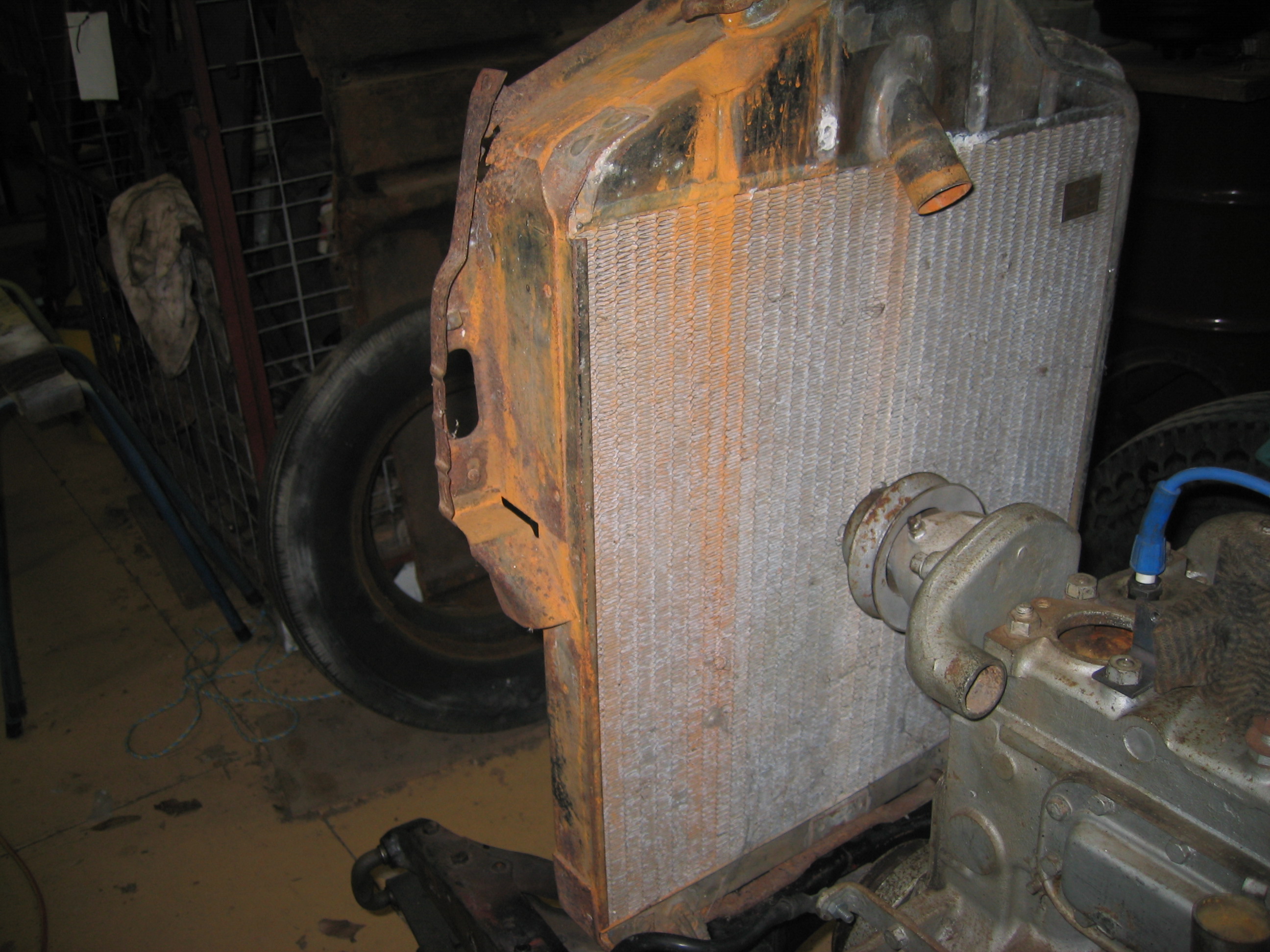

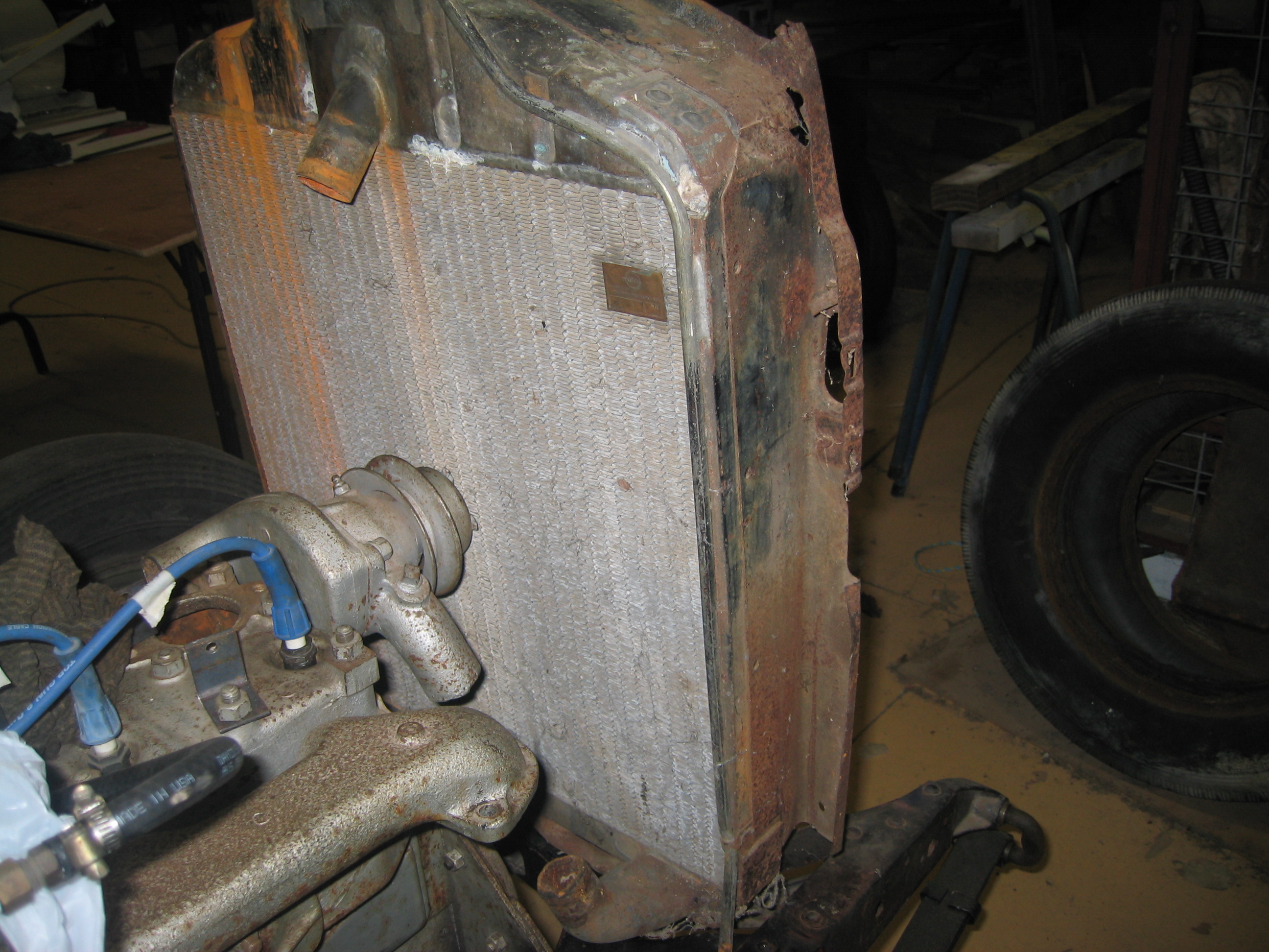

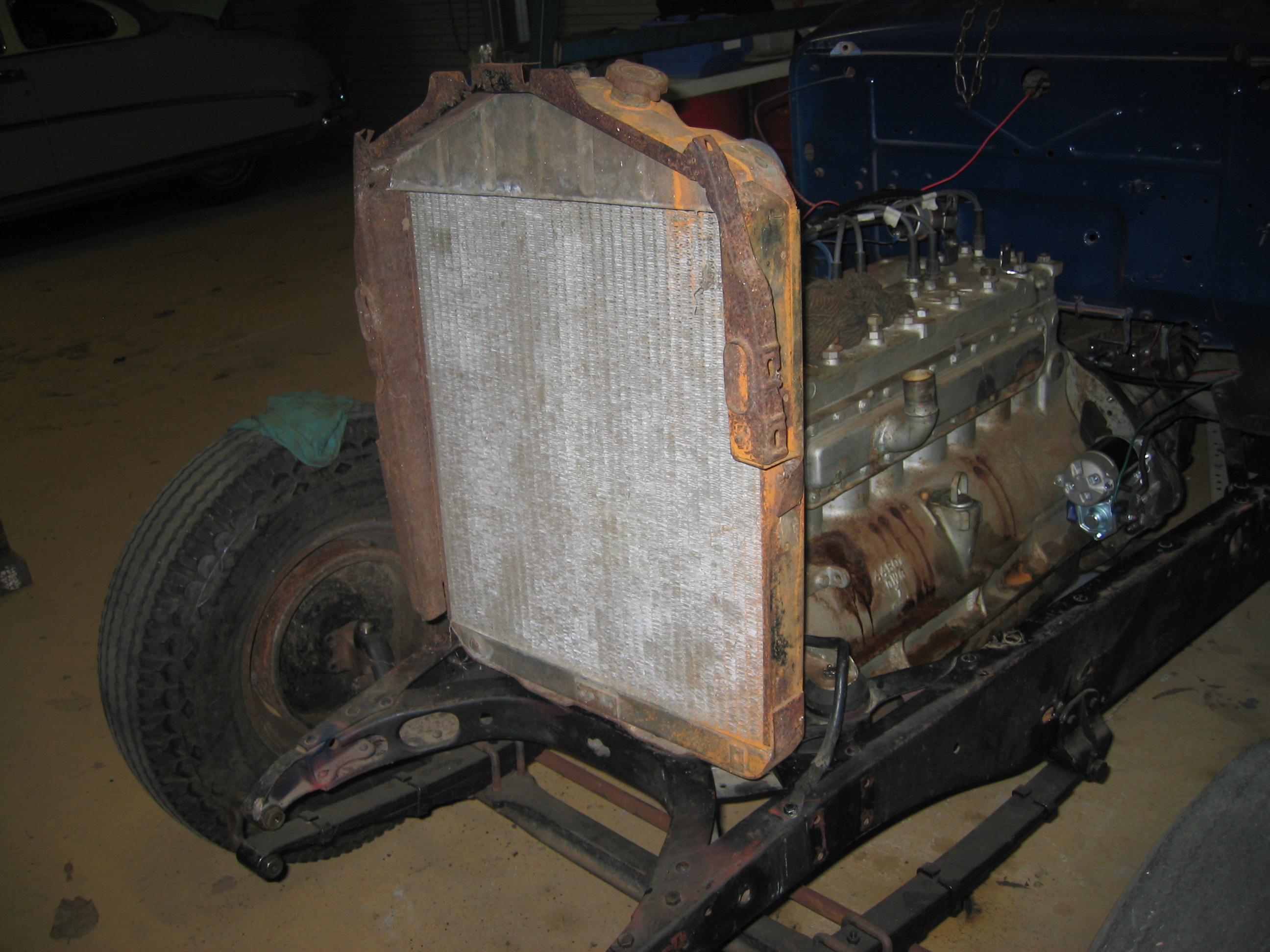

Is this a 35 H8 radiator?
This is the radiator that came with my 35 H8 project but I'm concerned it may not be the right one. Its about the right size, the mounting holes line up with the chassis holes and the outlets point in the right direction.
What worries me is that I have all the 35 front sheet metal but none of it matches up to the fixing holes in the radiator sheet metal. The top 2 holes in the grille surround match the top 2 holes in the radiator sheet metal but that's it.
Any thoughts?

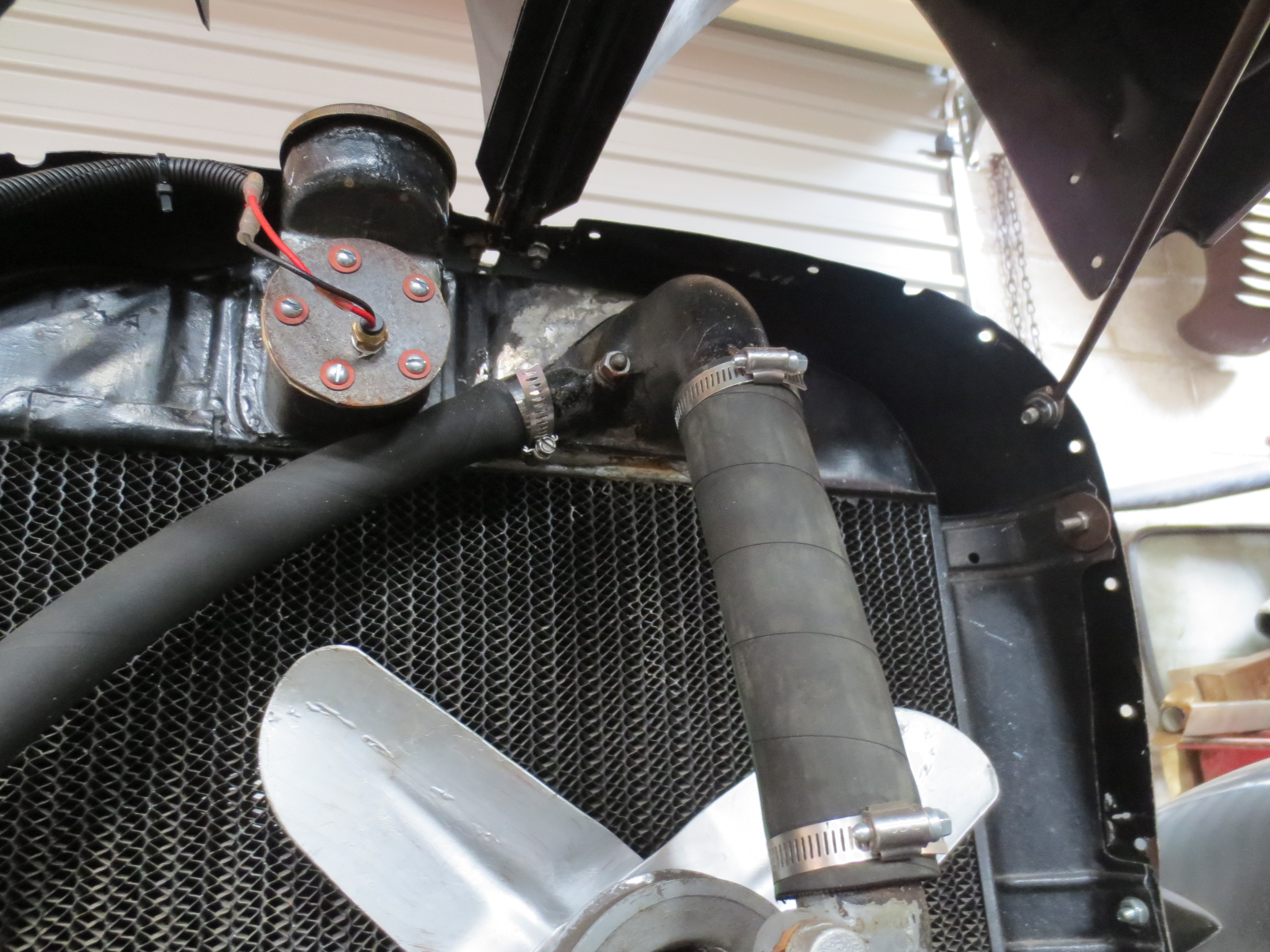

It turns out that my radiator is most probably a 36 and is not readily adaptable to a 35.This it the top back of a genuine 35 radiator. Thanks to Trevor J for the info.I suspect I may also need to chase up a 34/5 waterpump to go with the proper radiator.0

Bob,The '35 radiator has a threaded radiator cap. The top tank of the radiator extends backwards so you can reach the radiator cap easily when the left side of the hood is open. Also, the top tank of the radiator contains a sender unit for the water level gauge on the dashboard, which measures the water level in the top tank of the radiator (not the temperature of the water). A wire which is attached to this runs with other wires on the left side, to reach the gauge.The casting number on the left side of the crankcase (near the dipstick) of my 1935 8 is 44601. In the club library is a table showing casting numbers for various years. You may be able to determine the year of your engine from this table.Per0
