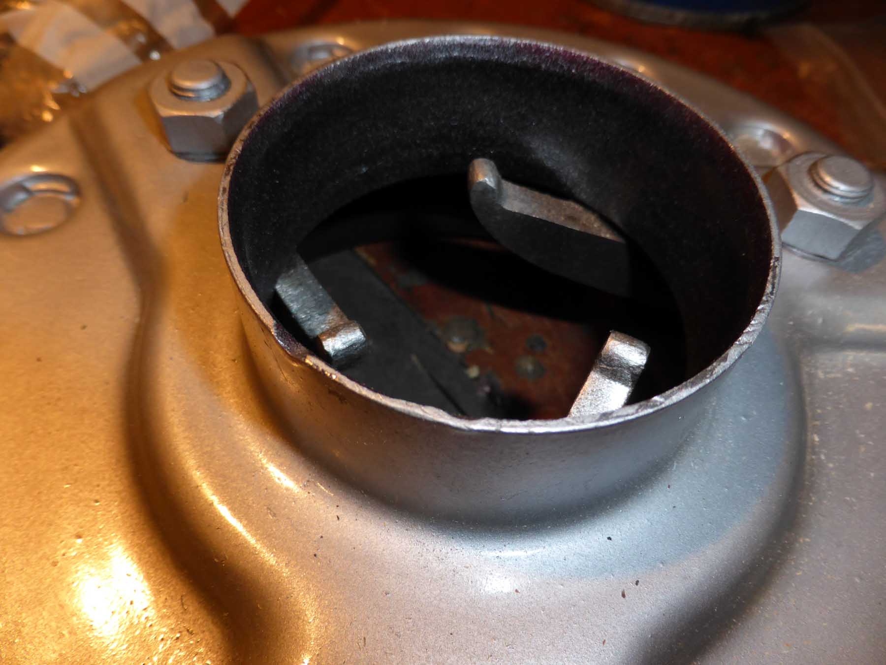

Phil, the neck rotates around the seal and the seal moves up and down in the neck when the clutch is used.There should also be another seal that fits on the inside of the throw out bearing carrier and seals against the input shaft.0
Yes, it is better to soak the plate in ATF before installation otherwise you will have to top the fluid up after a short time as the corks soak up the fluid,then there is not enough to make a smooth clutch .1/3 pint of Dexron 3 available from any parts store.the neck of the pressure plate should be smooth with no scoring.0
Phil,
You are correct that the inside of the cover "snout" must be well polished and free of defects. Not only does the seal move fore and aft, the seal remains stationary (non-rotating) whilst the cover rotates at engine speed. This results in a peripheral speed of ~650 fpm per 1000 engine rpm.....about a quarter mile per minute at cruising RPM, so you can imagine how quickly the seal would be eaten up if the snout is nicked or rough.
Yes, the flywheel must be sealed at the crank-flange.
Be especially careful when installing the trans/bell-housing/throw-out brg ass'y onto engine and the clutch cover. It's very easy to "roll-over" the lip of the outer seal......very bad. I'd guess about half of those I've dis-assembled had that lip folded over backward at some point. Lube the seal and snout at assembly time so it doesn't run dry at initial start-up.

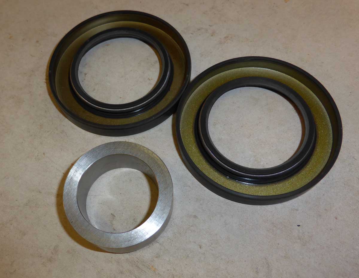

My guess as to the identity of the items in the left-most photo: Inner and outer rear wheel bearing seals and a crank snout spacer that goes between the timing gear/sprocket and the vibration dampener.
F
1st pic looks like timing cover seal and spacer.
delete
Ah! A better guess than mine considering the functional relationship of those items.
