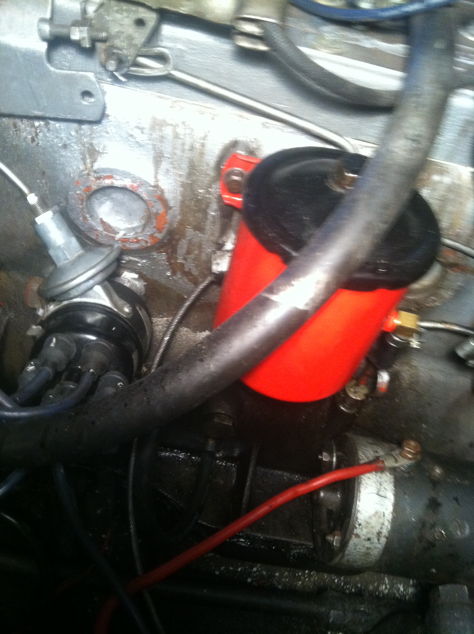

Okay, I installed the oil filter canister pictured below and I started noticing the noise shortly thereafter. When I first put it on, I didn't tighten the top as much as I should and oil just poured out the top which indicated to me that the oil pressure was good. Now the oil is a lot cleaner and the idiot light goes out when it's running, so I don't know if putting the filter on created the problem or if it existed before I installed it. I have noticed a small amount of oil on the block in front of the starter where line from the engine goes to the bottom of the filter as shown in the second picture.0
What oil did you put in the engine? Id think they would run best on a straight weight 30 detergent oil. If you drained out 50 year old nondetergent oil, and just started to use a detergent oil, the detergents in the oil are going to break down some of the sludge, which can clog the screen on the oil pump in a short period of time. A clogged oil pump screen will starve the bearings for oil, which will make noise, but it wont be immediate like your describing. How hard is it to pull the oil pan and check the main/large end rod bearings? I havent worked on any Hudson engines, but have a hundred plus small flat head engines. I always pull the pans off every engine I pick up and give it a thorough cleaning before running. Ive pulled apart some engines which have sat so long the paraffin oil turned into a sheet of wax! As others have said, there are no rockers, but how about the lifters, could a lifter be marred from sitting. Ive seen water cavitate lifters in other engines and when run, make a horrid noise. With the engine running, you should be able to hear where the noise is coming from. If the noise is spark related, it will change with rpm and the way you set the timing. Id definitely be cautious of running it much if you have a rod/main bearing issue.

A bypass type filter will not affect oil pressure if it's plugged. It will have a slight effect on pressure when in operation but is inconsequential. By design, the system "waits" until the pressure is up to ~20 psi before allowing oil to pass to the filter. I'd never thought of it as an indicator of oil pressure, but the flow of oil from under the canister lid would indicate at least 20 psi since the system dis-allows flow below that pressure.

Get an underhood oil pressure gauge and install in place of the oil pressure sender, start it, and make sure youre getting decent pressure, ~40 psi when revving. If not shut it down immediately and investigate: pump, pickup, etc. But it won't be due to the oil filter system per se, unless you messed with the large diameter flat nut on the driver side near the oil filter, and removed the spring or piston, did not reinstall, therefore oil just leaves the pump and squirts back in the pan.0 -

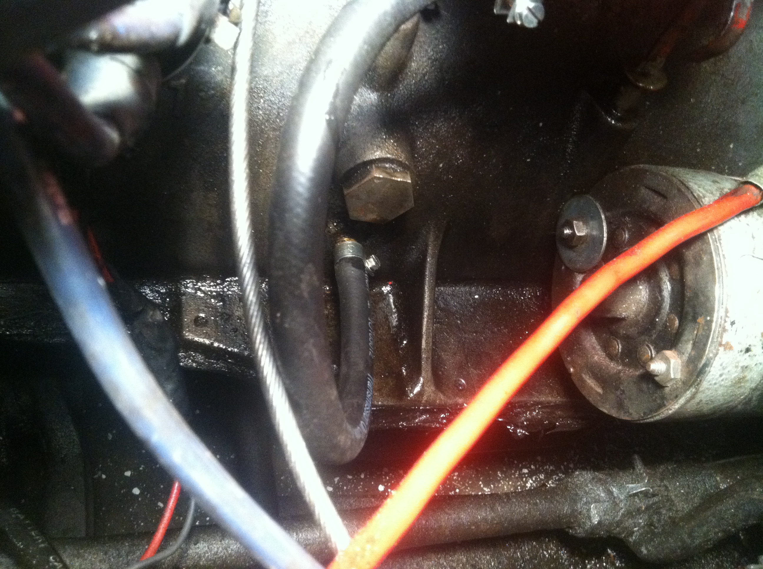

Ok, I just checked the oil pressure and it barely got over 25 lbs. even when the engine was revved up. When I told another old mechanic friend of mine about the oil pressure over the phone, he immediately mentioned the rod bearings as the culprit. I hope to get one more opinion from a guy on site that used to work on Hudsons in his much younger days. The irony of my situation is that the mechanic who rebuilt the engine nearly sixteen years ago said it would last a lifetime. It did...his. He died about three weeks ago at the age of 70....just before the noises started.0
I don't believe we've determined if, in fact, that it's a rod knocking, but if you have pressure that low, I'd remove the pressure regulator bore plug (behind and below the distributor) and check to see that the spring hasn't broken. If it previously had reasonable O/P but dropped quickly, the spring may be the culprit. If, in fact the sound is a rod, then the damage is already done.
My opinion is that if it isn't knocking loudly on numerous rods, the low pressure isn't caused by excessive bearing clearance. The pump should put out a high enough volume at elevated rpms to keep up with bearing clearances that are not yet "talking to you". That leads me back to the spring being either broken or just very tired.
Question: Does it come up to the ~25psi fairly quickly but just not go any higher? or does it slowly progress to 25 over the entire rising rpm range. The former says "spring", the latter says "big leak", like wide bearing clearances.
Frank
Goes quickly to the ~25 psi and stays there. Query: How hard is it to get a replacement spring?0
Ok. in case I installed it improperly, I took the oil filter canister shown above off and cranked the car. It went to ~40 psi. However, the longer the car ran, the lower the oil pressure became and finally rested at ~25 psi. Is that normal? Somebody mentioned that I should be running 30W oil in that engine, but I've been running 10W40 oil in that car ever since I bought it.0
