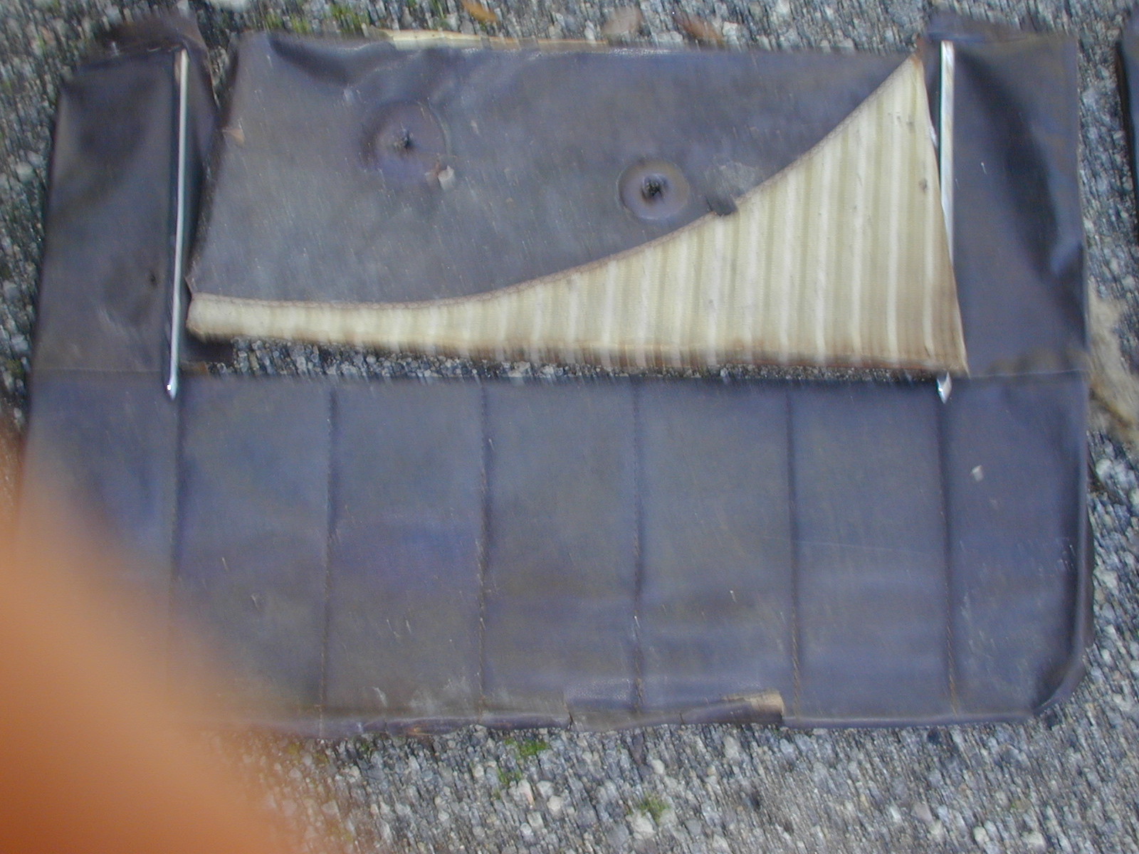

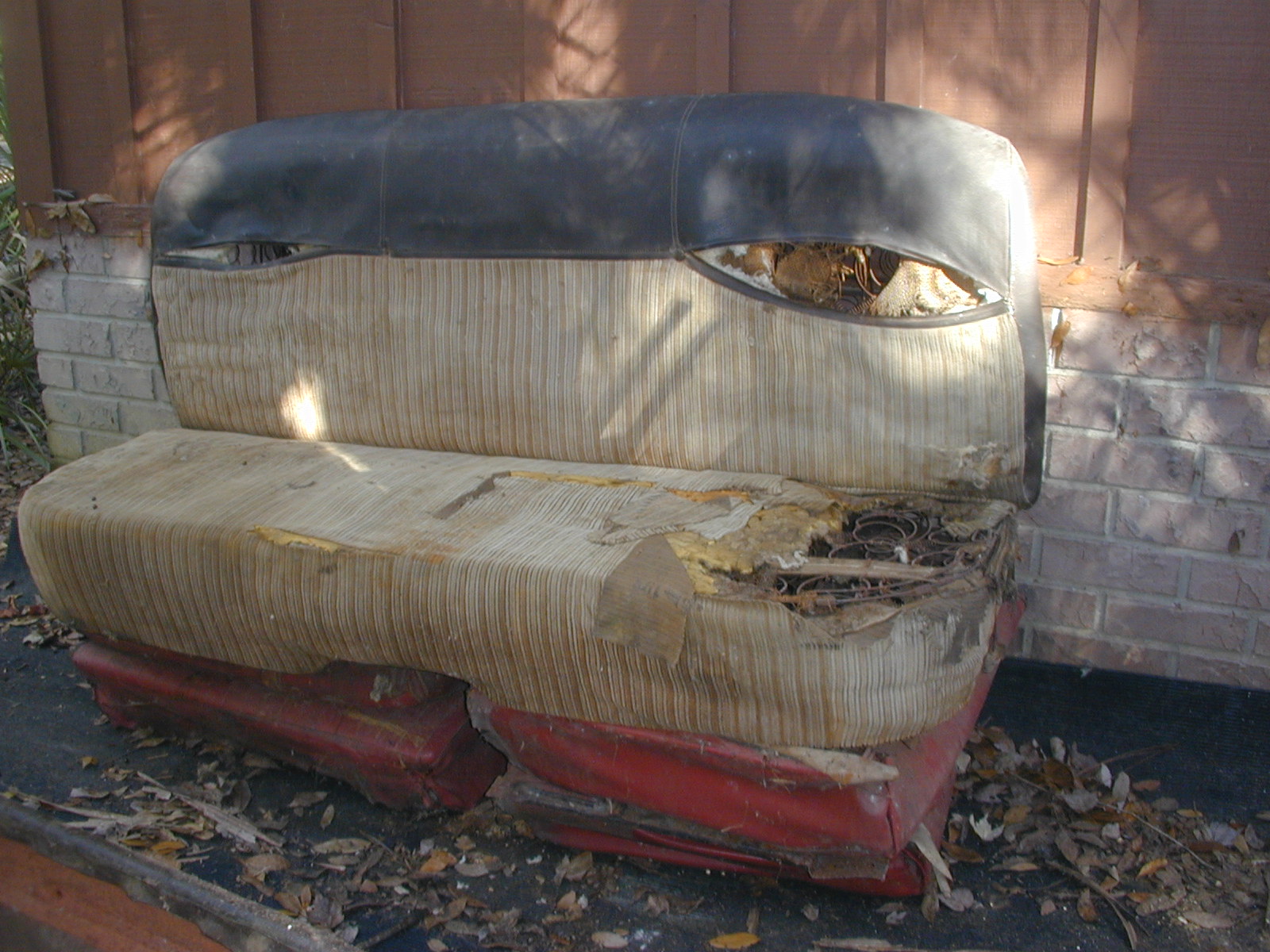

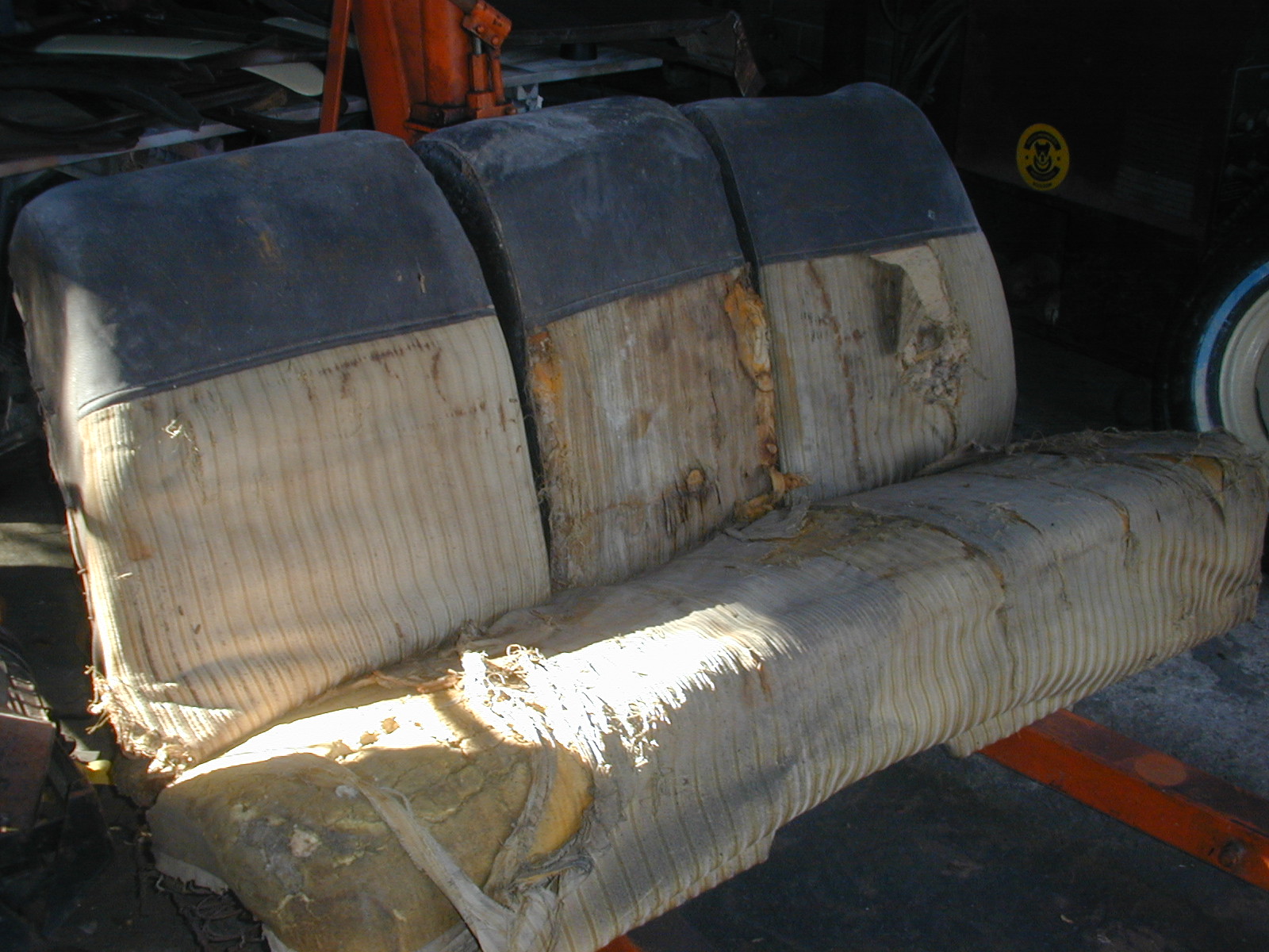

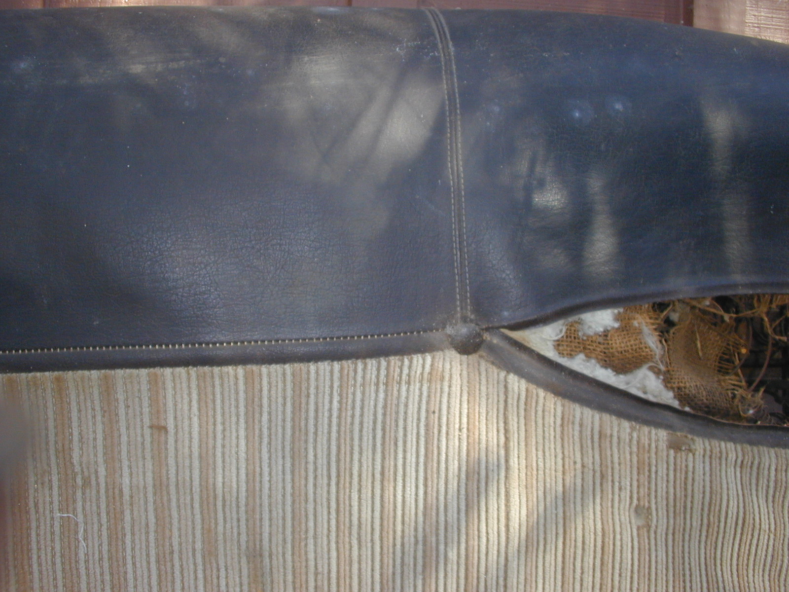

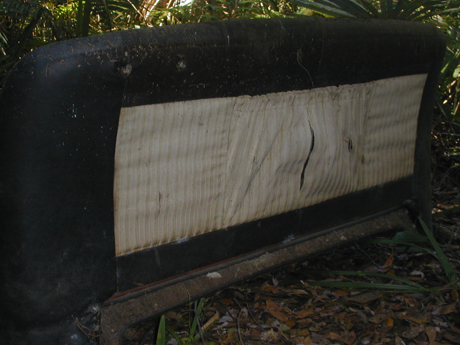

I parted out a 51 Hornet four door. Texas tan ? Really rusted out. I am keeping the rear seat for my 49 Two door..Anyway. ..here are some pictures of the original stuff.
There is no vinyl on the bottom cushions. The fabric is one piece and has only one seam on each end where it is wraped around and sewn.
Great photos, Thanks!
These look very similar to the car we have, I think that's conclusive enough to go with vertical stripes. Thanks again everyone for commenting & helping out. I will post some progress shots once we have something to show.
