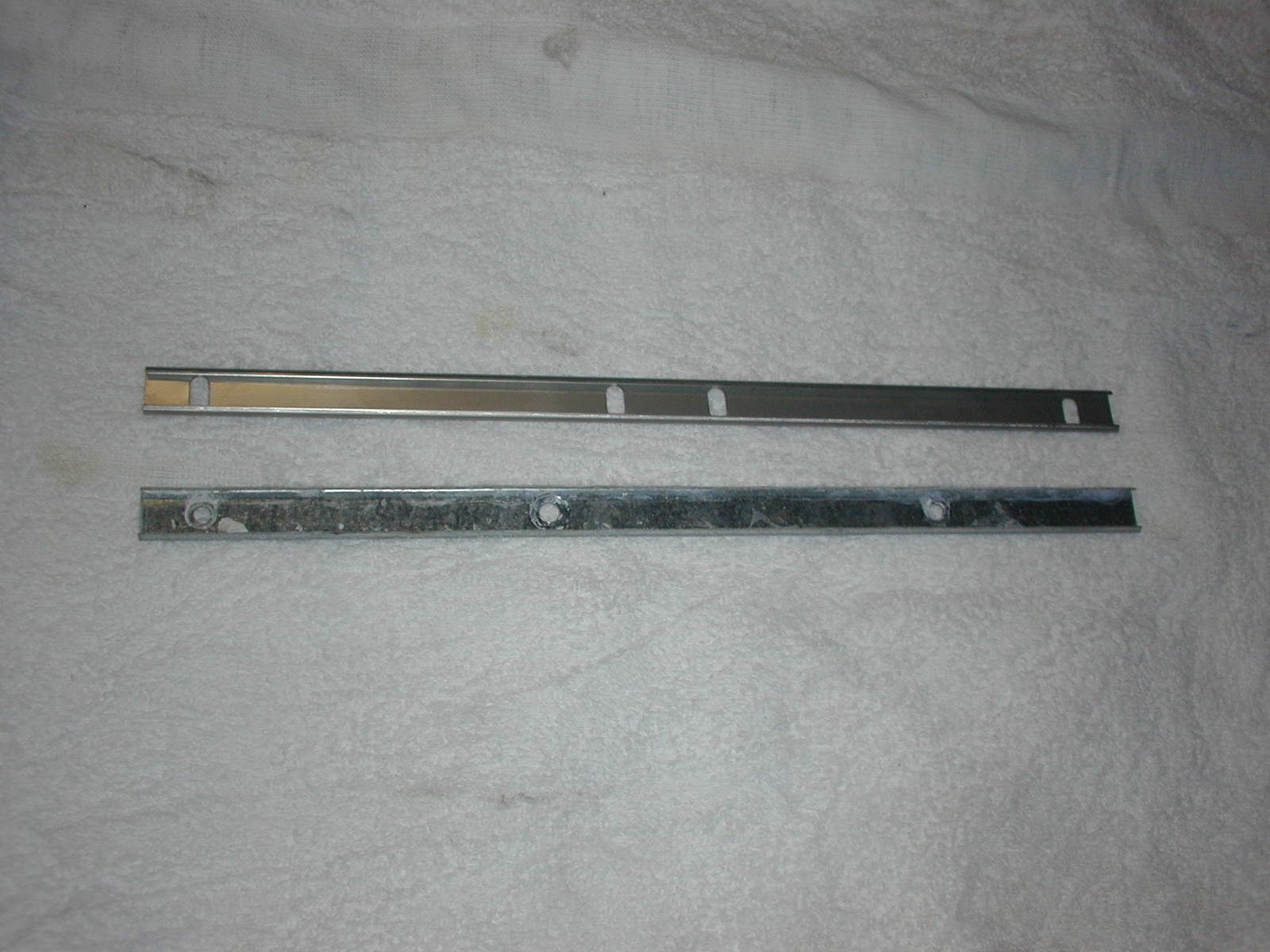

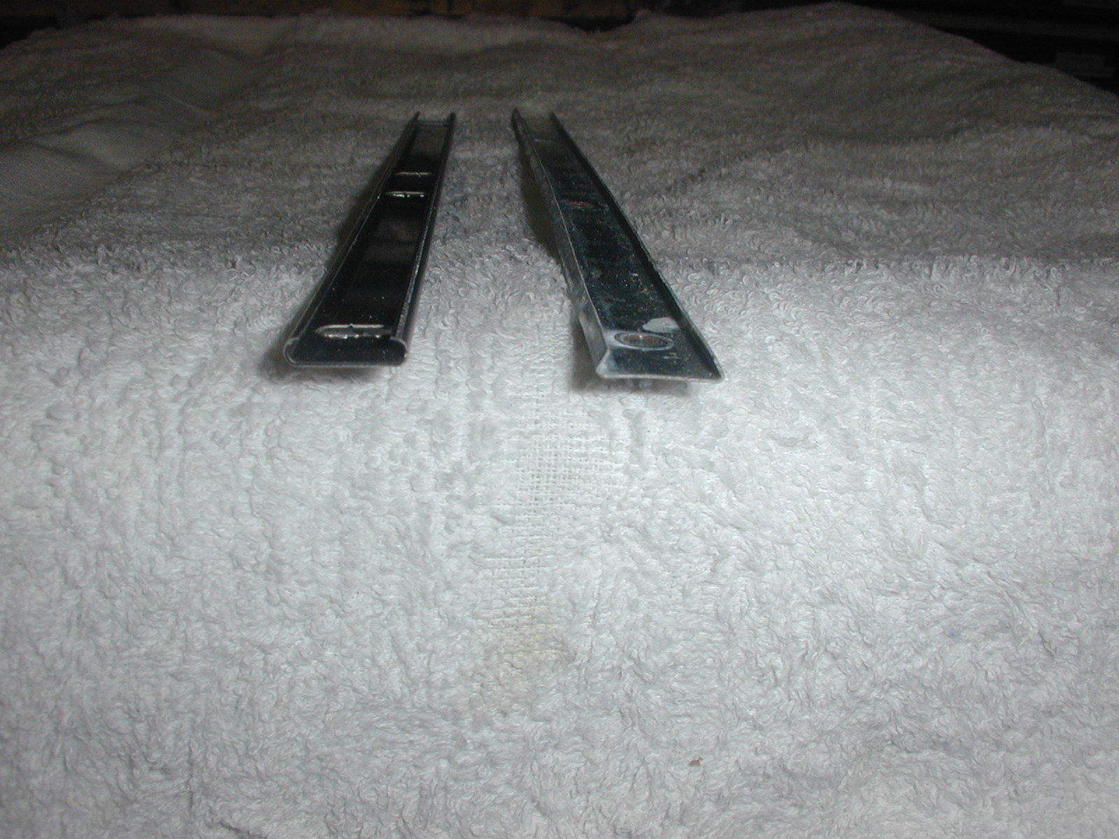

I had a requirement for the retainers used along the bottom fenders and doors of a 49 . Most of the originals had rusted beyond help. I ordered some from a vendor that advertises in the WTN. They proved to be substandard. They were made from galvanized steel, but formed on a sheet metal brake. I followed the instructions and had to use too much force to get the trim to snap over the retainers and ended up damaging the painted surface. I then ordered some from WRP. It took a long time to get them, but the wait was worth it. These are better then the originals simply because they are made of stainless and will never rust. They also seem to be the same shape as the originals. I suspect they are formed through some extrusion process. attached are a comparison of the two sources .
Dave-That's good to know. I used the "sub-standard" ones on the convertible, as the ones from WRP were not available at the time of purchase. I utilized an old trick by inserting a stainless washer BEHIND the retainer, which takes it up off of the painted surface. You have to lube the inside edge of the stainless and make an impromptu installation tool to help with the install. Very tedious and time-consuming process. I think it took an entire day to do a '52 Hornet with two guys who were familiar with the process (me and a friend).0
I assumed WRP got them from the same source as Kgap. BUT.. I got some older ones from a forum member that originally got his from Kgap. and they had the slotted holes punched horizontally and the WRP's were punched vertical.. Otherwise they were identical and very user friendly! Probably from the same source though (Bent metal?)0
