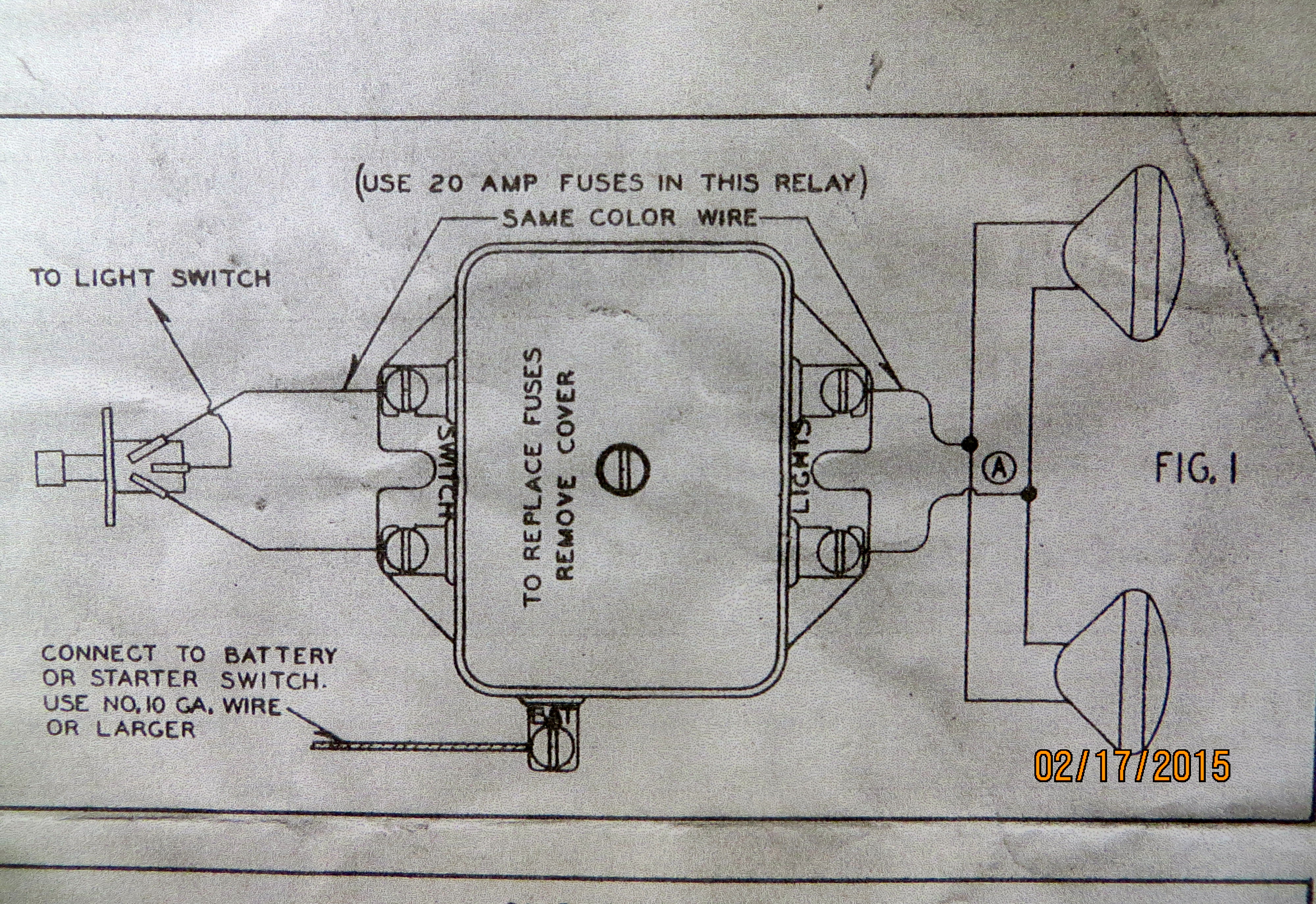

I purchased a couple of dual relays on eBay a few years ago. Here are a couple, I paid about half this but maybe they are getting more hard to come by.0
Thanks 48 Hud for the picture. Ray0
Hi 48 Hud I went out to my shed and come up with a headlight relaythat looks the same as you used. How do I tell if it is 6v or 12 v. and how do I test the relay to make sure it works properly Ray0
RayTake the cover off and see if there is a factory label that gives the voltage.To test follow the diagram and connect up an old headlight to the terminals labelled lights and using a jumper put power to each of the switch terminals one at a time and see if the headlight comes on or connect up an old dimmer switch as shown and test .0
