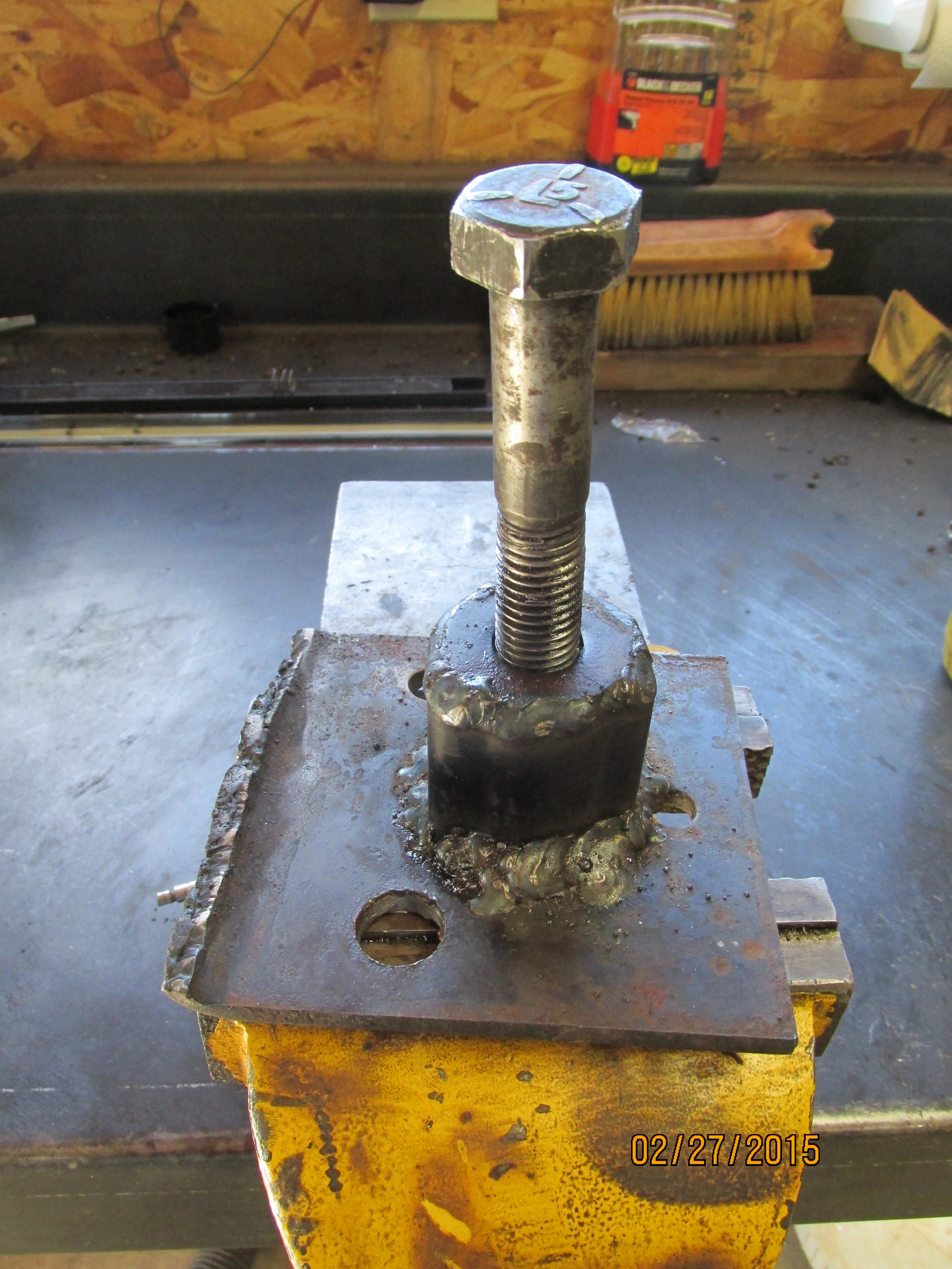

I am trying to remove the rear wheel hubs on my 35 Terraplane to look at the brakes and rear bearings. For the life of me I cannot get the hubs off. My mechanical procedure manual says to use a " J-446 Wheel puller " which of course I do not have. I fabricated what I think is a close idea of the puller out of scrap metal I had but I cannot get either one to budge.
Before I break something I cannot replace I thought I would ask you guys for some advice. To recap, I have removed the axle shaft nuts and washers, I have sprayed WD-40 as well as a 50/50 mix of acetone and ATF on the shaft and let it set for 24 hours. Is there something else that needs to be removed before you can get the hub off?

Mike, if your Terra is still mobile, put the nuts back on the axles, leave them half a turn loose, put the split pins back in.Drive around the block a few times.The ATF etc is achieving nothing, you are dealing with a long shallow taper, metal to metal stiction.What I find to be a good hub puller is a piece of 3/4" or 1" plate drilled to suit the PCD of the wheel. Bolt the plate to the wheel, the centre of the plate bears on the axle nut. Go round the bolts with a rattle gun and tighten them a little at a time.The hub flexes slightly as you tighten round and round, makes it easier for the hub to break loose from the taper.0

I have attached a photo of the puller I made up. I bolted it to the hub with just two lugs but can drill holes for all four. After reading your feedback I will buy or borrow one or make up a plate so that I can keep the castle nut on the shaft for safety's sake. I had so much pull on the hub yesterday that I was wondering what kind of projectile I was setting in front of.
Once I get the vehicle mobile again I will take Bob's advice and drive the car around with the castle nuts loosened and see if that helps. Here in North Idaho the highway department is using so much road salt that pickup and truck rims corrode to the point that rims just weld themselves to their hubs. We loosen the lugs and drive around to get the rims to break free. I never thought to do that with the terrplane to get the hub off of the axle.

Success, I adapted my homemade puller to use all four lugs and made room for the castle nut to be on the shaft. I had that puller bolt as tight as my rattle gun would go and I still had to use Jon's idea and tap on the rims for awhile before they broke free. By using a grade 5 bolt instead of something harder it did not mar the axle.
