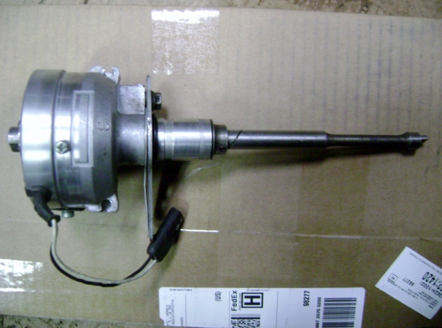

My preference is to upgrade but to use factory parts and not aftermarket pieces, just in case something goes bad you can find the part locally and not have to leave the car set till the mail delivers your special order part.
I use the Mopar 225 6 distr with the magnetic pickup and use it to trigger the GM 4 pin HEI ignition module when someone runs a carb.
For EFI I use it to trigger the GM 8 pin ignition module.
For the distr you can either convert the original or swap the original shaft into the dodge distr housing.
I think I showed the basics in my EFI thread.
Here's a little video I did showing how it works. This is on an IH distr.
https://www.youtube.com/watch?v=gWsDg_ZpR6U
FYI
Electronic is the way to go..Ive installed Crane XR700 Point Conversion Kits in the Hudson Distributor and really like them.The tiny Photo Cell fits where the Points went and you discard the Condenser. The 'Reluctor with 6 slots' fits right under the Rotor. Ive also adapted 6 Cyl GM HEI Distributor by switching the Shaft with a Hudson Distributor. I believe Ron Fellows, the Clutch Man in the Club sells the complete GM 6 HEI Distributor,. So now you have a few choices.....
