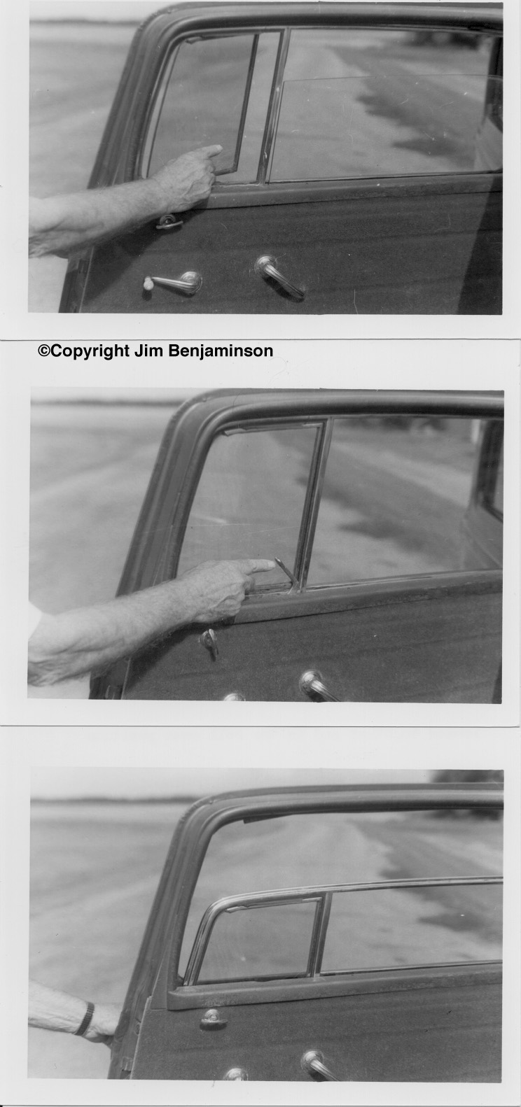

Thanks Jon. The disappearing vents are in '34-39 Terra and Hudson. For certain Plymouth also used this same system in their 1934 PE model cars but that was the only year and model. Without taking my door apart again just yet, memory is that this type has one gear per side and the motion is in the mechanics of the mechanism. I have sent an inquiry to Mike W. Photo set is of the Plymouth in action. Photo credit Jim Benjaminson.

Interesting, but Plymouth's vent is nowhere near as cool as Hudson's! The vent is housed within a frame that also holds the regular window, apparently. The regular window goes up and down on its own, then the frame (in which the regular window slides) goes down, taking the vent window with it. Or so it seems.
Hudson's vent windows (for the benefit of anyone one familiar with this) was controlled with one crank handle and was totally independent of the regular up-down window, being in its own cradle. When the vent window was one, you started to turn the crank, closing the window. Then you continued to "grind" and the entire cradle disappeared down into the door. The "regular" window could still be all the way up....or down. It didn't matter.
So I would seriously doubt that the mechanism was the same between Hudson and Plymouth. Although possibly the same window mechanism company supplied this and other mechanisms to Hudson and many other manufacturers.
