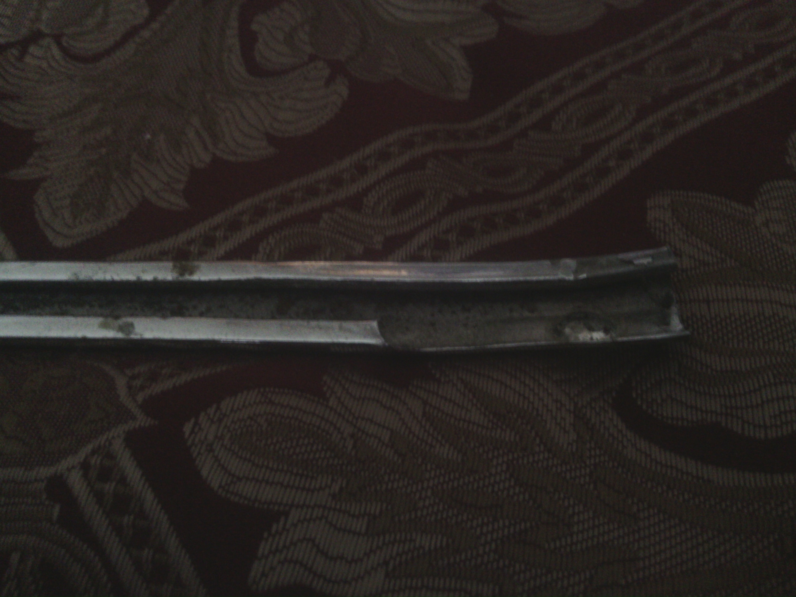

I need a hood trim molding if anyone knows where to get one or repair mine please let me know. I have pix. Of my broken one. Thanx....
FYI
Is that the Center hood Hinge or a side trim pc?
The center hood trim molding that holds both sides of the hood0

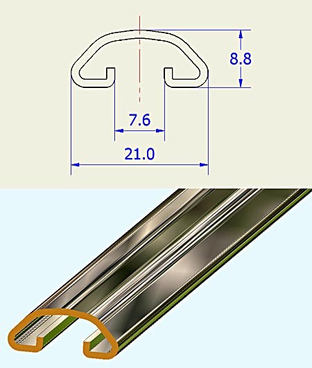

Early last year a series of similar hinges were sold on Ebay. Here is a link to the old auction (now ended): http://www.ebay.com/itm/1920s-1930s-CHEVROLET-HUDSON-REO-DODGE-40-REPLACEMENT-STAINLESS-HOOD-HI-/261365771248?pt=Vintage_Car_Truck_Parts_Accessories&hash=item3cda9d2bf0&vxp=mtr You could go to the auction and see if you can contact the seller to find out if he has more. Here is the actual hinge cross section:
(I think this is the same one that Ken U. just posted, above.
Not sure if any of these will work, but they're worth checking out.
