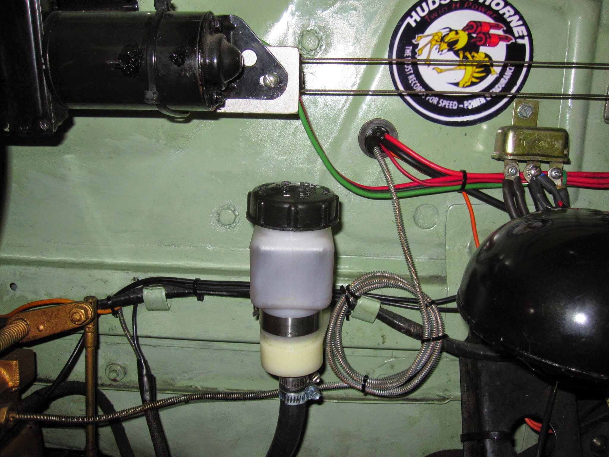

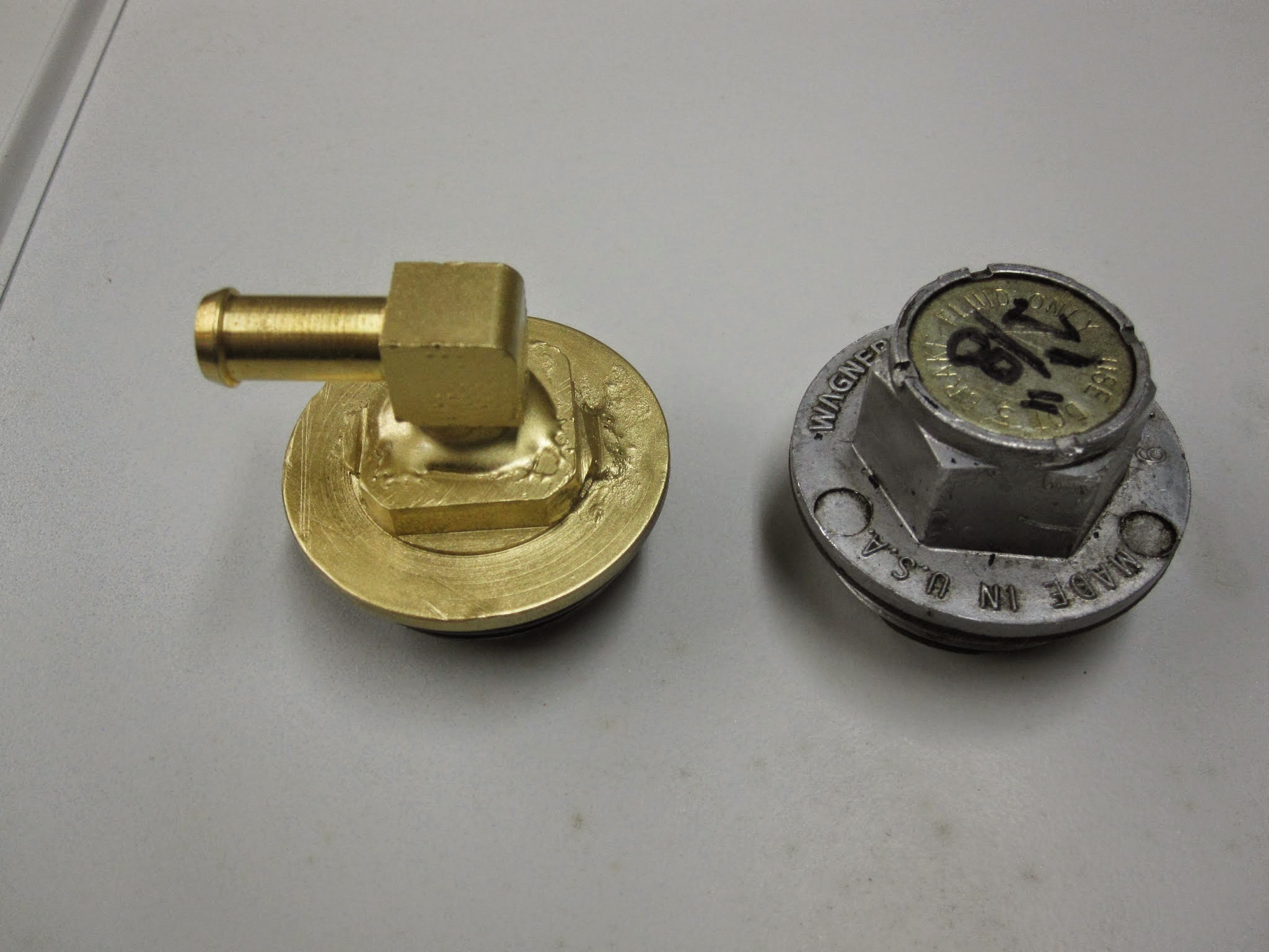

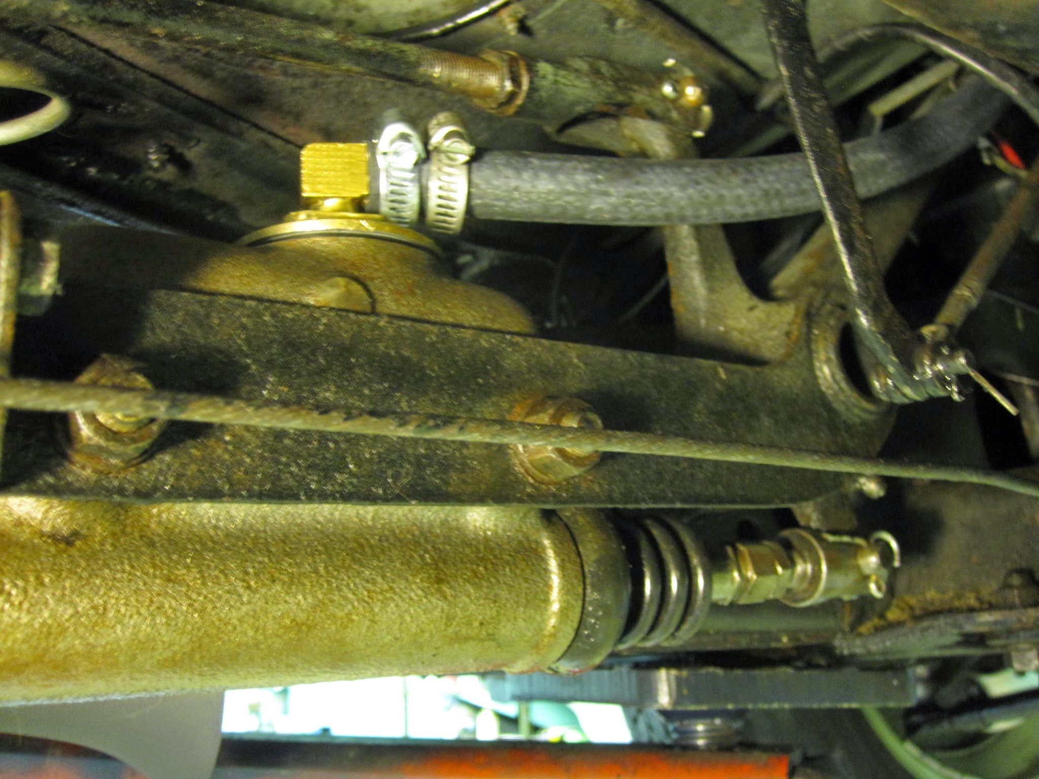

Have a remote for the brake fluid in the master cyl.; Both sure would be nice.Here is the remote brake stuff if anyone is interested. Remember to braze up vent holes in cap. Remote kit is Wilwood # WIL260-10500.
