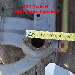

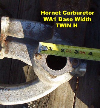

Oldfarmer... I appreciate your comments and the shadow in the "Hornet" pic is making it difficult, but aren't I looking at 2-3/4" measurement in both photos? If not, what is the measurement difference? And then what carb number would the 232-262 use if not the WA-1? Can you supply both casting numbers? Yes, a Uni-Syn is absolutely critical to making any small multi-carb engine run right.

Hi: The Senior or Hornet Twin H used the 968S or 2113S carb. The Wasp Twin H used the 990S or 2114S there are different casting numbers as well as part numbers for the intake manifolds. The Wasp carb stud spacing is 1/4 inch less stud center to center. I have attached the Carter sheets for both carbs. Look at the carb base data as it identifies to differences. As a note, I use the 968S carbs on the Hornet Twin H installed on a 232 engine. The metering rods have been changed to the middle lean rods.0

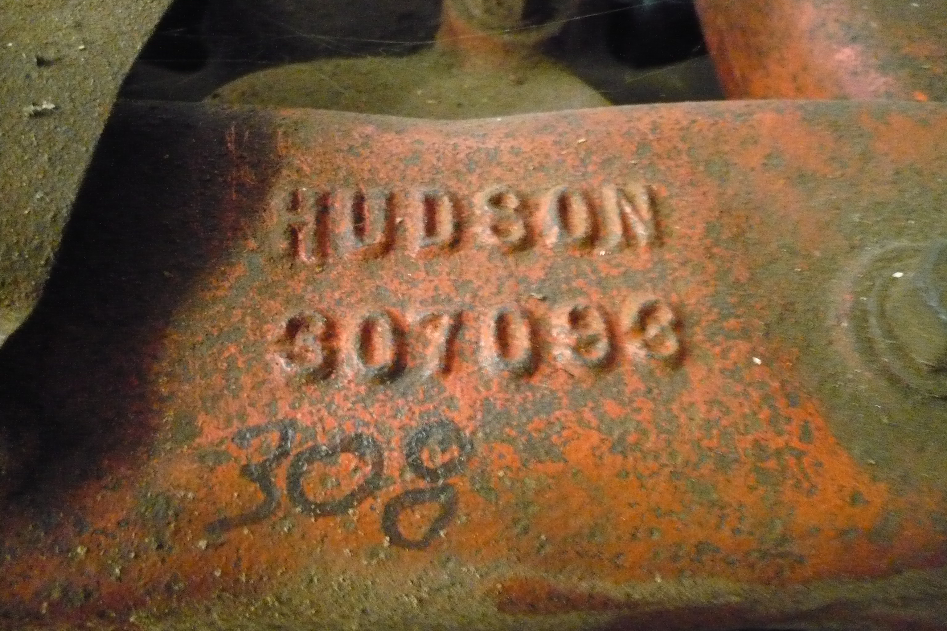

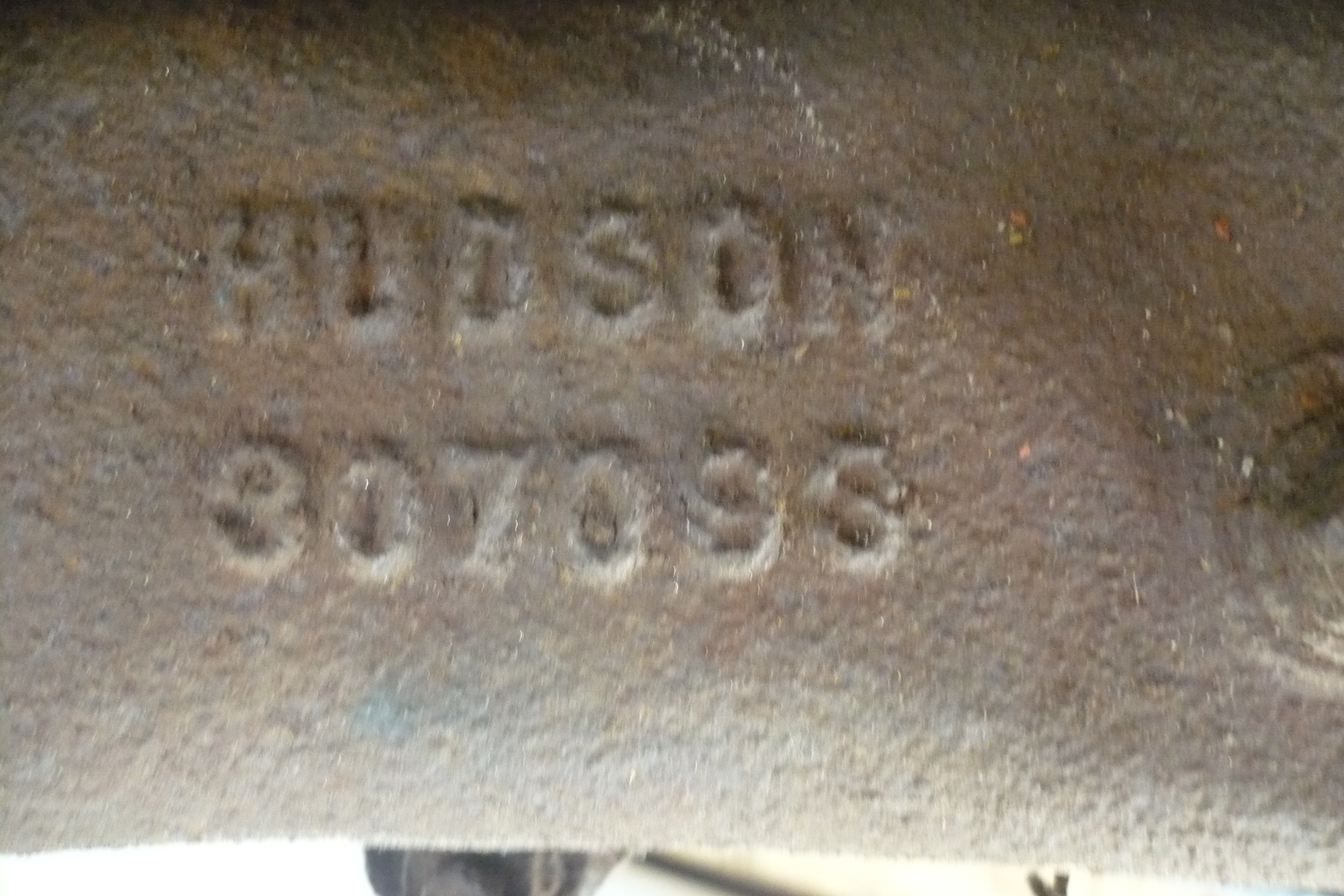

FYI, It appears that the casting # for either 262 or 308 T/H manifold is the same (exc. Hash, of course) but the machine work & P/N aren't.
***346 is a 308 and ***347 is a 262 manifold, but both have the same casting #.
The point? If you are watching for one, the # that is cast into it won't tell the story.......you must do some measuring to confirm.

Frank, thanks for the post. I went to my storage today and confirmed the Wasp manifold I have set aside does indeed have the same casting number as the Hornet Twin H.Hudson Guy... good information too. I have wondered if the base off the 968 or 2113 could be interchanged. Should have taken a look at the carbs too while examining the manifold. Made a note to look at that the next time. Also, the Carter metering rods came in at least three sizes to vary the carb fuel management. I settled on the leanest metering rods for the 968s and they allowed me eliminate the rich mixture of the standard rods.WG- Always liked your Wasp 2 dr and have kept a copy of that same picture in my files for years.0
