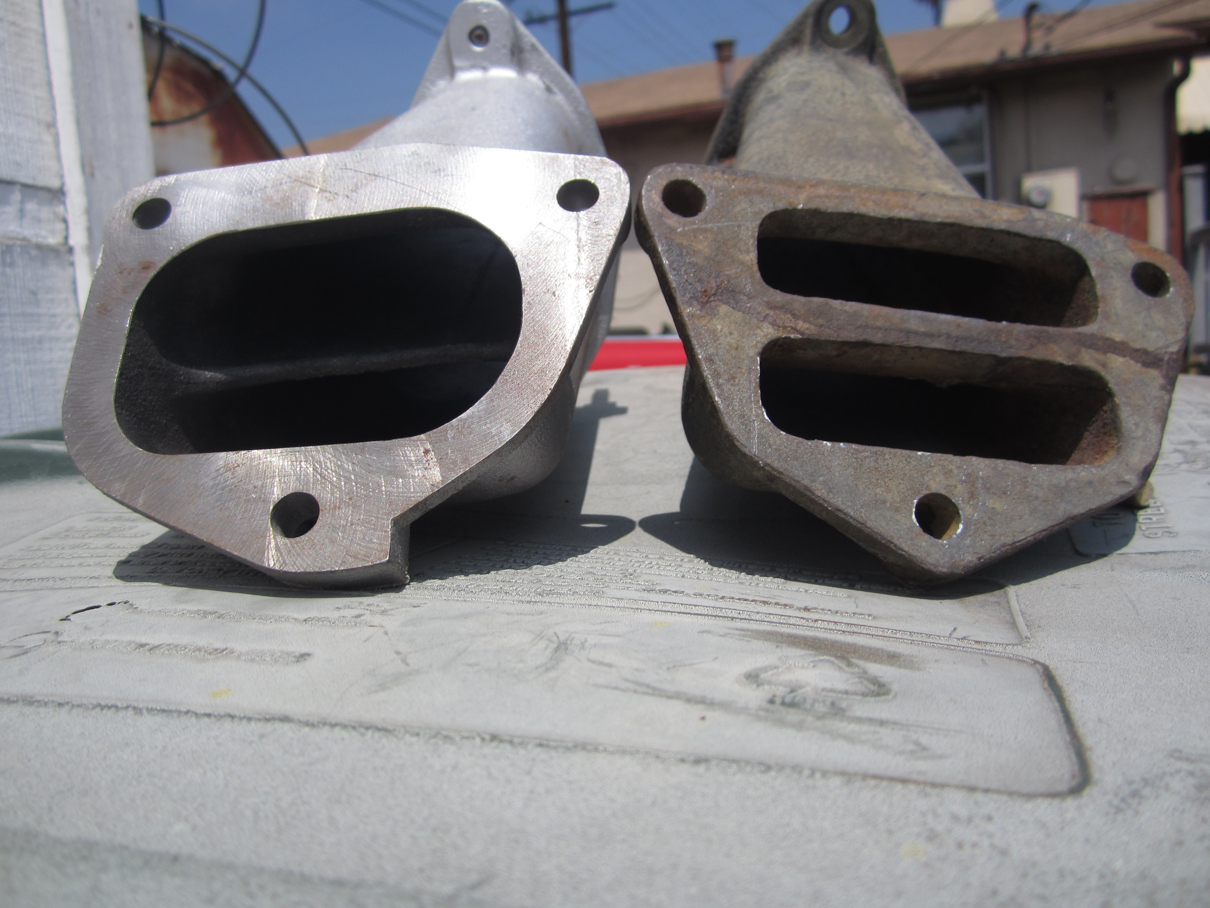

First Picture:
Picture of original 7X Exhaust adaptor on right fits only 7X exhaust manifold will not fit regular Hudson ex manifold. The adaptor on the left is a copy of the 7X but fits only stock exhaust manifold. It is open in the center to clear heat damper. The mounting bolt spacing is different between each. They are not interchangeable.

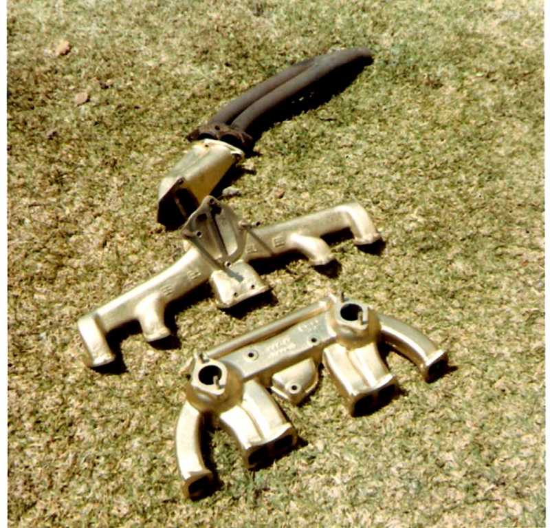

Second Picture:
This is the 7X intake manifold, 7X exhaust manifold and 7X exhaust manifold adaptor to 7X exhaust pipe0 -

You have an original 7X exhaust manifold. It will bolt to any 232, 262 or 308 engine. Unfortunately you also need the 7X intake and exhaust adaptor to go with 7X exhaust to be of any use. Well you could build your own exhaust adaptor. The 7X mounting holes locations between intake and exhaust manifolds are not the same as the mounting holes between Twin H intake and exhaust manifold. Also. the stock exhaust adaptor will not bolt to the 7X exhaust manifold.
Nothing is interchangeable between the 7X intake/exhaust system and the Twin-H intake/exhaust system.
