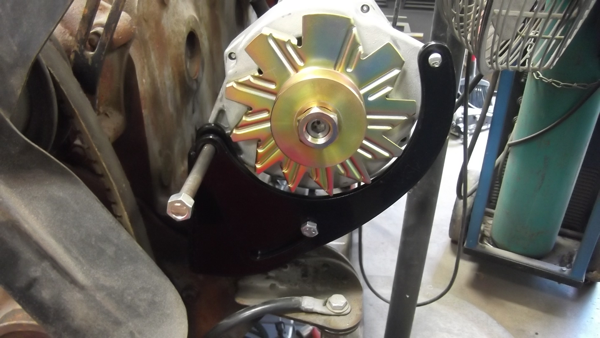

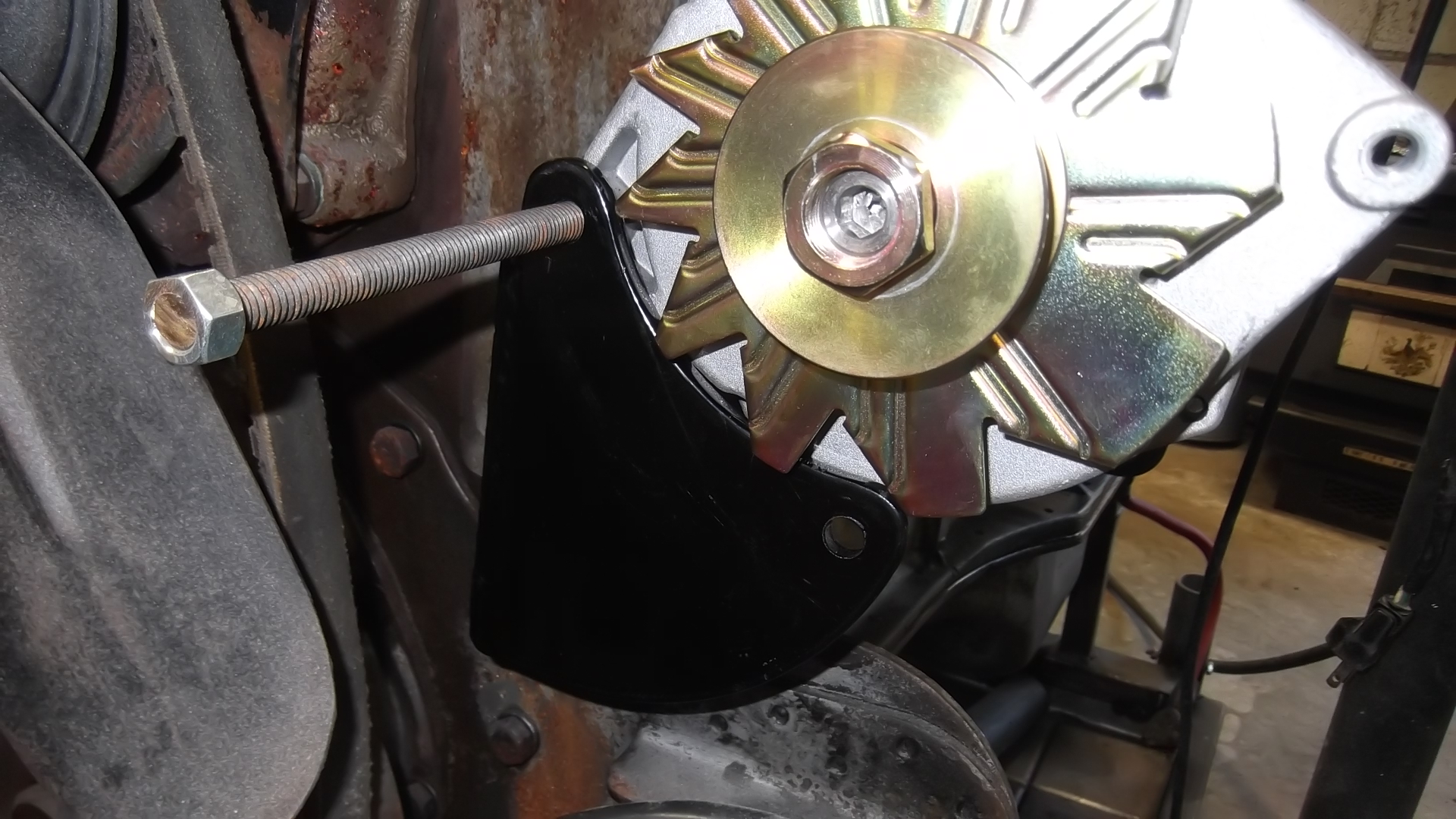

Ed Mueller's alternator bracket
Kerry, do you have stand alone pictures of the two pieces? email pls0
Looks good, Kerry!0
Good sturdy alternator bracket. Thanks for showing the pictures. Glade you figured it out. For those who do not know, Ed also makes A/C brackets and installs A/C systems in Hudsons.
