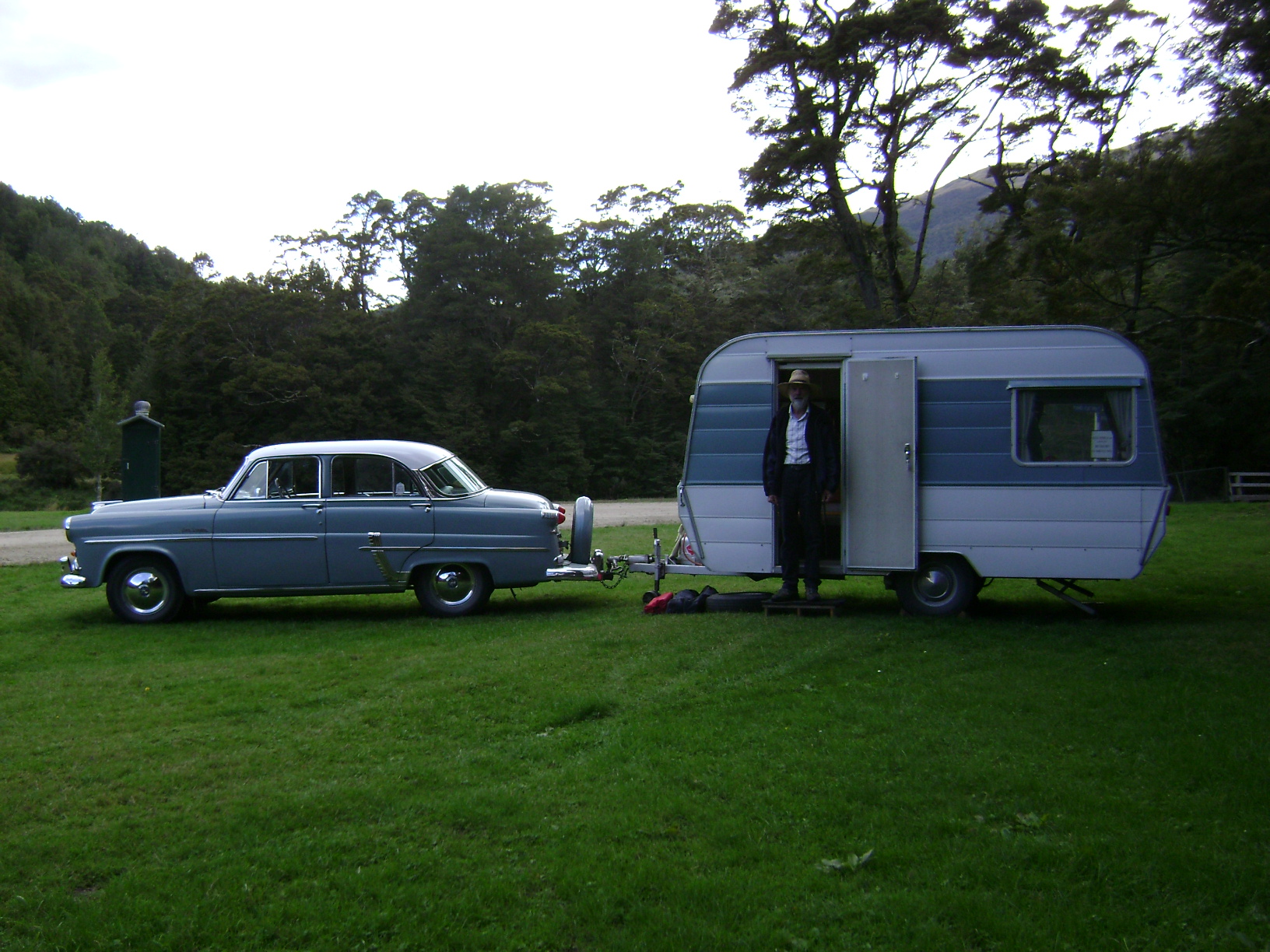

I tow our 14 foot caravan with my Jet, which has 4.1 rear end and overdrive. i can manage overdrive usually on flat, but a 'good head wind' needs direct drive A Step down should have about the same power to weight ratio, so would have no trouble handling that.Geoff0

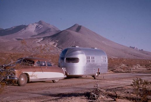

An old air stream behind a step down would be a very cool thing to see.0
We had a similar conversation a while back and I said I'd love to be able to tow something like an Airstream behind my 1939 112.As some said I'd probably get better performance towing the 112 with the Airstream

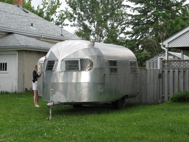

What year and length is that Silver Bullet ?
Dave Eddie
The trailer looks like a 22' Silver Streak (Clipper Model )around 1949-1952.I am working on one to pull behind the 48 someday if I ever get it done.Will need to figure out a good hitch for the stepdown.0
