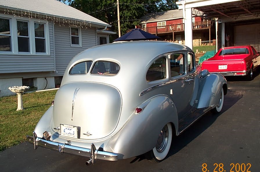

Working on a model 84, and need to replace the stop lamps. Workshop manual says to remove screw from top of lamp body, but there is no screw! Can someone please instruct me how to remove the lamp body or lens to get access to the bulb. This tail lamp sits flush on top of the rear fenders each side.

Geoff, are you sure these are the "factory" taillamps that are on the car you're working on?
Yep sure are - the whole car is original. Hasn't been on the road since 1963.0
Geoff, my 38 taillight has the screw on top and comes off as instructed in the manual.
Allan
Some Canadian Hudsons in the thirties had different taillights, so maybe those Down Under did too.0
Yes, the tail lights are the original ones. However I am beginning to think that somebody in the past has bogged over the screw holes. There is no screw in the top of the housing. Looking at the picture, it appears that the screw is towards the front of the housing, correct? when I inspect the car closely it lookas like the pint on the bulkhead is a slightly different colour to the rest of the car, so it appears that the car has been repainted at some stage, although it looks original. who knows after all these years. The car has been on blocks, under cover since 1963, and I am re-commissioning it. There is no circuit to the brake lights, so I am assuming the bulbs are blown, but I can't get the cover off to inspect them.Geoff0

Problem solved. Procedure is to lie on back, scrape away 77 years of crud, dust, dirt, run die-nut up threads of retaining studs, undo nuts, lift body off fender, invert, remove three bulb holder housing retaining screws, remove housing from body, replace bulb. Cut new rubber gasket to fit between body and fender as old one has disintegrated in the process, bind wires with insulating tape to cover threadbare insulation, solder ground wire to bulb holder , re-install bulb holder housing in body, re-install body on fender, fix ground wire to chassis. Only takes around three hours to do all this. Why didn't they just put a screw in the top like they did on the front park lamps? Probably because they didn't want to increase the wind resistance over that sleek fender!0
