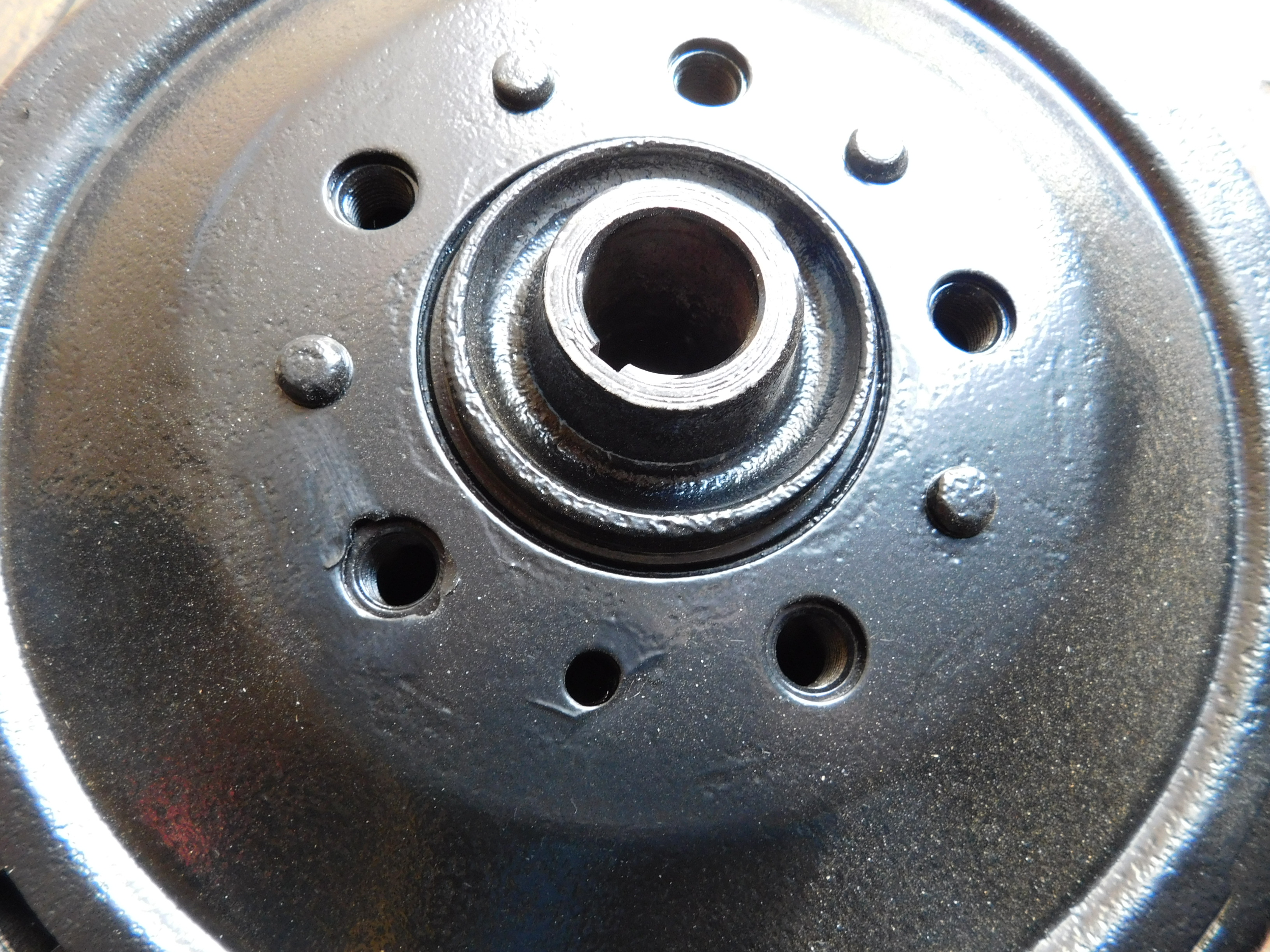

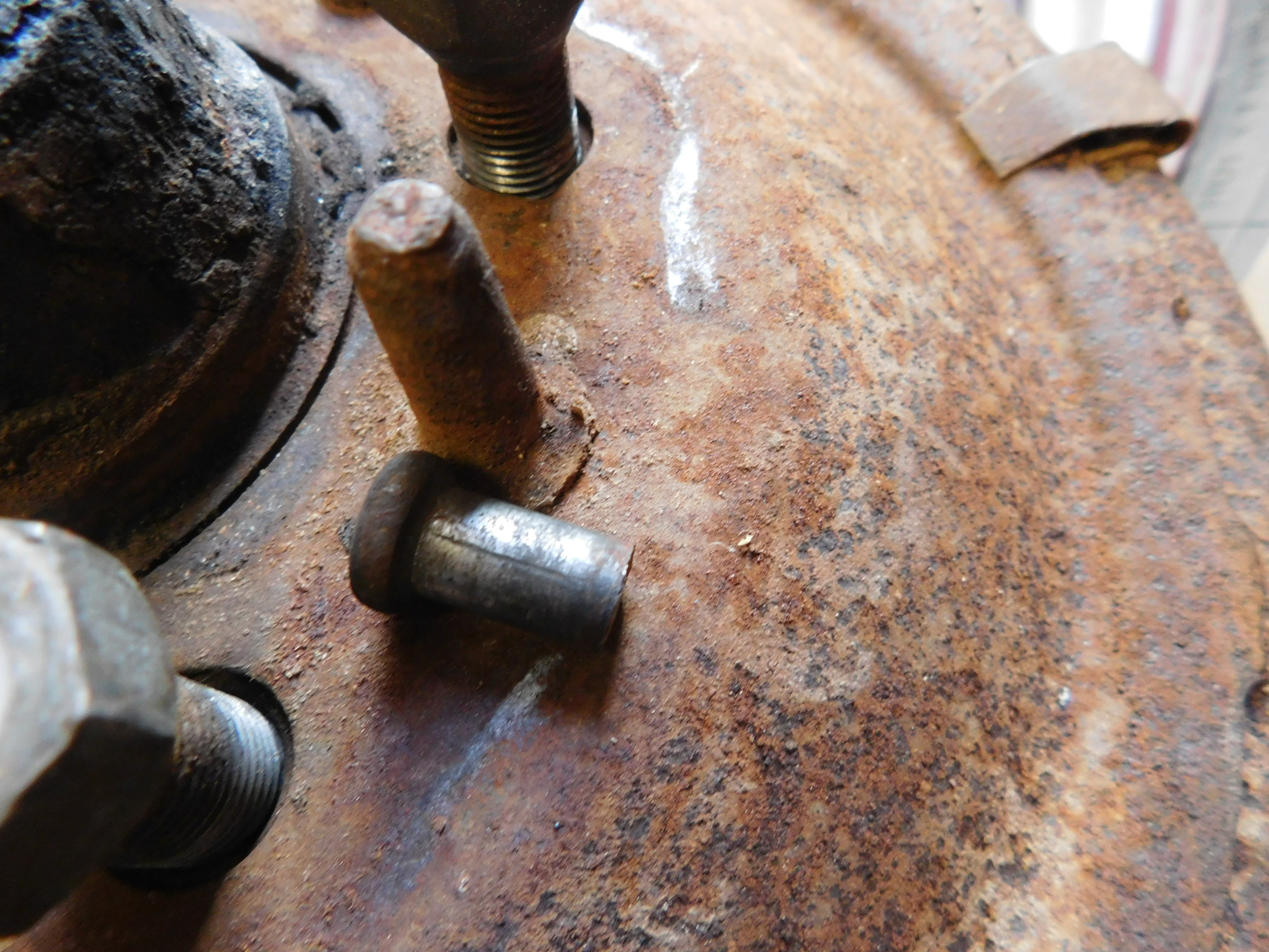

Any source for the Hudson drum pins?
These were swedged into the hub when the brake drums were mounted. They have to be
cut off when changing the drums. Is there a source for replacements?

In this case, it only needs to be installed to be functional to guide the wheel into place when doing a tire change.
All of these drums have been changed in the past and none have any functioning rivets as they were all cut off to get the old drums off the hubs for new drum installation.0 -

Lostmind, It's a customer's Hudson. I've done the exact thing you describe for personal application.0 -

I've turned my own wheel locating pins with a thread on the end that goes into the drum. Conveniently the hole in the brake drum that the dead pin comes out of is the tapping size for a 5/16" thread, can't remember if it is UNF or UNC.
So tap the drum, screw the peg in, peen the 2 or 3 exposed threads inside the drum to stop the peg backing out. Or I guess loctite would work just as well.
