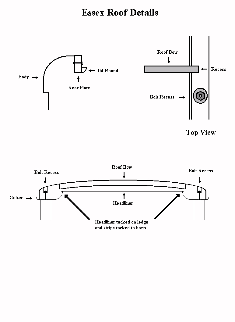

Thx ESSX28-1,That describes the way I had imagined it would have to be done.Do you know of anyplace that has pattern for making the wood frame and bows?I would have thought some company would be still manufacturing them parts as many essex cars that are still around.0
You need a band saw basically. Nobody makes these.Geoff0
Yes ernie 28,Thats what I'm needing,Where did you find the drawings?Are there any more with details for other parts?Geoff C-A band saw and someone with skill to use it.(smiles).0
I cannot remember where it came from. Maybe originally Geoff or another long time HET member. I have had it a number of years so glad it is of use but I have no others, sorry.0
