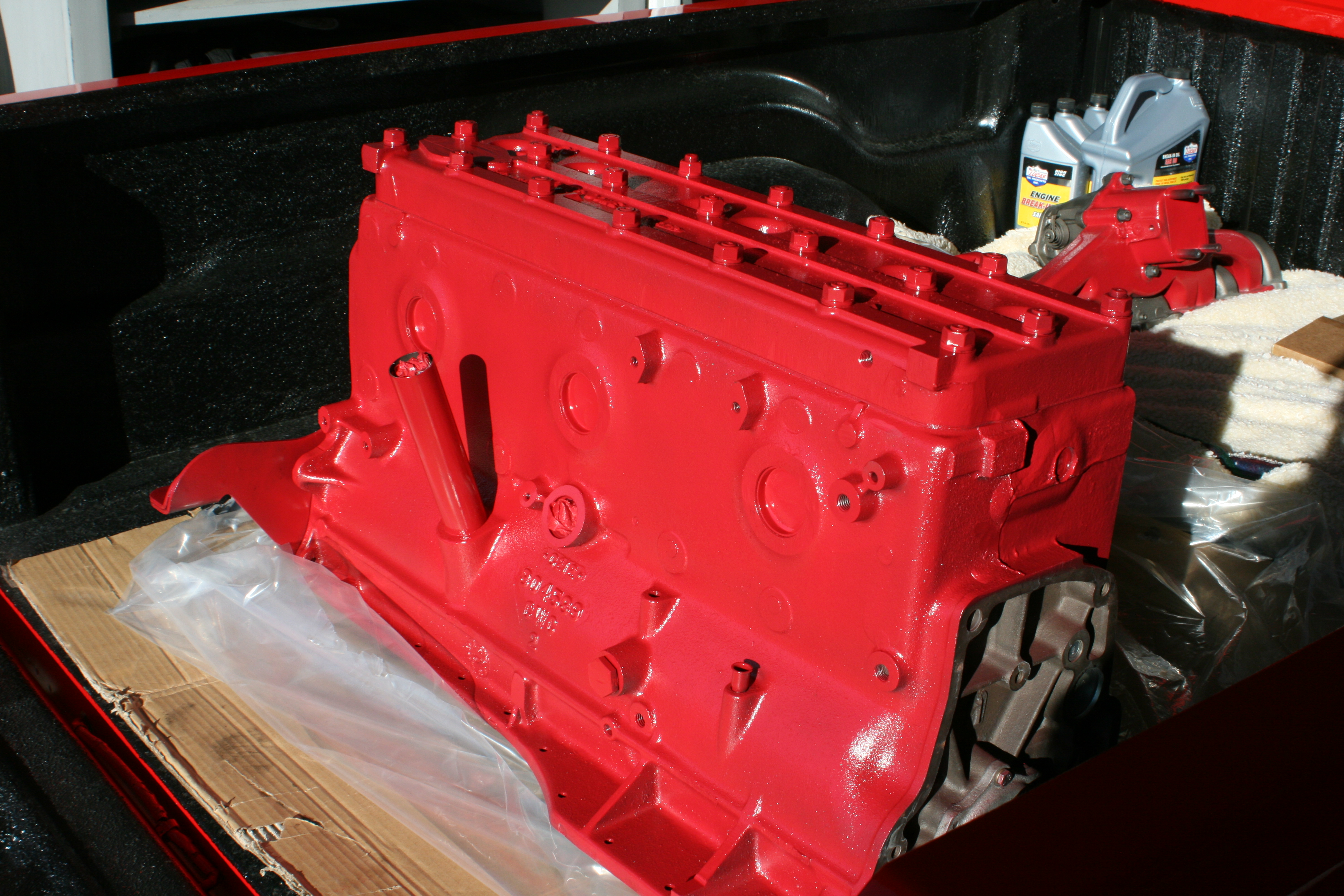

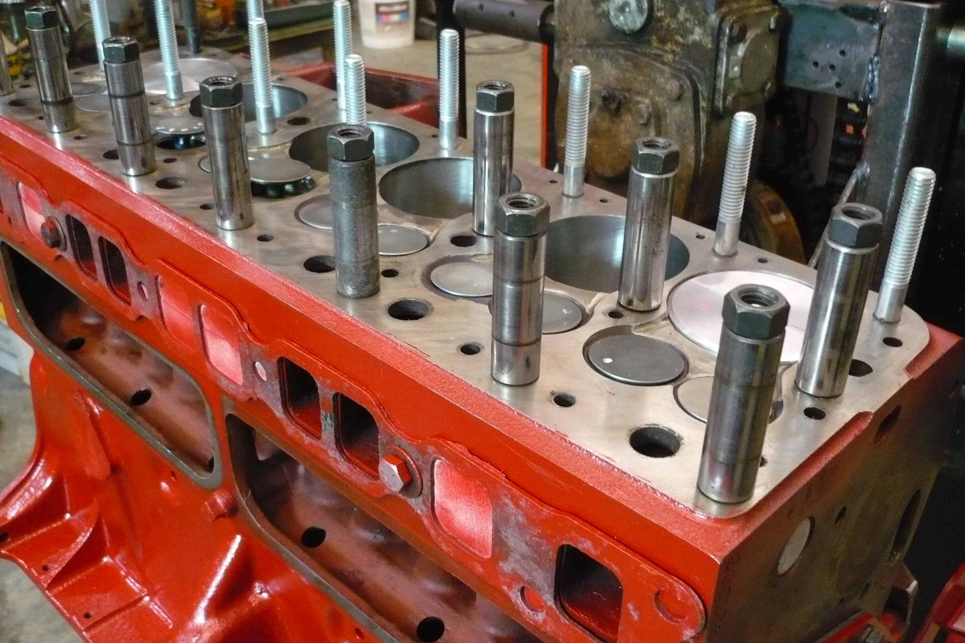

I now have the engine apart and we determined that we bent the rod that spun the bearing. Also, since there is a lot of clean up required for the crank we have located another one to take its place. I will be back at the machine shop in the morning to determine what the bore is going to be and then order parts. I have been speaking a lot with Dale Cooper the past week so the parts will be soon on their way and I can start the machine work. I will do a final pass once our parts get here. It is a lot of fun being back behind the controls of a machine--even if I question that I know what I am doing.
Since the engine is out, I have pulled the hood and fixed the broken spot half way across the air damn opening. I will paint the underside of the hood before it goes back on. Also pulled all the stainless grill and will take it down to the shop for buffing. Yes, I did detail the inside of the engine bay. I am not sure how one can have more fun.

Not sure what it is with my luck. Got the engine apart and started the build. There were some small cracks in the valve ports but they cleaned up with the larger valves to be installed. Next it was a bad crank, found one and got it machined and ready for build up. Then it was the cam. Got a new one on order. And, today it is the exhaust manifold with a big crack. Oh, well, this is fun--or I would not do it..... ya right!0
You are actually lucky to find the problems now0
I dont worry about minutr crackd... Perhaps consider a set of headers then build your exh fron there, ...Jet Hot Coated would make then last alot forteved. A Lot of power is lost in restrictive stock exhaust manifold....

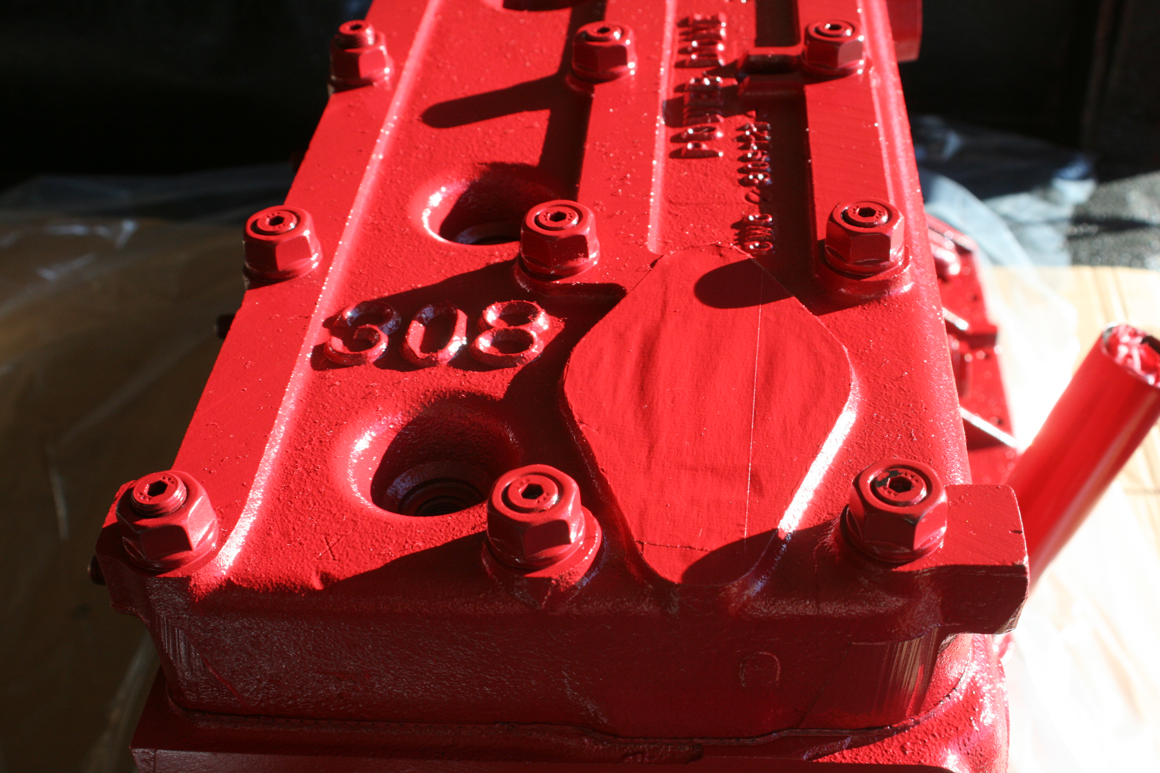

Have all the parts and will now start the assembly. Did notice that there was another crack in the manifold. Welded it up today. It will not be long now....0
AT LAST all the parts are inhouse or on the way. It became difficult to find a cam for the car; but today, Randy Maas put one in the mail for me. Among other improvements, (I.e. valves, rings, Maas Timing Chain, Al pistons, .040 over, ect, I have selected a Super Street Cam with 402 lift and 276 duration to finish up the build. Excited to get this car on the street. One or two weeks at the most. Not too sure on the math but with the .040 over this should give me about 320 cid. Not sure what the hp will be with machining, 7X valves and the street cam? Randy tells me that there will be no difference with the idle with this cam and a stock cam? Just more "Thump." By the by, this is all bolted to an Ike Smith tranny... My error, the cam is a 372/254. Just spoke with Randy and he saw my post and gave me a call.
