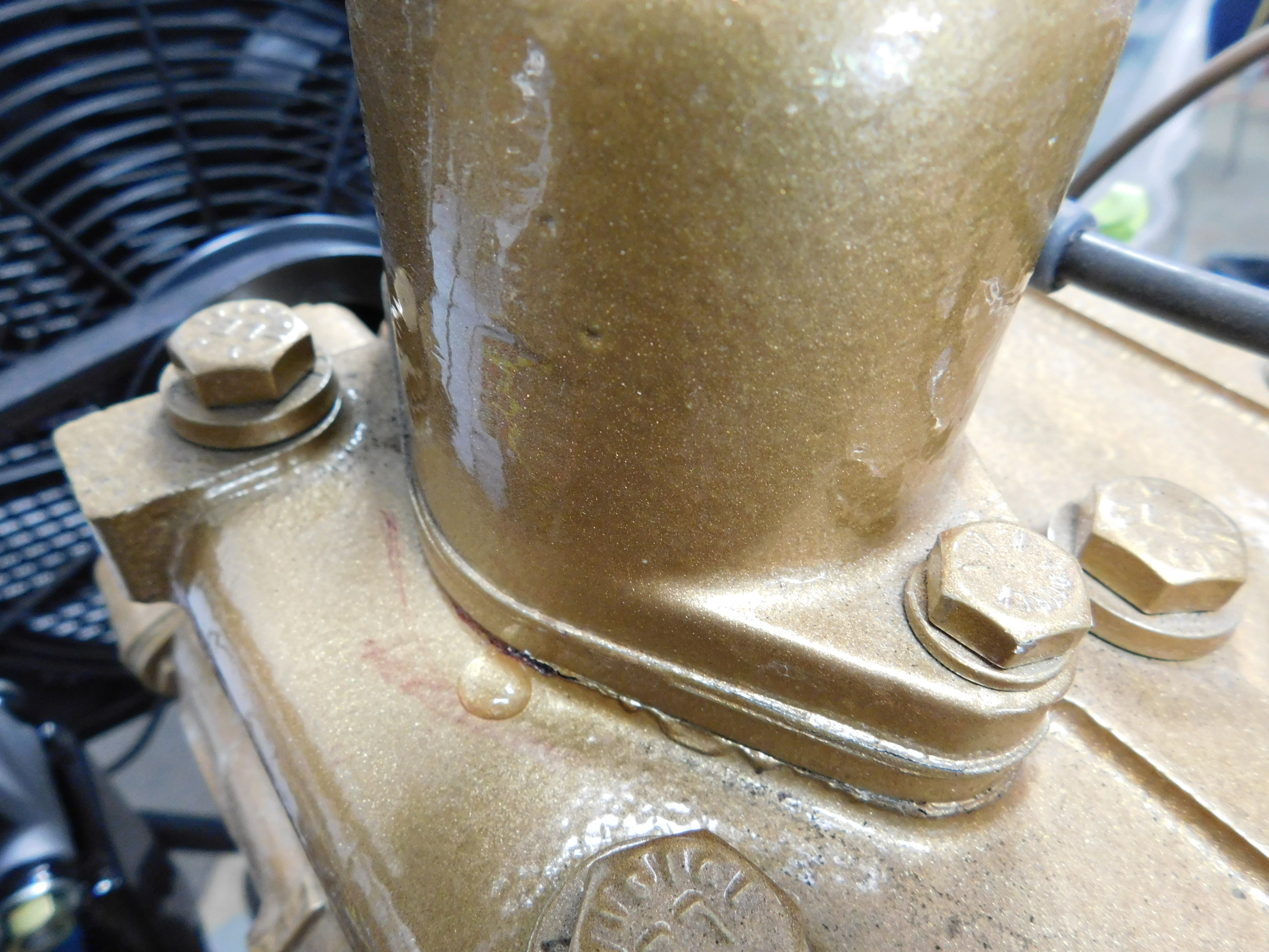

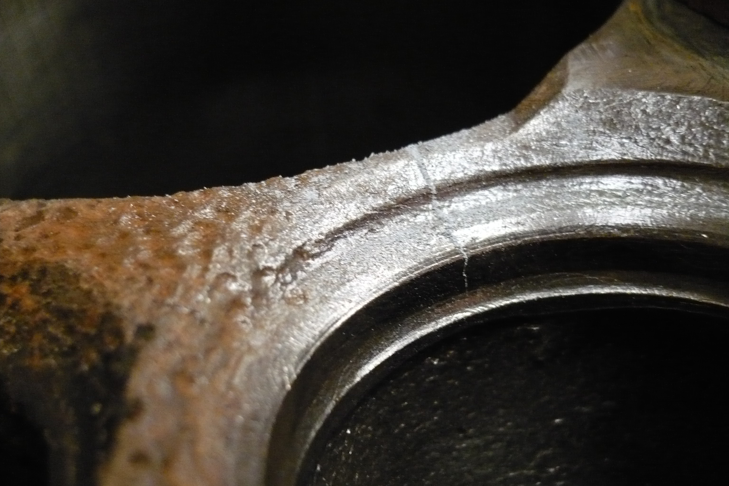

Looks like I have a crack in the 51 308 head on the engine on stand. Cracked below water temp housing. You can't really see it in the picture,
but a very find crack opens up at that spot in the head.

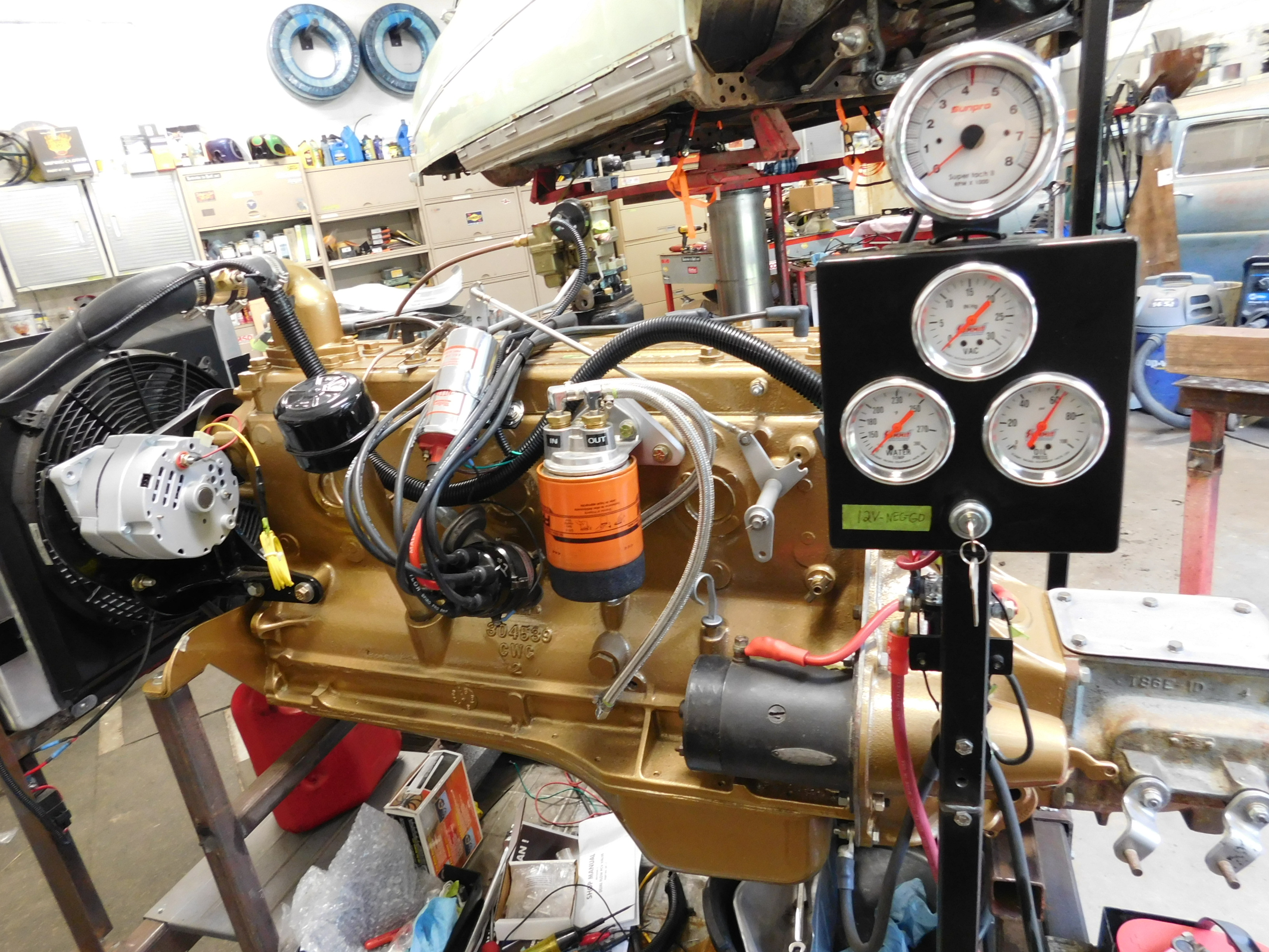

Just curious.....what's up with the ~65 PSI on the O/P gauge?
F

Frank, when I shut the engine down, the guage needle stayed there, summit sent me a replacement, waiting on it to replace that one.

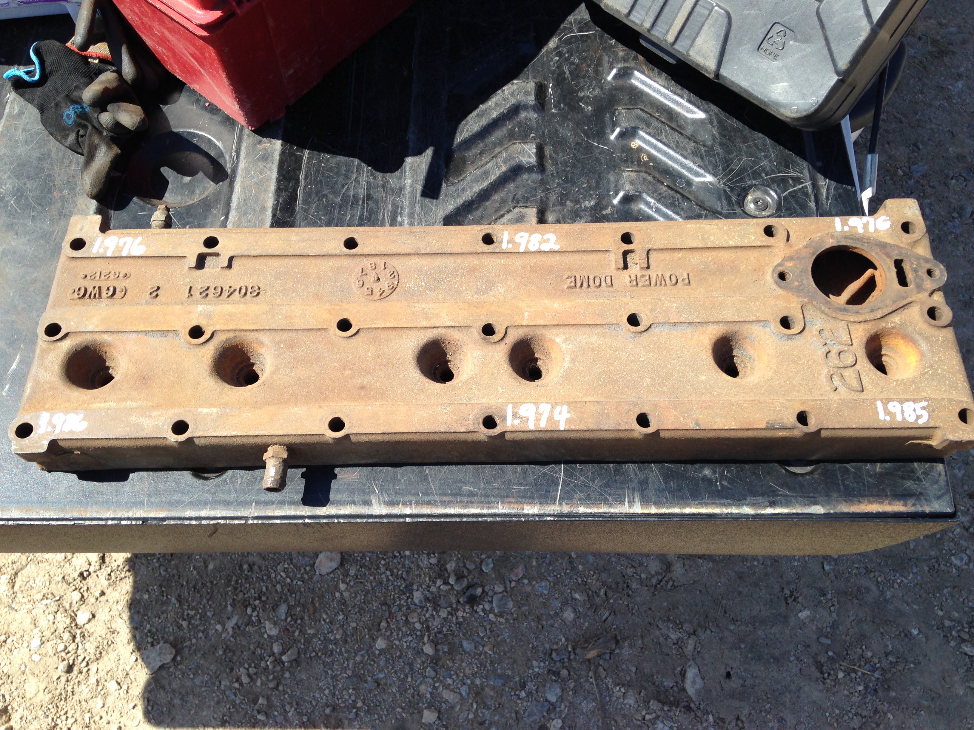

Ken, the one I got from Scott checked out at 1.95 after plaining, which is on the edge, I think 1.94 is the minimum. Wonder if anyone would make shims for these like they do for modern heads?

Have you considered doing a cold repair of the crack with the head where it is? I've used some of the Lock and Stitch products that would do the trick and you wouldn't need to disturb your work (except, of course, to remove the water outlet).
