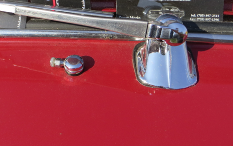

Does anyone know where I can find a diagram or instructions for installing the squirters on the cowl.
I need to know the spacing from the windshield rubber and wiper towers.
Here is a pic from a 42 showing the squirter.

The location of the squirt nozzle does not have to be precise, as the nzzles are adjustable !

I will try this angle then,can someone with these squirters take the needed measures and post please?They may have to be mounted in a certain spot so as not to interfere with something like the tower arms etc.0
it should be 3 in. from glass on inside of wiper arm housing MAKE SURE YOU LOOK before you drill for wiper arm assembly .So hoses don't interfere with linkage movement arms.Hope this helps0
