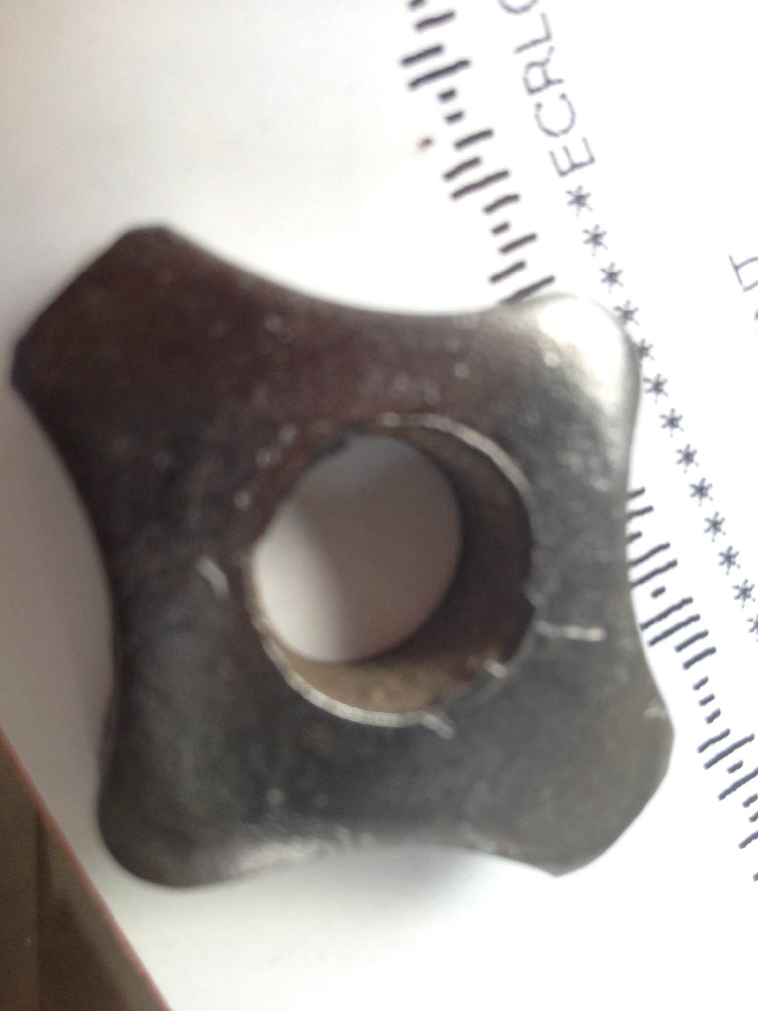

Anyone have or know where I can get them. The previous owner had used flat washers in place of about four of them and now that I have everything off, I'd like to have them all the same.

If there are only eight, I may be wrong and have enough. I'm not near car now, I will check tomorrow and get back.Thanks for your thorough responses.0
Well I have eight so I guess I'm ok
If six go across the top, where do the other two go? At two/one and six/five underneath? I assume all bolts get lock washers as well.
