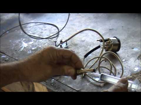

Delay is not a problem as I'm going on vacation as well. The tube twisted off at the two piece fitting going into the block. I was able to salvage the fitting that goes into the block, but the one that goes into that fitting was destroyed.0 -
Here is an article on repairing temp gauges and a Youtube video. The gauge repair starts about 2:35. Also there are companies that will repair your gauge.0

Mars55 has pointed you to the same article I remembered. http://www.ply33.com/Repair/tempgauge

Thank you guys; I will check out that video.Wayne0
https://www.youtube.com/watch?v=Z3GPn4rN9Nw
