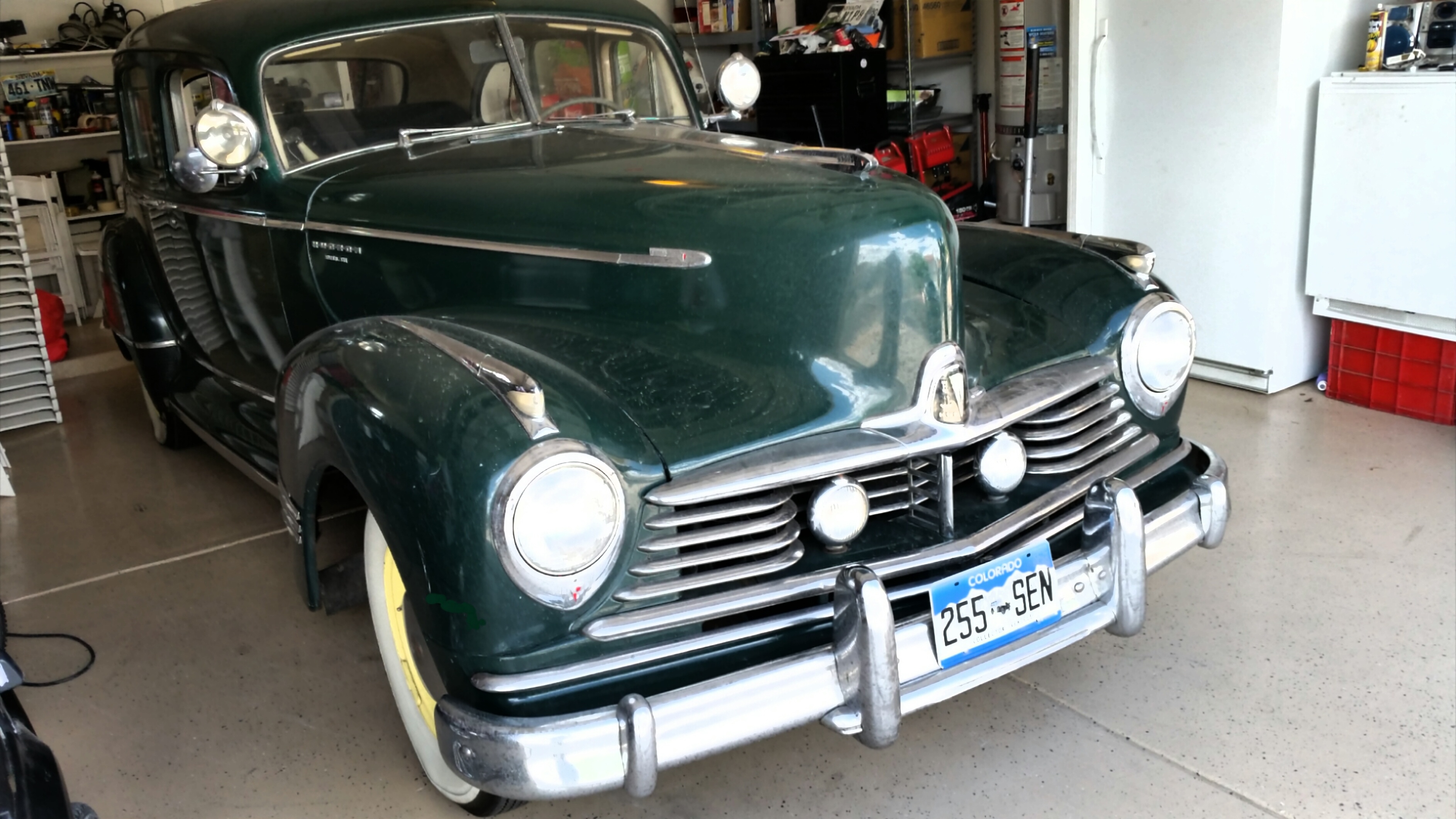

Hi everyone I need some input... I just aquire a 1947 Super 6 212 engine and with a drivemaster transmission. My issue is the engine has thrown a rod wich made a nasty hole with the rod sticking out. The drivemaster transmission works when it wants to as far as engaging the later gears on its own. However manually works great. My question is since I am going to replace and or rebuild the engine what would be my better choice? No I am not dropping a 350 chevy into it. I want to keep it either with the 212 if I can find one or upgrade to a 262 or a 308 and is this possible with little to no modification and how can I do this??? Any input is greatly appreciated.

Jon B thanks for the input. I have a 262 with a 3 speed with OD off my StepDown commodore I had. IfI can pop it in there with little to no mods I will go that route.0

I like the your car, looks good. The 262 with OD will fit nicely. Plenty of room. I pulled the Commodore 262 with three speed w/OD complete out of my 47 PU. Same engine compartment as your super 6. You will need to upgrade to larger radiator and shorten driveshaft. So your 262 engine with OD combination will make for a better cruising Hudson on the road to the Hudson International Meet next year. I vote, go for it.
It might be easier to drop engine in first then connect transmission. I was to lazy to remove the floor pan over the transmission when I pulled engine & trans.

Lee O'Dell... I thank you for the great info if all I have to modify is the driveshaft that is great news!! I will make the radiator larger it has a custom shroud and fan already. I had an issue with my 49 commodore as far as overheating especially living in Las Vegas Nevada I learned that very quick.0
