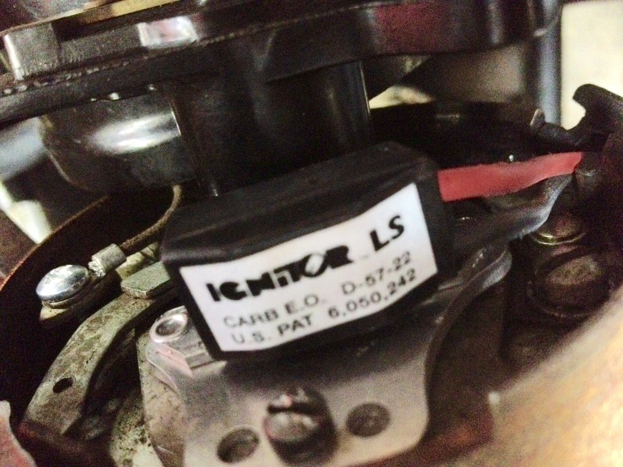

I did put a small module about the size of a circuit breaker and it mounted on the posts(knobs) of the condenser. But there was no magnetic ring like other units I've installed before now.

Photos please
The ignitor electronic ignition unit that I installed was 2563LS , as I said, it only has a module with the two wires, no magnetic ring on the shaft. I'd like to contact Pertronix tech dept but they're in California and not awake yet.

Your photo is of the inside of the distributor showing the pickup mounted on the "breaker plate". It must be sensing something, so I assume there's a magnet ring on the cam to provide the mag field to sense. Pull the rotor off to see what's under it. It should be the ring to which I refer. If not, I'm out.
For what it's worth, you can't simply install the Pertronix parts without re-setting the timing to match it. It should be close, but won't necessarily be correct.

Waiting for pertronix tech, but one thing to point out....this is called a lobe-sensing unit, so it may not require the magnetic ring. I'll let you know what they say. Thanks for your interest and suggestions.0
Hmmmm. Ya learn somethin' every day.......I can shut my brain back off now. Is this a new innovation or something that I just haven't bumped into before now? I'll assume the "LS" is an indication of the "Lobe Sensing" design feature.
In any case, the timing must be reset to the new device, but I'm sure you did that as part of the installation.
Lobe sensing, huh? I stand corrected.

Tech said the timing probably was off but not necessary to do more than turn dist, no need to pull and point to #1.He said first I ought to run wire from battery pos post to coil pos so I am sure its getting enough voltage.I hooked up wire, unbolted dist holddown and turned it counter clockwise at small intervals...result: unable to run continuously and still muffled sound to it.Turned dist clockwise small intervals... result: unable to run at all.May have to find TDC despite tech's advise....tomorrow.He also said it should not have a magnetic ring because it is "lobe-sensing" and it is the proper unit for my '49 Hudson 262.Anyone ever encounter this type of problem?0
