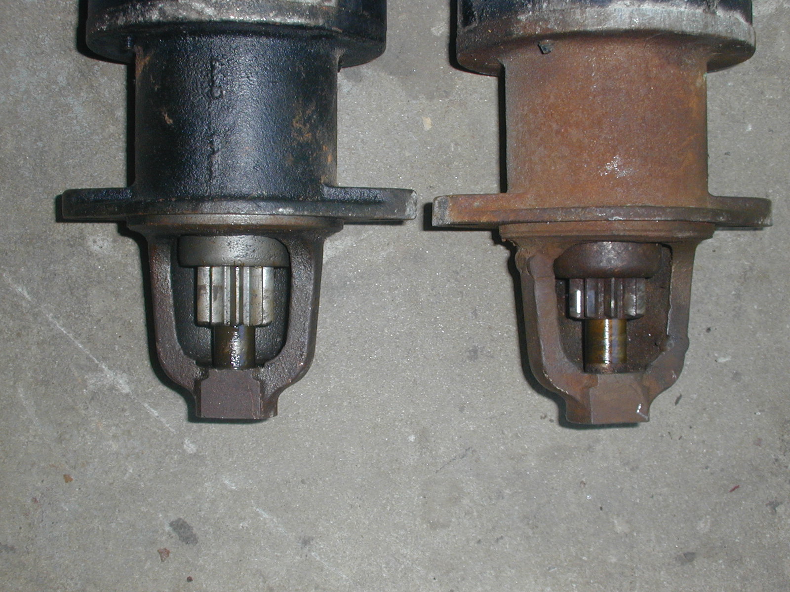

Thanks for the replies. I suspected it was a bendix problem. I did use the same bolts to mount the starter that were used before. Doug Wildrick did mention in his tech talk in Colorado on conversion from 6 to 12 volt that the new bendix is less than desirable at times. If I get no solution to my problem, I might be able to find a good used bendix for a hyramatic starter. I HOPE!0
Ken, With all due respect that is not the Bendix you want to use. Please don't use a Ford Bendix. The teeth are longer on this Bendix and do not dis-engage upon starting. It's a mess. Plus once it's on good luck getting it off. Too big to work off easily. It's a nightmare. There is a current Bendix available for hydramatics from NAPA it's part number BK 656 1085..They are rebuilt but they will work .0
Lance is spot on and yes the starter will spin with the flywheel until it dies. Takes a while but it will die. The Ford bendix just adds drama to a crappy situation.0

Here is a comparison of Ford and Hudson starter drives .No doubt these are NOT interchangeable.0

Well we all learned something about starters , good photo comparison of the drives.
