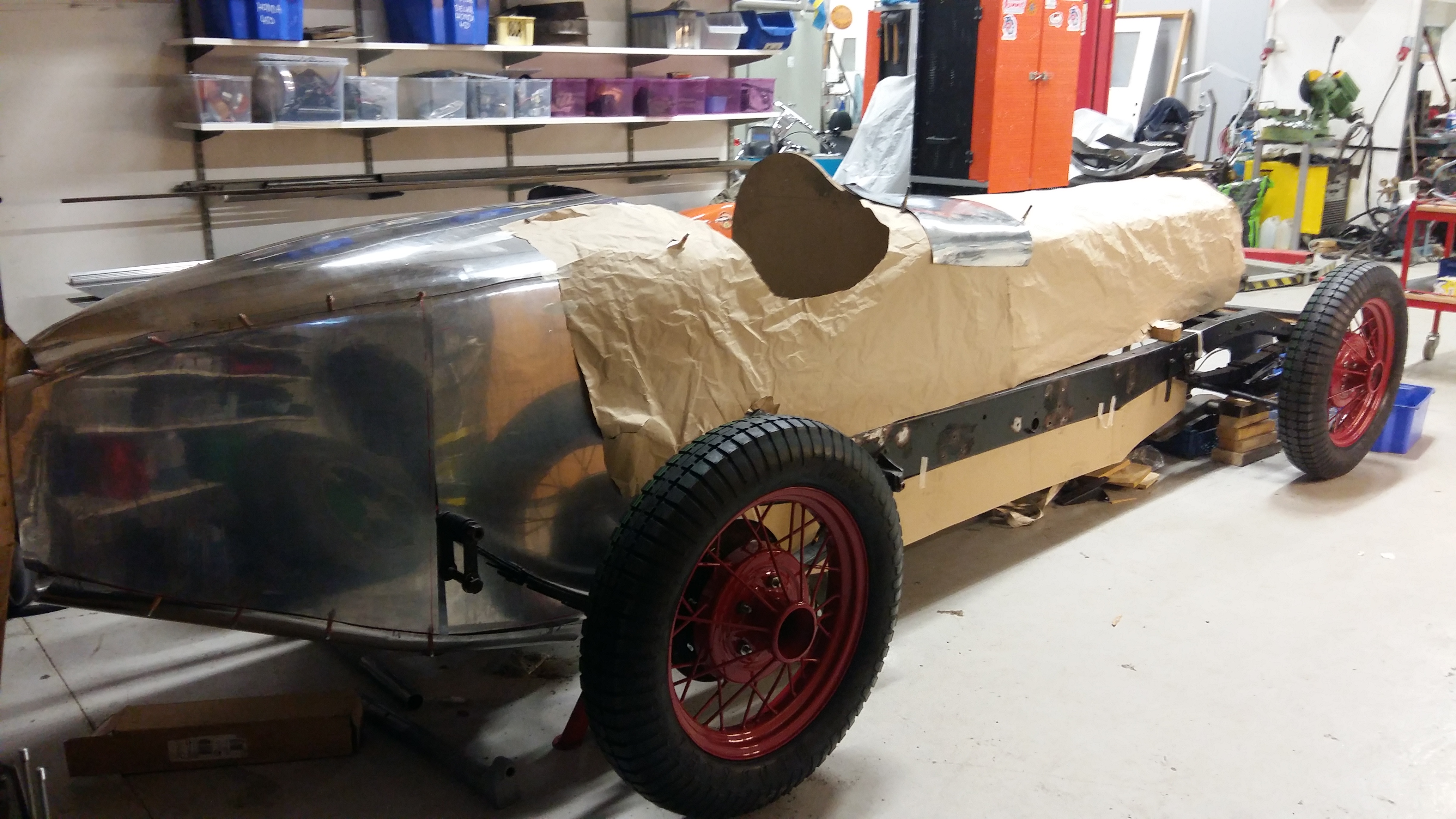

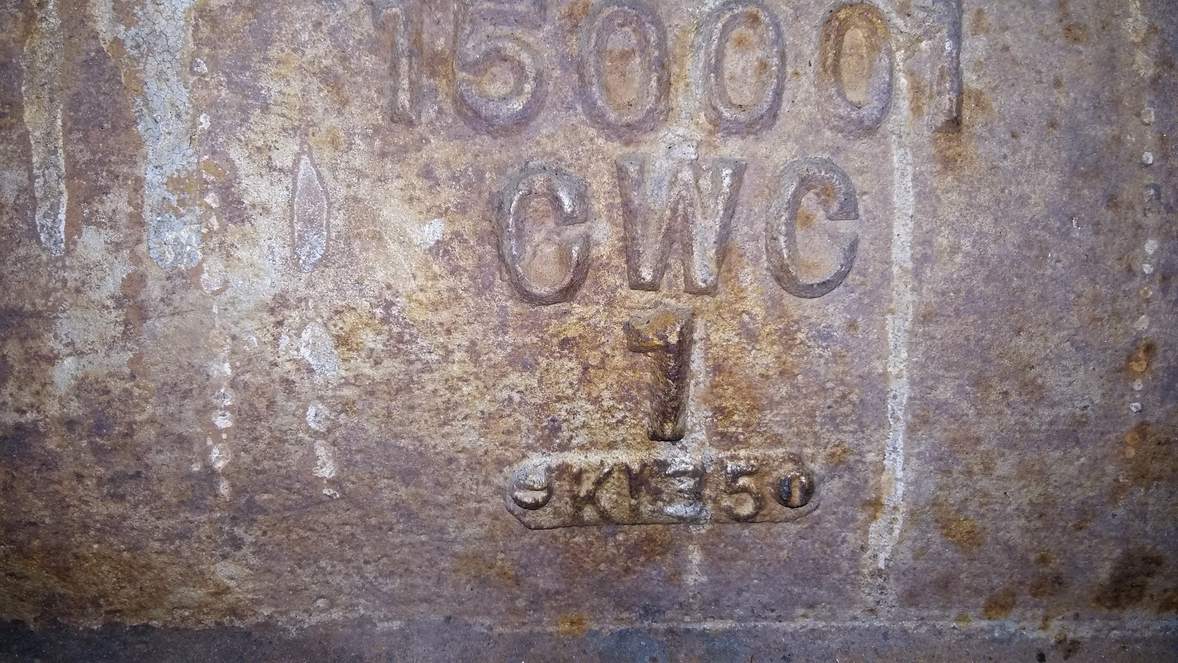

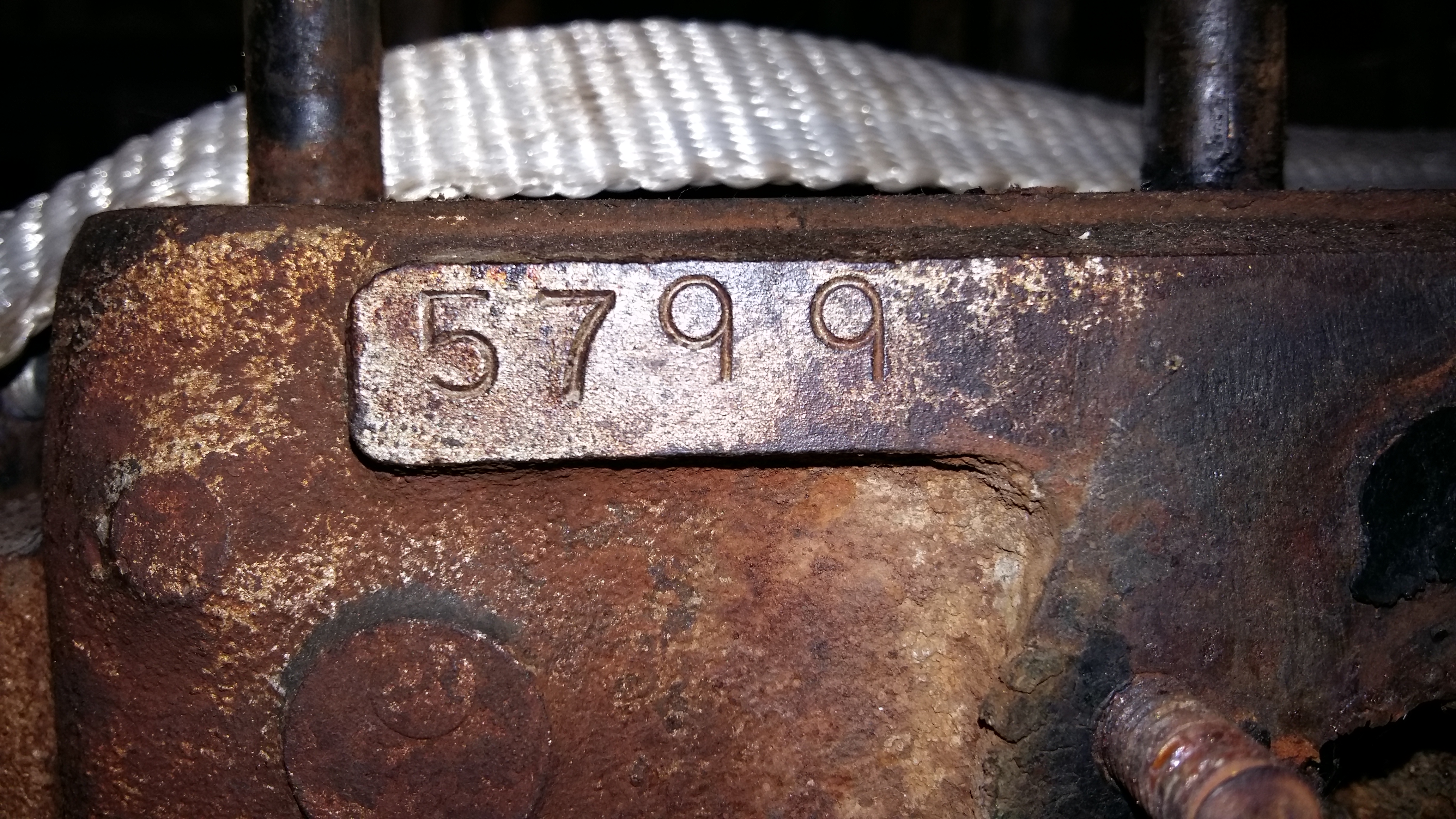

Can someone help me to identify the straight eight i bought for my racecarbuild so i can order right parts for it. I cant find any number in top of it between 7 and 8 exhaust valves. The only number I can see is the castingnumber and a number front left, see picture. The frame is a Essex 1930.
That number would indicate a 1930 engine, but a pic of the complete block would help to identify it.0
150001 is a 1936 Hudson 8. The casting date translates to Nov. 13, 1935 which is logical for a 1936 model year installation.Hope this helps,"Ric"0
