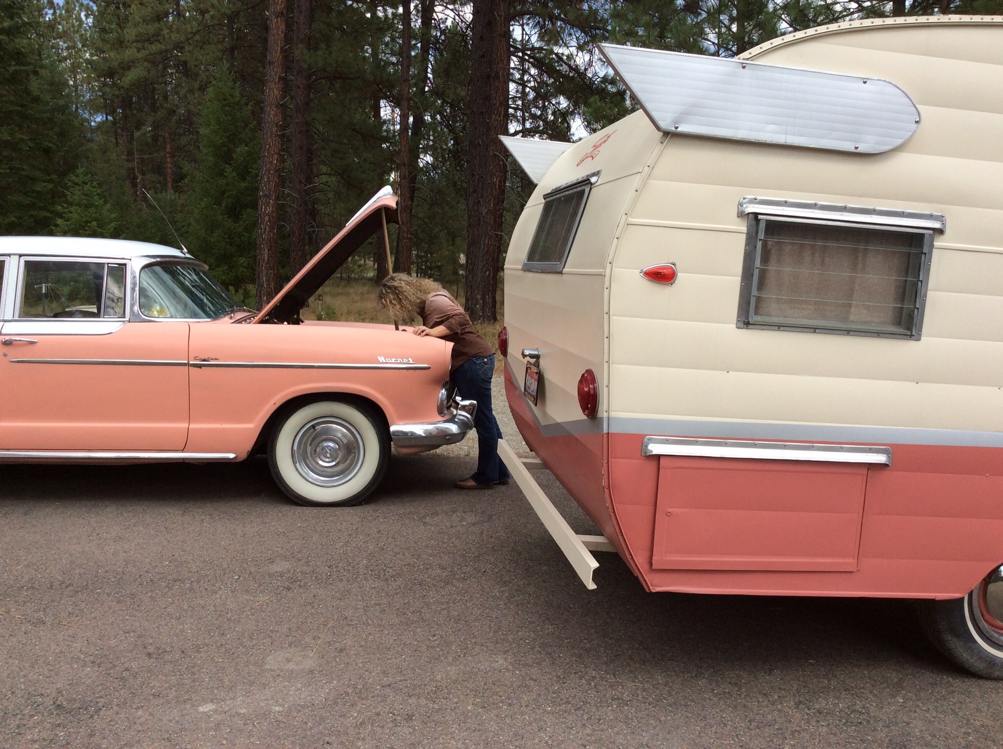

Our 55 Hornet automatic transmission has started making noise and chattering after driving, when warmed up...
I'm about to service it but have little hope that will solve the problem. We plain to pull our 1959 Shasta Airflyte camp trailer next spring, so now's the time to go through the transmission. Where is the best place to get parts for the transmission? Thank you for any help and advice!

Looking at pics of your beautiful car,I noticed it seems to be a V-8. This would mean you are dealing with the Packard Ultramatic. Much different from the Hydramatic . Will need someone who knows these Packard transmissions.Good Luck,"Ric"0
