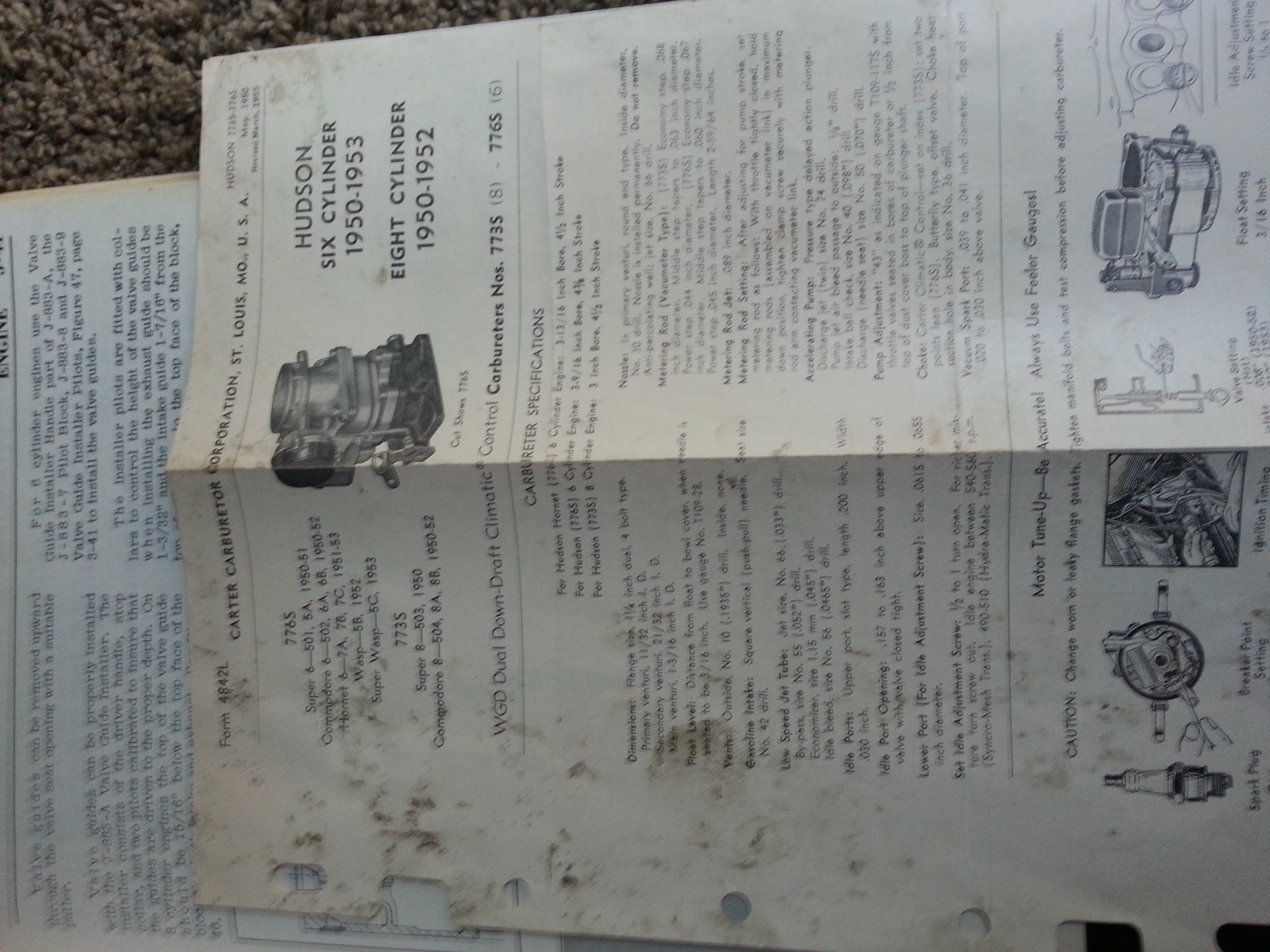

  • Actually just remembered there's one in my hudson manual
  • Tried getting them to pop up but it says direct link to page not allowed when I try to open them
