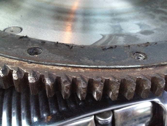

My 1948 was running 12 volts on the 6 volt starter. The starter ring was badly worn, probably from the hard engagements. I've now bought a starter with 12 volt field coils installed, not tested it yet though.
I converted my 6 volt starter with 12 volt windings. Eliminated hard engagement problem and starts on 1st revolution.0
I've never had any problems with mine after I switched to 12 volts on my 52 hudson wasp 262 six cylinder0
The hard engagement is problem #1 and #2 is you can't grind on 6V starter on a 12V system for very long or you will burn it up. If your engine is tuned properly, you can get away with it . . . at least for a while. This is for Standard transmissions.Should never run a 6V starter on a 12V system with a Hydra-matic. You will eventually break the nose cone on the starter and as far as I know there is not a replacement (except the cone from another starter). Yes, I know, there are those out there that have run them for years, and so have I, but I assure you, eventually, sooner (if not later), it's going to be a problem. I've got 4 or 5 on the shelf to prove it (I broke one of them, for the record).I've got a 6V starter on the convertible right now, in fact (12V system) and it works great. I also just got my 12V starter completed and it's sitting on the bench waiting for me to swap it out.Surely there is a less-expensive option, but a local shop here will do a complete rebuild (with whatever field coils you want) for $289, which makes me wince. I remember paying $20 for new starters all day long. Those were the days! Anyone knows of crossover parts that work, I would like to hear about them.0
