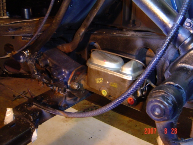

The Disc Kit will fit your '37 by interchanging one of the bearings with the later model Hudson. If runing stock Motor like Uncle Josh stated wont be necessary. I just bolted on later model larger Hudson backing plates, Lining, & drums .
Additionally, I made a 1/4" steel Triangle adapter at home to bolt a Ford Torino Dual Master Cyl while retaining the stock Hudson Emergency Brake System (even though it wont be needed)..
A few guys have machined an aluminum 5/16" adapter in a Bridgeport. The Adapter counter sunk bolts to the stock bracket but adapter is slightly wider to accept the two bolt Torino M/Cyl. The Hudson Clevis is retained by threading onto the Torino pushrod then adusted for free play....
The only negative is filling the M/Cyl... However its never needed refilled in yrs. Filling would be simpler with a cheap 'remote Fill Kit'.

That's the kind of information I was hoping for. Know I can see how it will work. The engine is out so this shouldn't be too bad.
