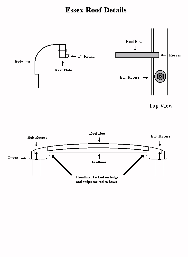

Please can someone help, I am in need of a wooden roof frame pattern/template for my 28 Essex Super 6.
A previous owner of my car re-framed the roof and made a "bags" of it, it is currently about two inches thick over the windshield.
See my profile photo.
Does any one have a template or could someone supply dimensions on a sketch of the framing from old timbers they have replaced?
Any help/advise appreciated.
Thanks
Steve
Thanks very much for the sketch ernie28 that is helpfull.I am also looking for the profile/section through of the frame above the windshield, its junction in the corners above the A post where it meets the side rails and the profile of the side rails to get an idea of where they start tapering down their length towards the A post (if that makes sense)?ThanksSteve0

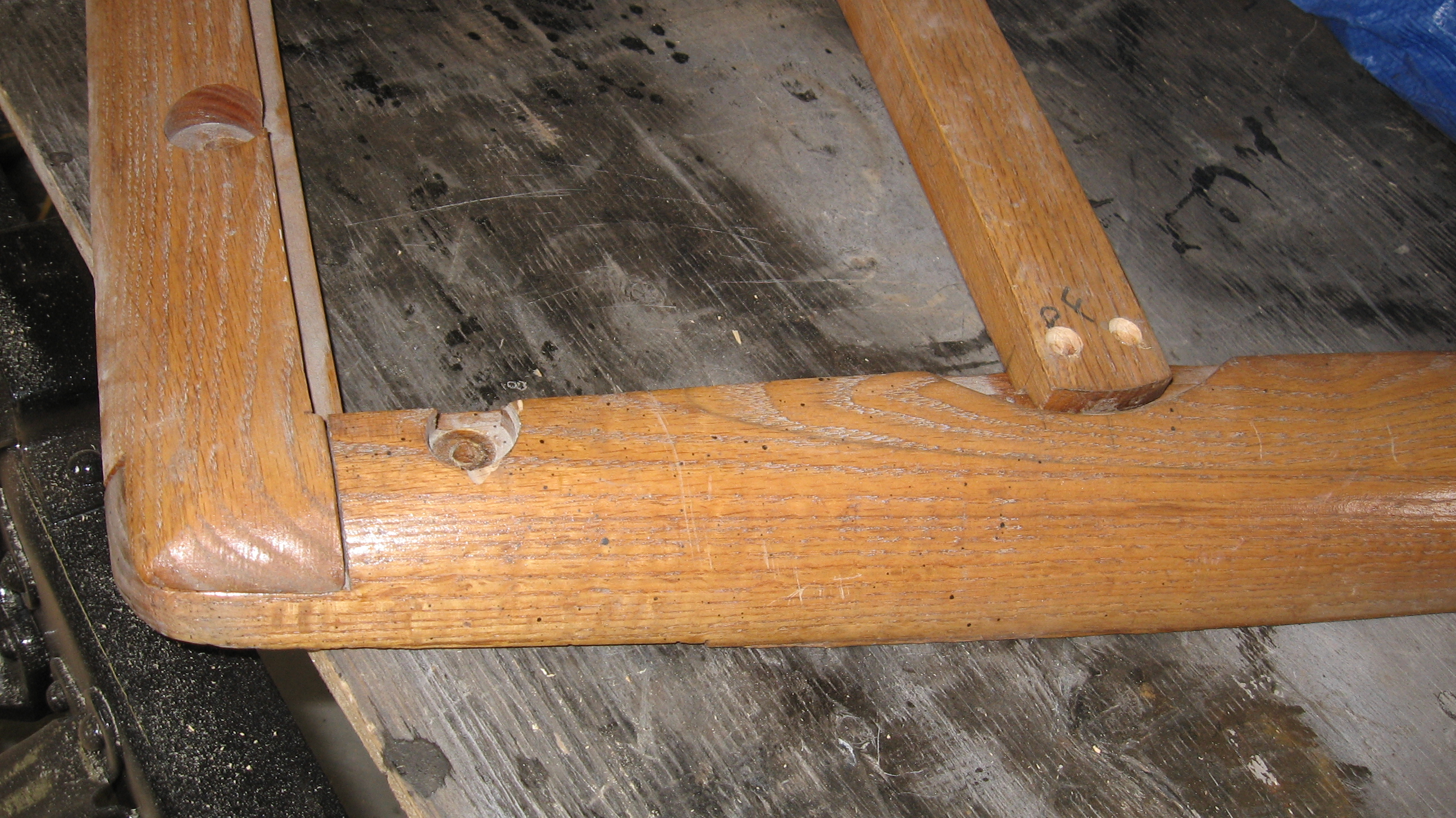

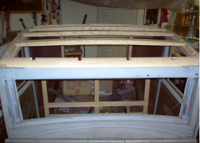

Paul thanks a lot.If you find more photos, please post them.If anyone has sectional dimensions that would be helpful.RegardsSteve0
