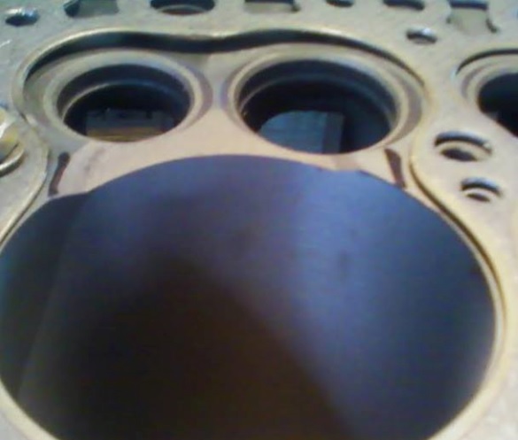

Certainly when someone does valve reliefs the compression ratio is dropped. How do you get the ratio back up ? Mill the head/special piston head? Oxymoron?? If you can't do more than clean up the head surface and no one makes special topped pistons, why would anyone relieve?
Just curious~~

There is a fine line between Relief & Compression Loss on a Flathead....Relieving to 7X depth greatly improves breathing when installing larger valves, performance Cams, etc. Compression is brought back by block modifying. However, these Mod's are not really necessary for a Street Motor
An easy Mod is to install a 262 Head raising the compression while not choking the Mtr like a 232 head would since true 7x Mtr's used a 'Spl Modified' 232 Head) .. Installing a 262 Head on a 308 has been done for Yrs.
