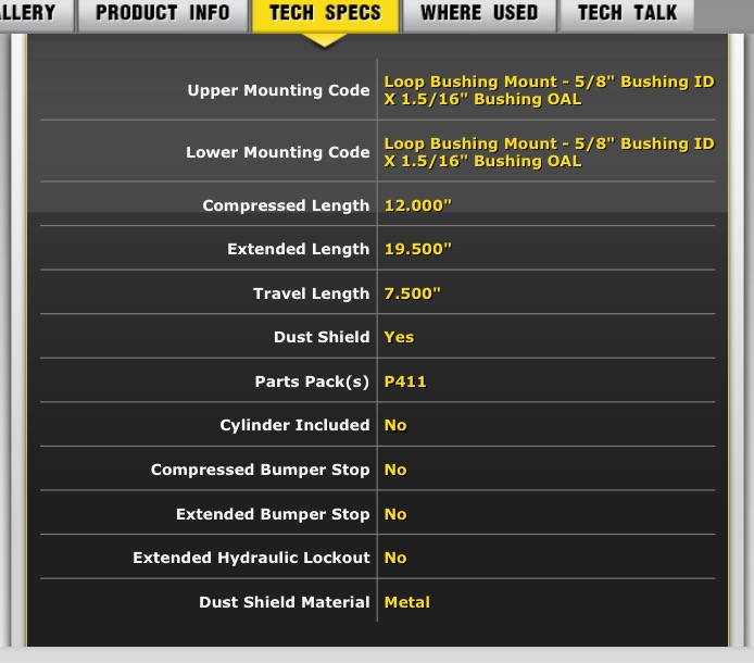

The shock doesn't travel very much. as in the attached sketch..which I can't attach. What gives?.
