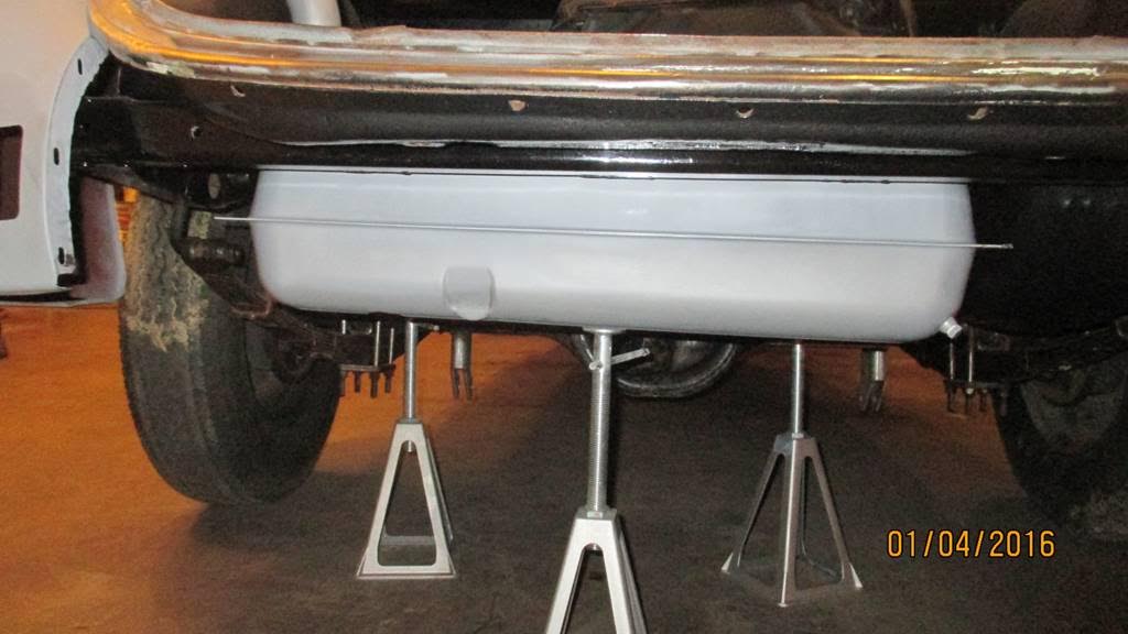

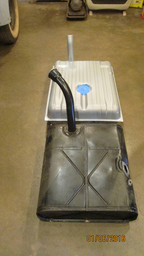

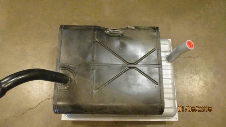

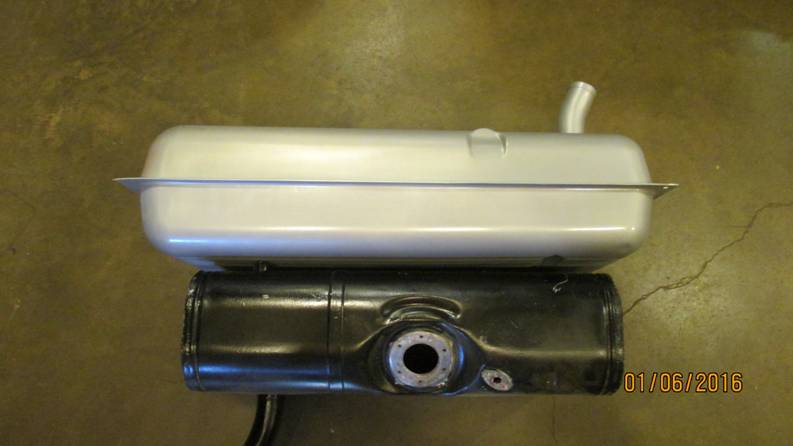

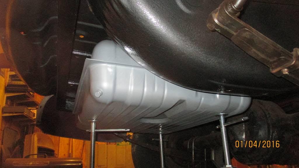

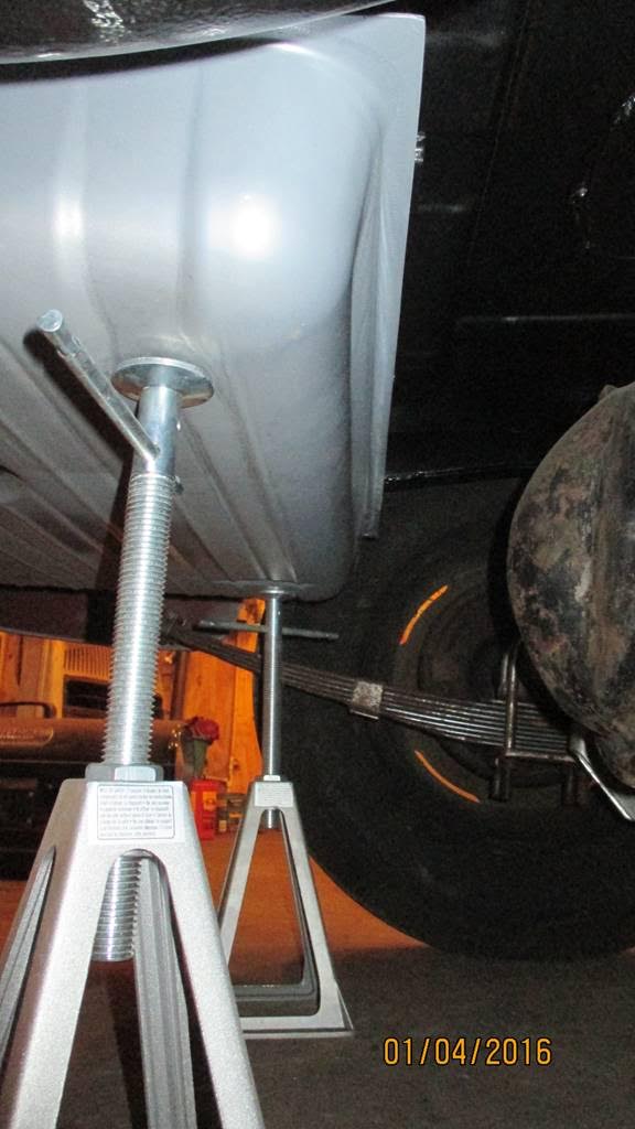

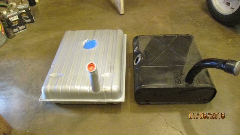

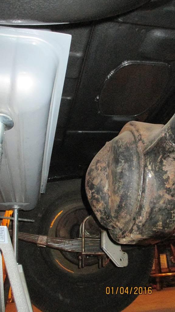

More pictures from Dave, comparing the two gas tanks...
Thanks a lot, Dave, this will be of help to those with older tanks which have rusted out. Looks wider than the original, maybe a tad deeper, and about the same length from front to back.
Looks like the filler pipe from the old tank could easily be welded to the new tank, or possibly a new one bent from steel tube.
Where does the gas line attach, and is it a similar fitting on the new tank, as on the old? Where does the gas sender go? Do they both go in the blue area on the new tank?
The price of the T-bird tank makes this cheaper than a Gas Tank Renu overhaul, but on the other hand you then have to weld on a new filler pipe and maybe a pickup tube with the correct threads for the gas line. Also, the fuel sender arm might have to be bent into so strange shape, to fit the new tank.

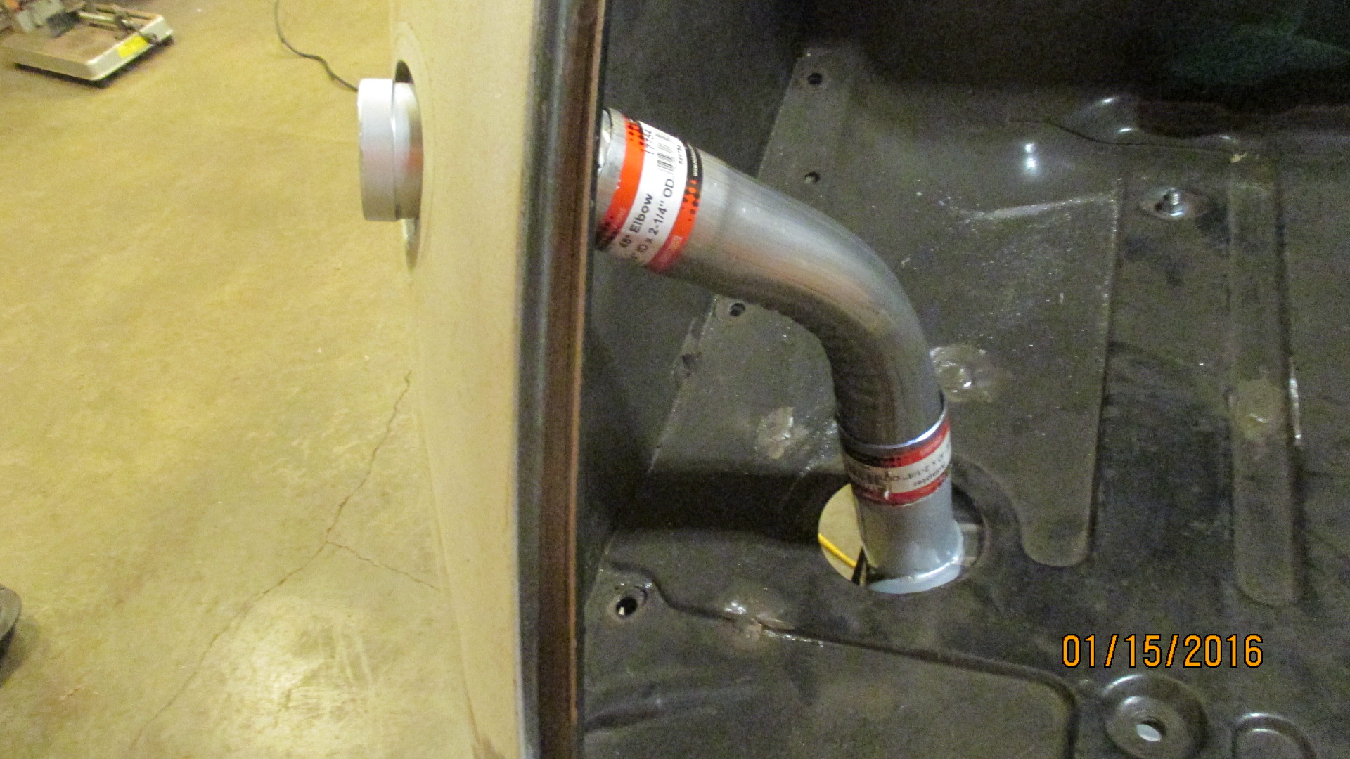

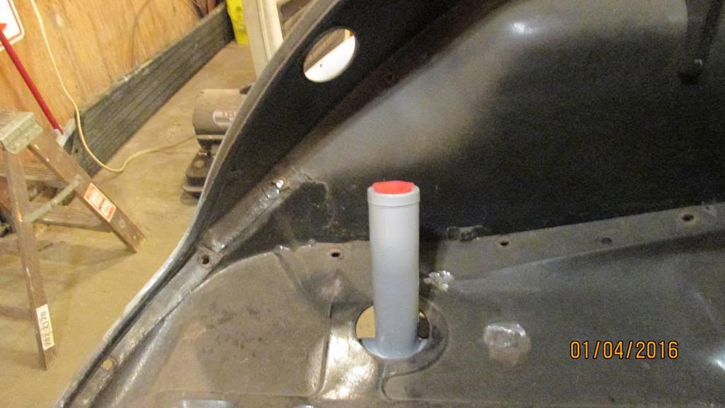

The ReNu Process in my area is over $300 now so those minor additions to utilize the Bird tank' would be helpful to people on a budget and not buiding a Show restoration. The Filler tube can be solved by installing a elbow hose using the original Fill pipe ontoTBird tank. A better pickup can be brazed into tank (Before fueling) since the screw on pickup are prone to leaking. Just saying....
Definitely more doable for a modified Hudson. The Fuel pickup is on the short side opposite the fill neck just below the seam. (what were they thinking!?). It can be seen in the 3rd picture just barely.As Ol Racer says I will need to put a real pickup in it, especially since my "twin H" (dual 4BBL 500CFMs) will need a 3/8 line to keep that beast from getting thirsty.I will decide once the tank is securely mounted whether all steel or steel/rubber/steel becomes my filler solution.0

Hey Rocket,Wondering if you kept the original exhaust system routing? Any problems with the pipe running next to the gas tank?
Also what did you use for the fuel pickup tube?
