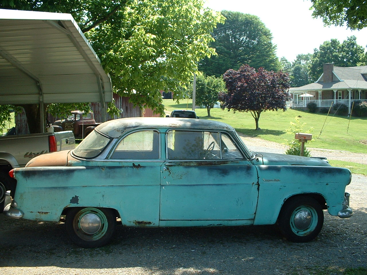

Thanks db. There is no hurry. I am taking that engine to the machinist soom. I have it out and apart ready to go. I have a spare engine I bought. I am going to put it in and see what condition it is in. It was was a running twin H engine. I am putting it in with a single carb. to see what condition it is in. I am working on mechanicals mostly. A lot of the side glass is broken or cracked. Will try to post a pic.0
Looks like a very straight car. I have found a couple of Jet parts cars that I may end up buying, so if you need any parts let me know. David
Thanks db. I don't have a parts Jet. LHud0
