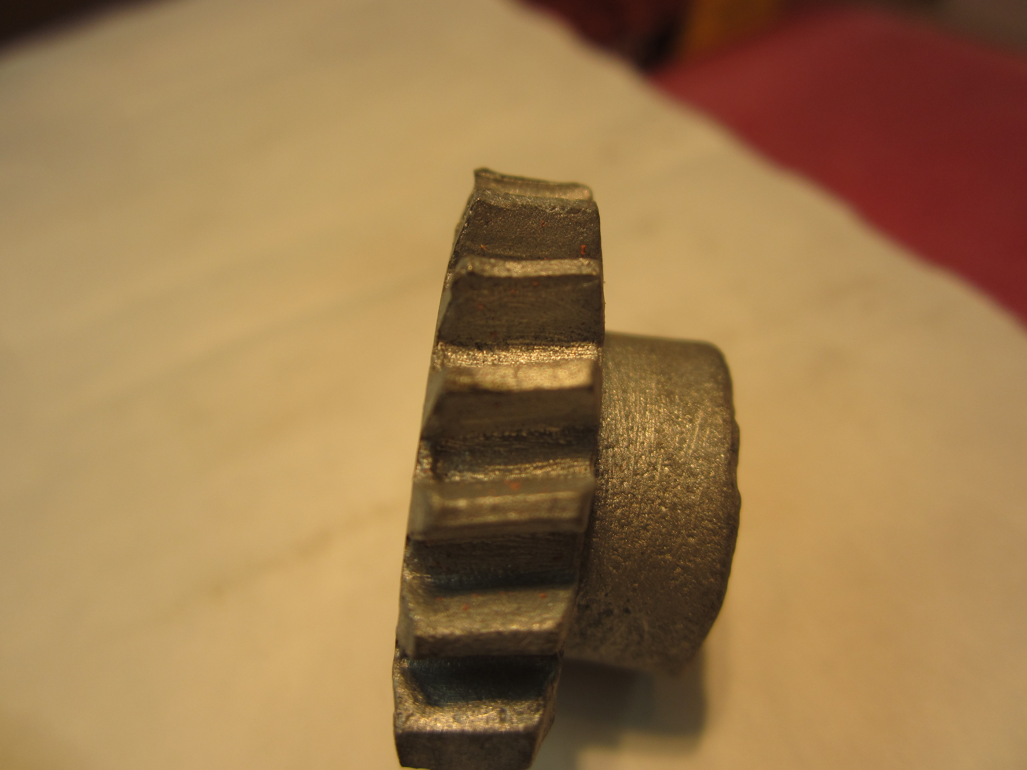

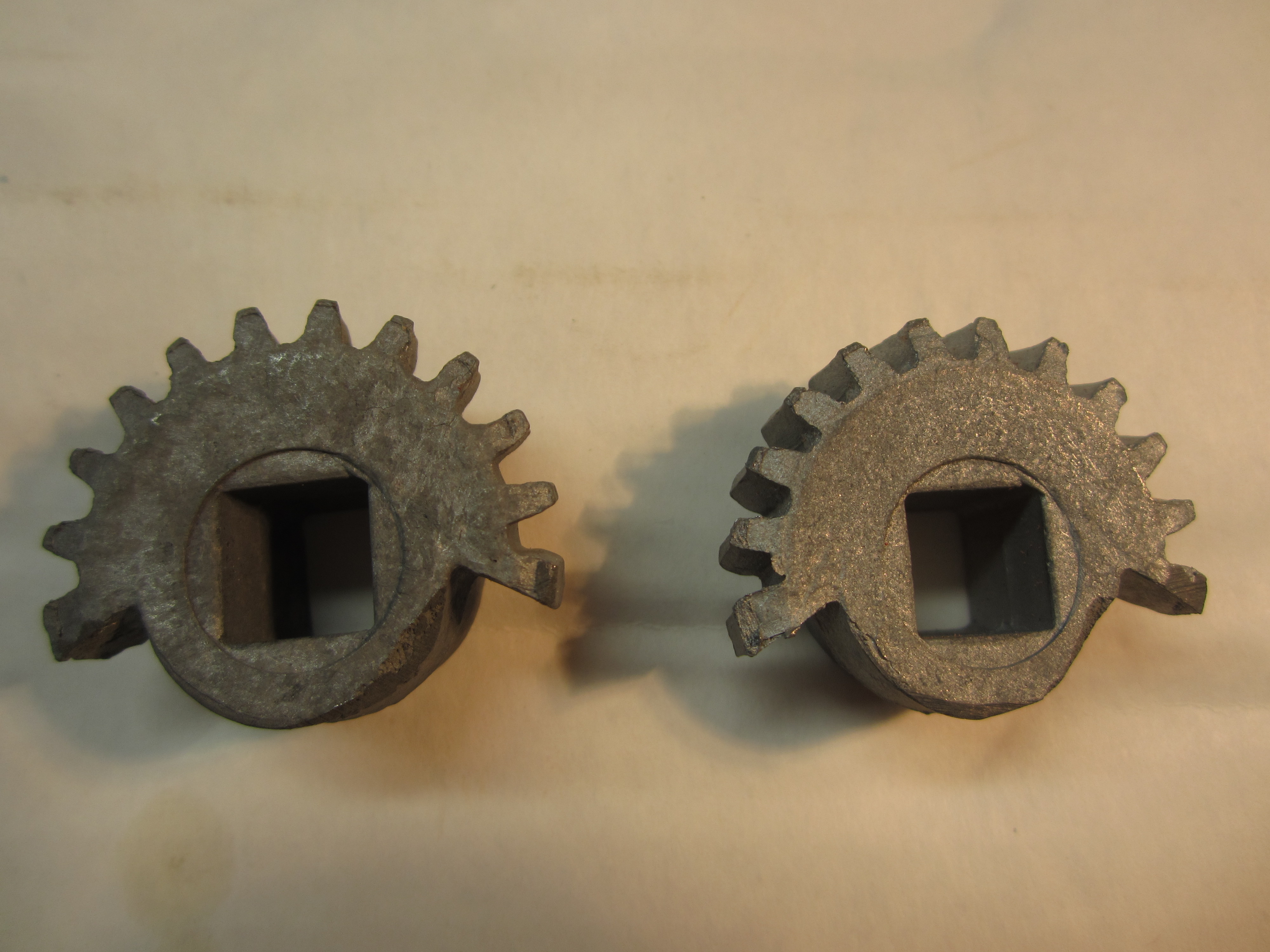

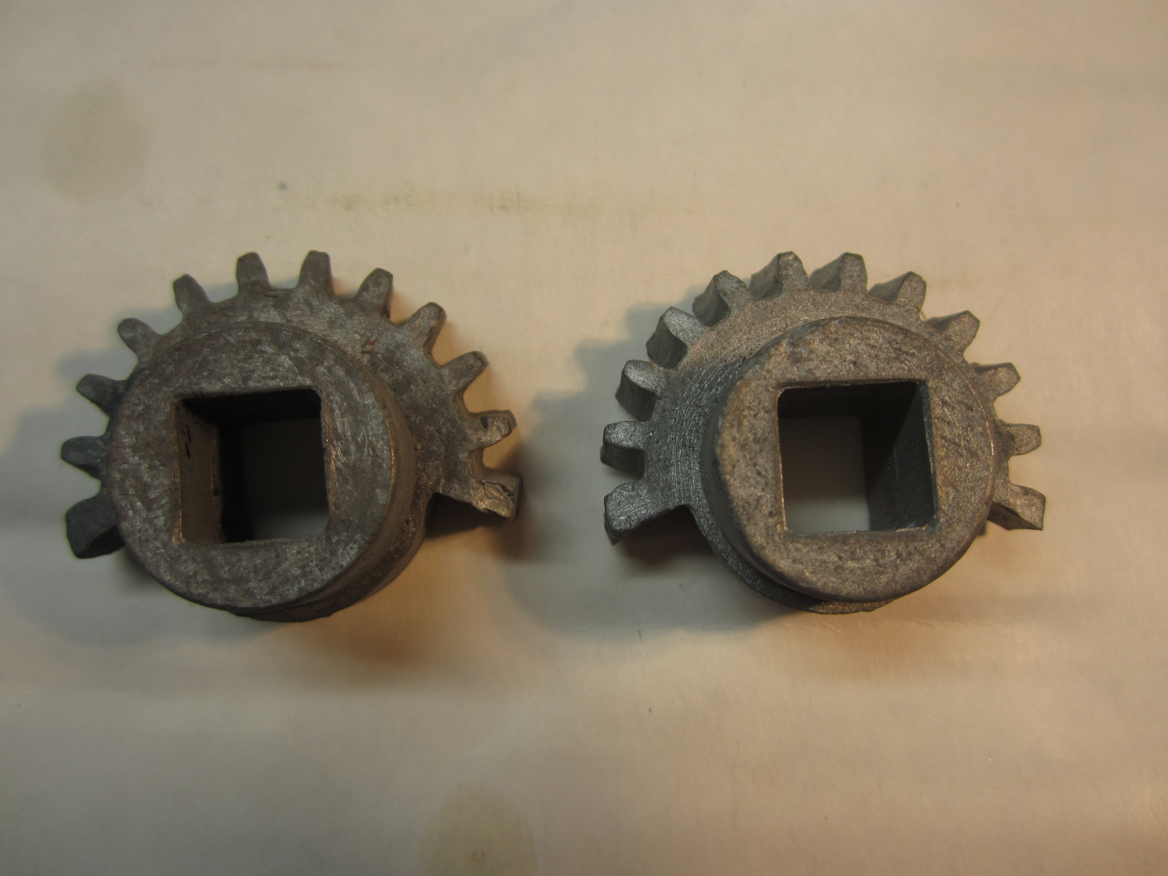

Here's what I found. I don't think they are much good for a pattern. They look to be sand cast, maybe Zamak alloy. They are both the same, don't know if they are left or right.0
John, The issue is that a right hand worm gear is in stock for less then $40. But, a left hand is a custom make. The photo on the right is a left hand. I have a couple of tricks. One being taking a right hand(RH) and cutting each gear on an angle to make it a flat on center. It appears that the teeth are 10 degrees in the wrong angle. Now, the worm only needs to turn about 7-8 teeth back and forth. I may be able to get away with it. The gear in question, a Martin 1620 or Boston Gear G1042 are bronze, and hopefully strong enough to withstand some removal of material. Hudsons use the same gear in both sides. Of course, these gears have 20 teeth 360 around 10 of them must be removed to turn from stop to stop. Then the center shaft is square on the assembly as seen in your photos. However, the gears from Martin/Boston Gear are round so a 3/8" square must be drilled/honed to accept the Hudson shaft. PITA. Got Greggs potmetal gears today. I had to file the square hole to get them to fit over the shaft. Good Grief!0
