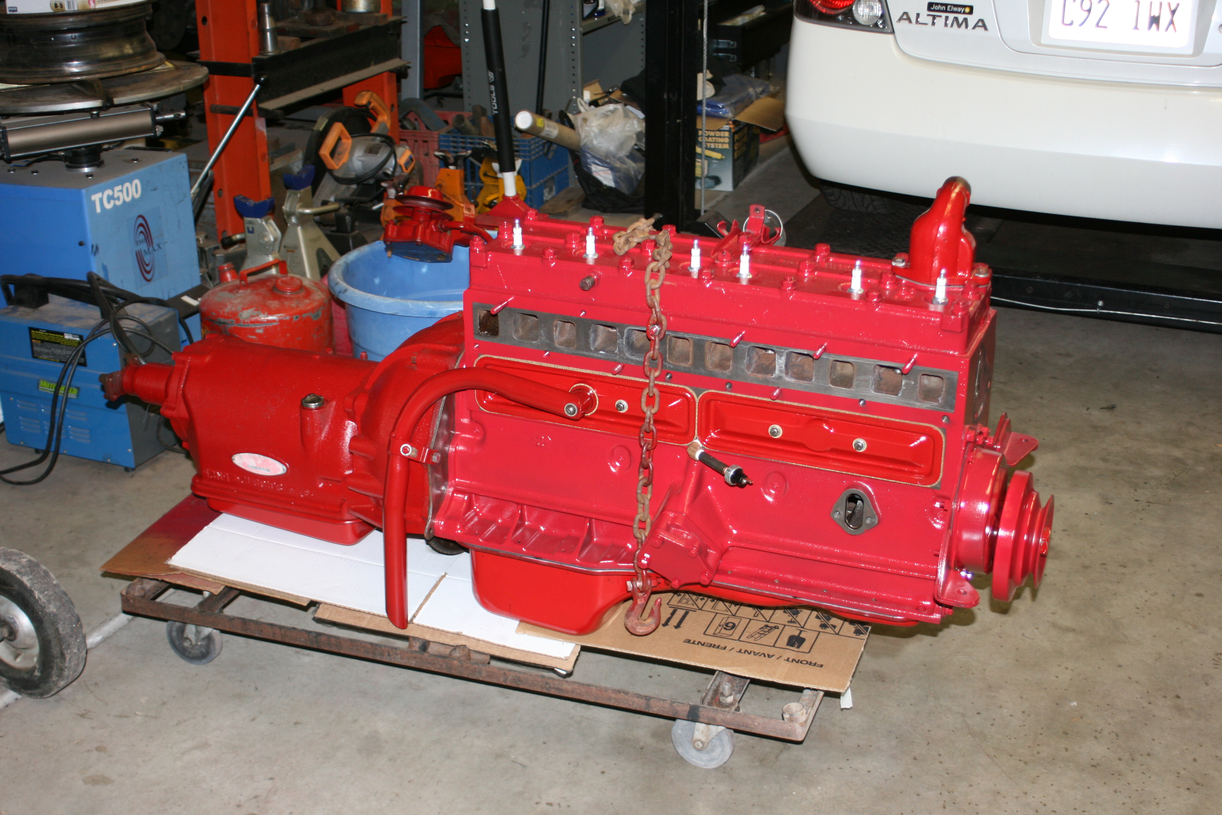

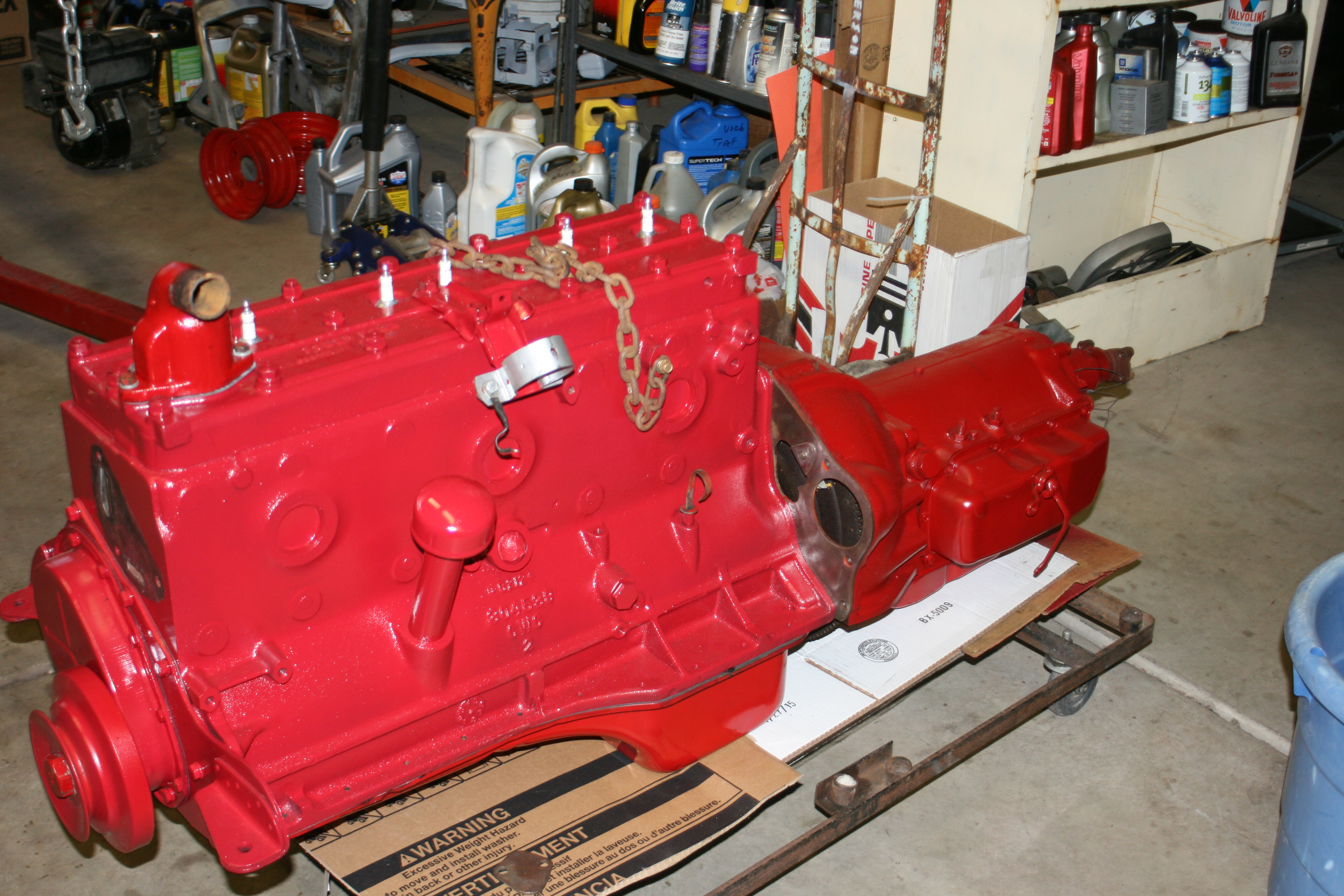

I am doing a 308 for my 54 that has a number of improvements as mentioned by Ken. I think the only thing he did not mention is my 372/254 cam. If you go bigger with cam and valves, you have to have the Twin H. Ken has been very helpful with my engine build in helping me solve some problems that I did not understand. I am now up and running and doing some road tests...0
