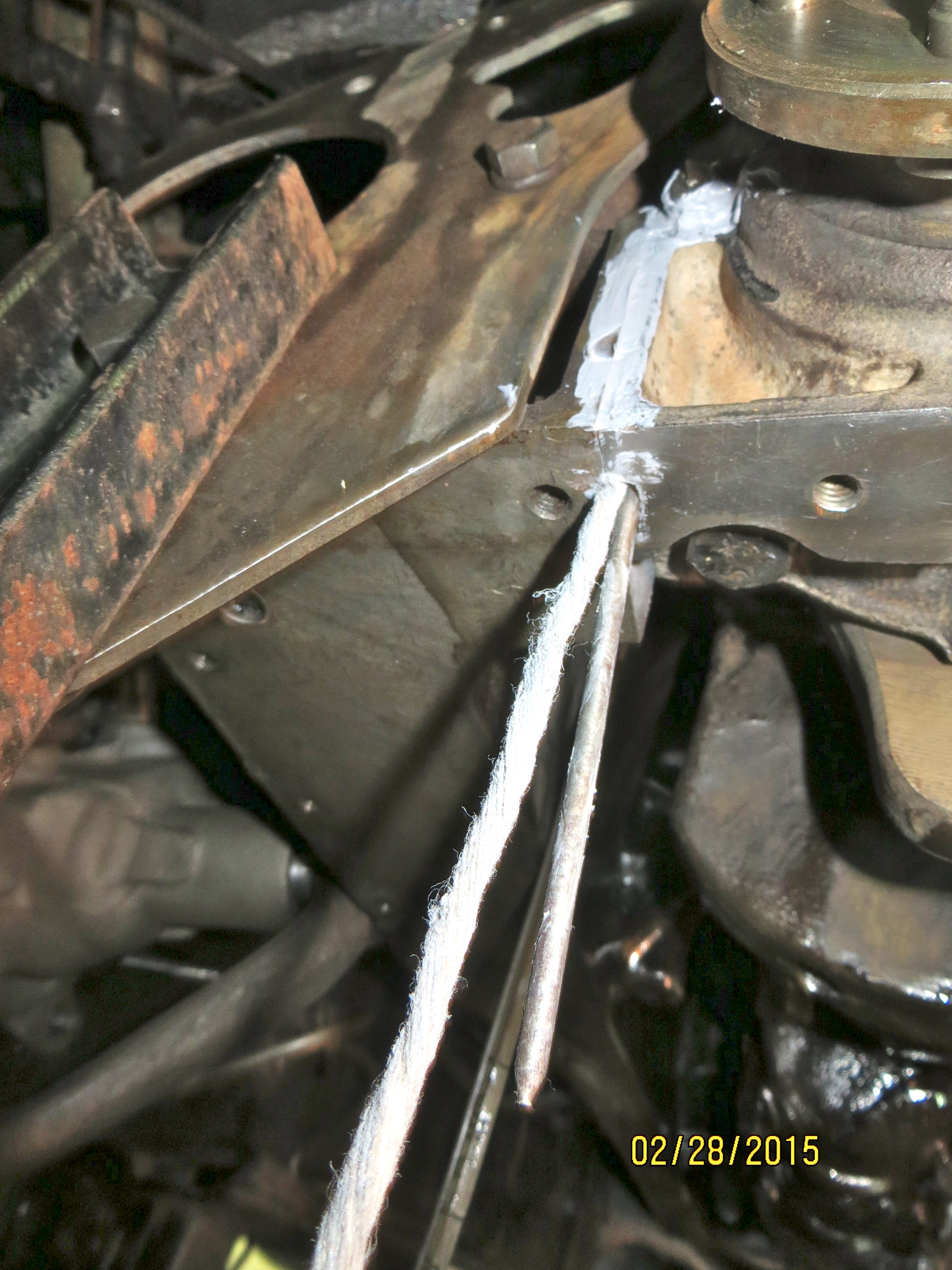

im sure you will figure a method...Cherry picker would work but perhaps put long bolts in back of motor plate then chain to each side, or bolts in crank then chain across to each frame rail to hold. Be sure to use Dap Permatex black RTV in corners of seal and maybe rotate Seal slightly so gaps not near corners of cap

I'm with Ken.......replacing a main seal "on the bench" during assembly isn't a tough job, but you only want to do it once and do it when it's easy. It's a costly, time consuming pain in the rear (main, that is) to change it after the fact. I've used the old rope/woven style since I was a kid, with no issues. The one used in the splashers is the easiest.

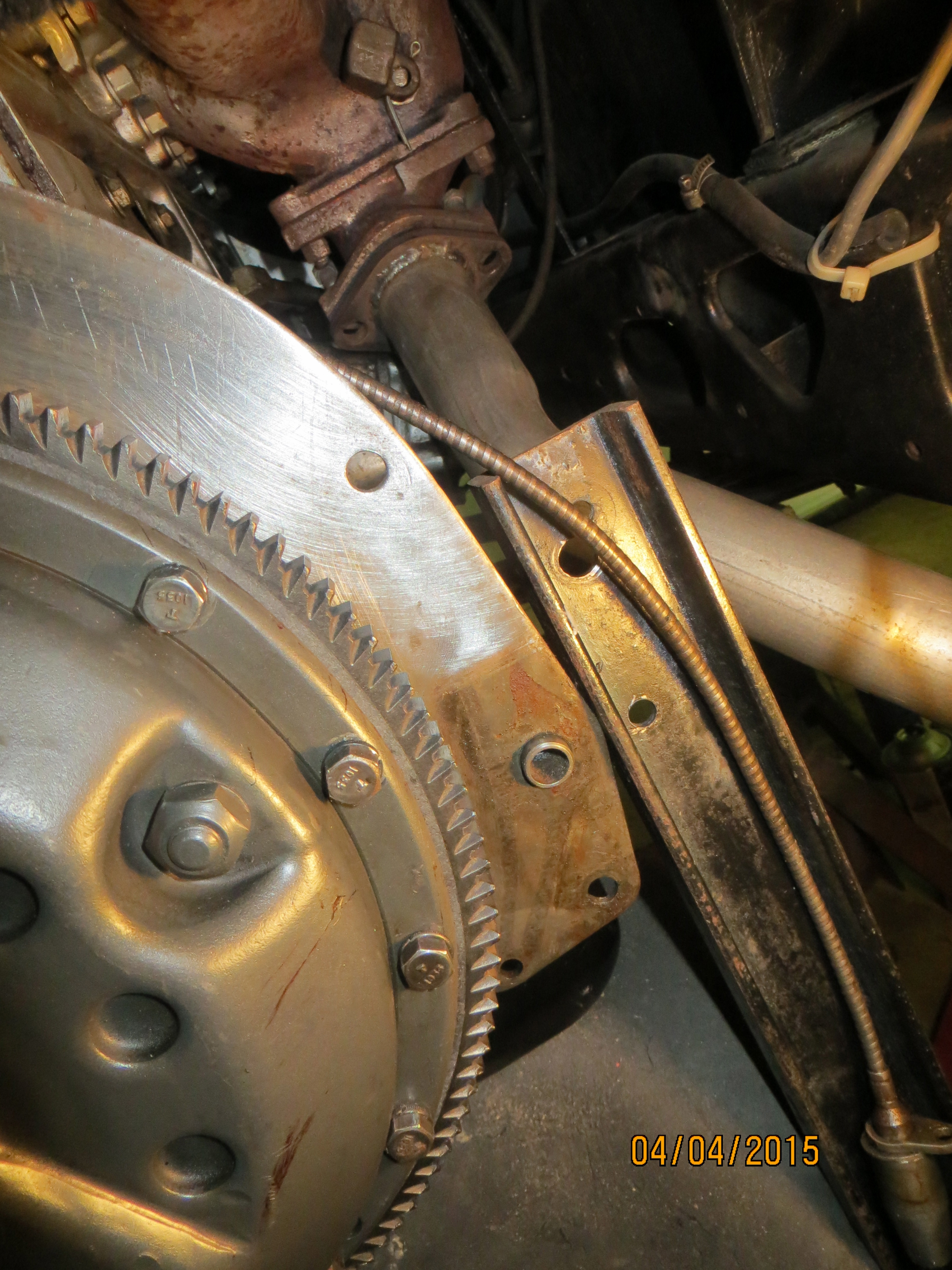

Ken, I had a leak on my latest 56-308 engine and it looked like it was the upper part of the lip type seal but, after cleaning the backing plate very good it was not the seal.
The upper long mounting flywheel bolt that threads into the back of the block and protrudes in the rear valve train was leaking oil down the threads and between the rear spacer plate.
I removed the bolt and put lots of black RTV on the threads and no more oil leak. ( I knew this could be a leak problem when I assembled it but over looked anyway) Rudy B.
