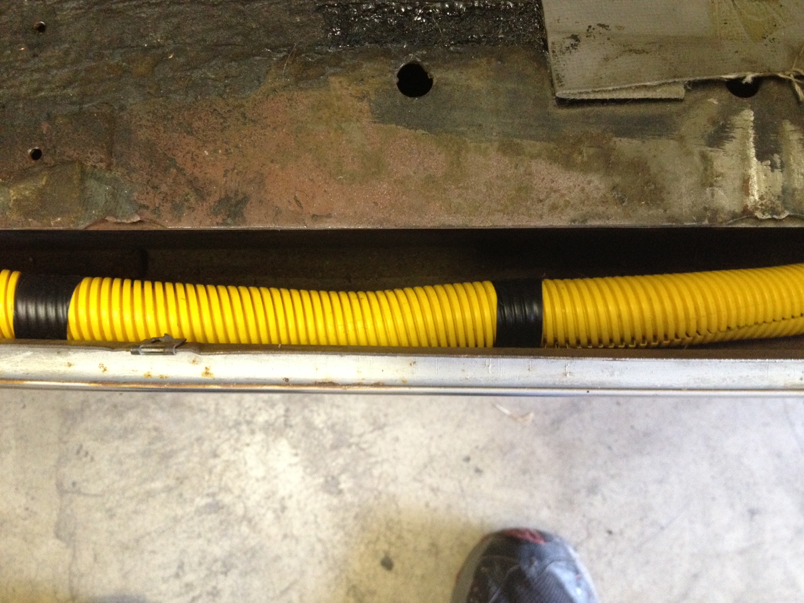

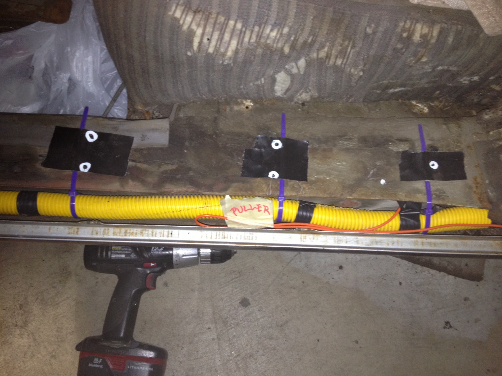

Thanks Ken. I will probably go the under the carpet route and just splice a line into the dome light wire where it starts into the headliner.0
I wrapped it all up and ran it through the driver's kickpanel and under the door sills in the rocker area. Came back in at the furthest inside corner of the left rear door sill, up the wheel well and into the trunk.0
That's a good job. It will be fine there as even the pre-made wiring harnesses reside in that area.0

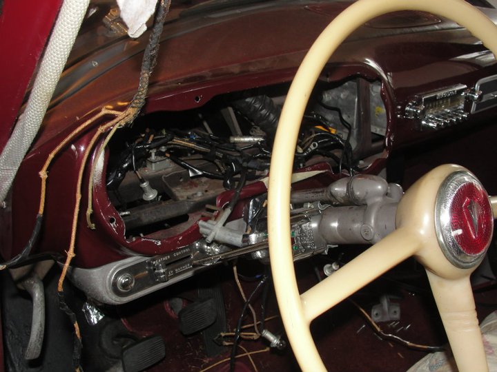

I put a new harness on my Pacemaker a while back. On the tail lights, I really didn't want to undo the headliner either. I used an electrician trick I had learned. I taped the new trunk harness to the old one end to end and pulled it through. I know it has to come through a couple clips but was able to get it through them. I did have to undo some headliner at the A pillar and back near the rear window. Have to admit it was a long shot but it worked. Picture shows the end of the trunk harness the replacement was connected to. You can see how bad the wiring was before it was all replaced with the YNZ harness! Doug

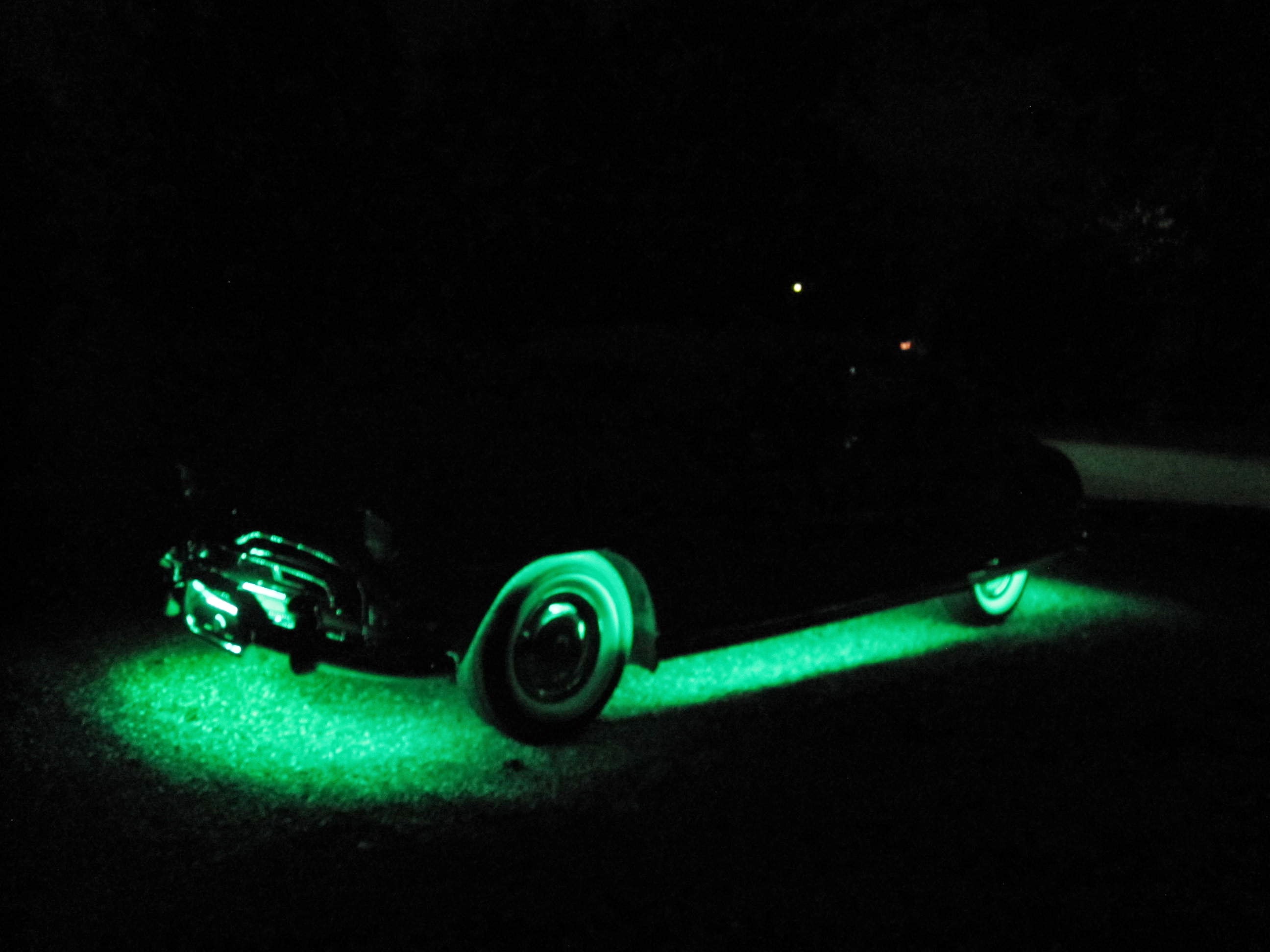

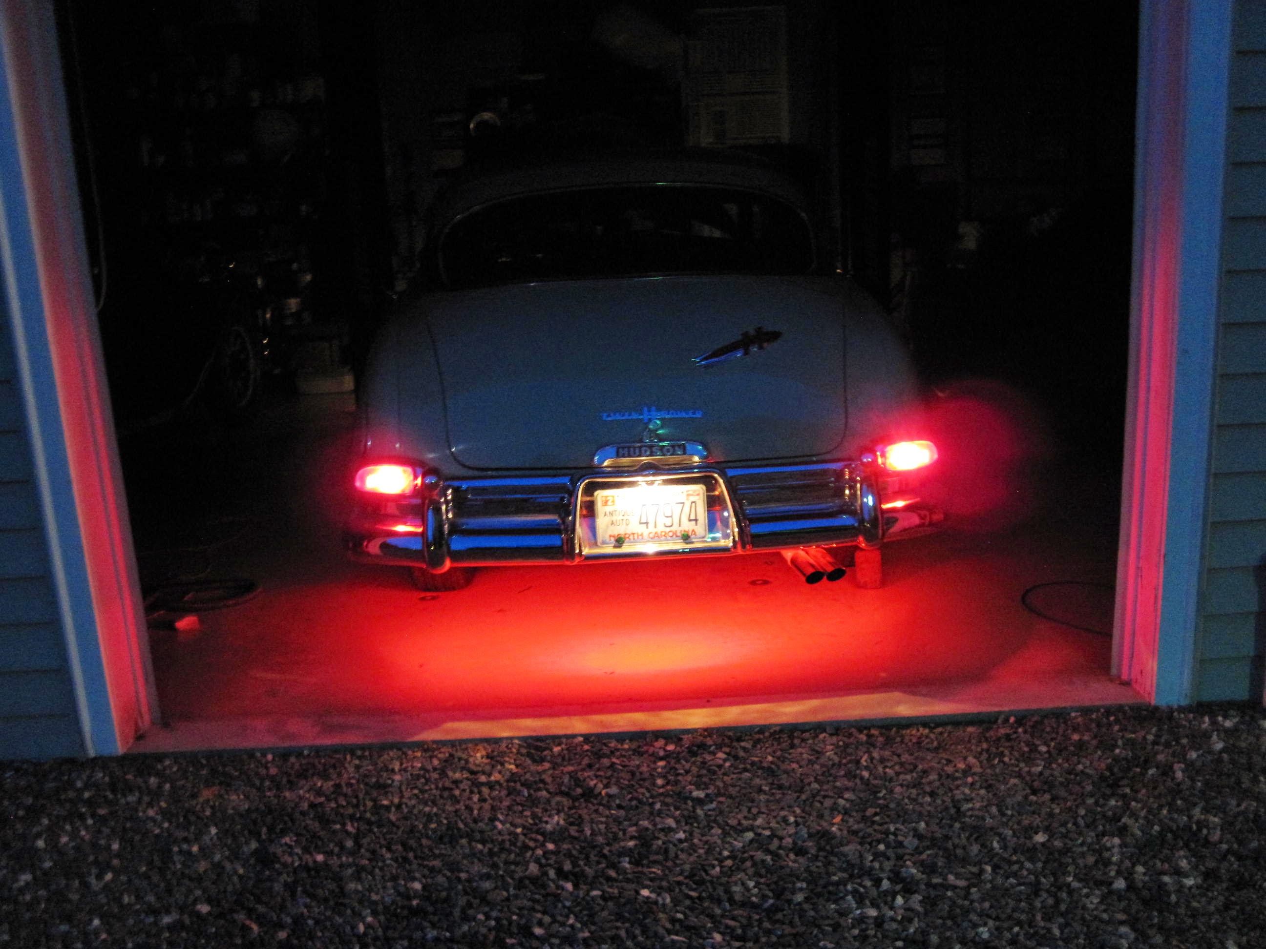

Have Y&Z but when I installed backup lites, I ran the wire(two-one extra) along the inside of the sill. Easy. Gorilla tape !!. Tape and adhesives are very good now days. I also have 1000+ LED lights around 360 degrees on the bottom of the car, that you probably wouldn't notice off with the car on a lift. Lites are 1/2" apart embedded in plastic with 3M adhesive factory applied on back. Also used strongest 3M spray adhesive before installing sections and covered with waterproof 3M clear tape. Have 200+ red LEDs on inside of rear bumper {connected to tag light}.
Point is: wire can be installed on bottom of car without fear of dangling, if done correctly ! Of course you don't apply all this over dirt.
Oh, before anyone asks: I did all that because it is illegal to install flame throwers !!
